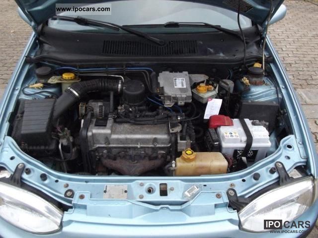

or if you can find a bob from a palio 1.2 8v they are taller and have larger inlet - very rare car in this country and is the only one i am aware of with the larger bob...
you bolt it on the other way on a cinq obviously, maybe unto.pl could source one..?
here is a pic
yeah fiat should be able to sort one out, its not a discontinued part or anything so fiat dealer should be able to supply, my eper is one version old so prices are not bang on but i expect £50 is about right. Bit pricey for a bit of plastic but its a nice clean tidy solution - i don't actually know how big the inlet hole is but its certainly bigger than the 30mm of the 899 bob.
If someone has one, or buys one please post up measurements!!
Now getting on to some old colleagues of mine at the local fiat dealer :)
As predicted its about £50 plus vat and obv they'd have to order in from Italy
