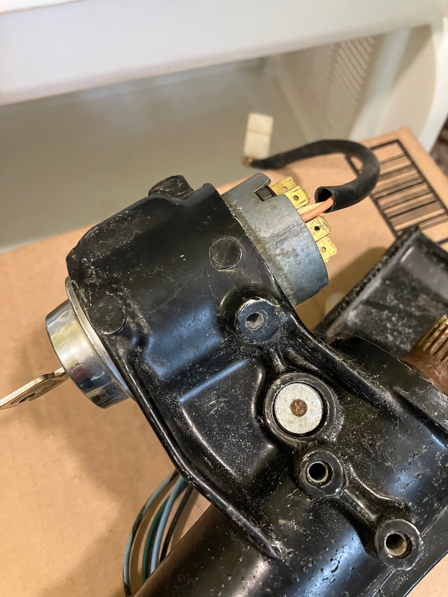

Hello. I recently purchased a 1972 850 Spider. The sport needs plenty of work. First item is replacement of ignition switch. How do I get the replacement switch (key & cylinder) out of the column? I read someplace there is a 3mm pin that needs to be pushed out, but I can't find it. What is the deep bolt and how does that work to detach the key switch from the column? I don't want to swap columns, just the key & switch cylinder. Pictures are from the replacement column I found in the spare parts box the seller gave me.

Others may give more exact advise, but looking at the pics the switch is similar to the old Lada 1200s etc. There is a spring loaded pin that if pushed and the key is in the right position will allow release of the whole barrel assembly, it does need the key to do that though.
So if you push a small screwdriver or similar in the hole at the same time as turning the key you should find a release position where the screwdriver or drill bit etc . pushes in a bit further and the barrel should come free.
I am guessing it is the hole on the third pic.

Thank you. Yes, turning the key was the trick and the key cylinder slide out! Thx!
