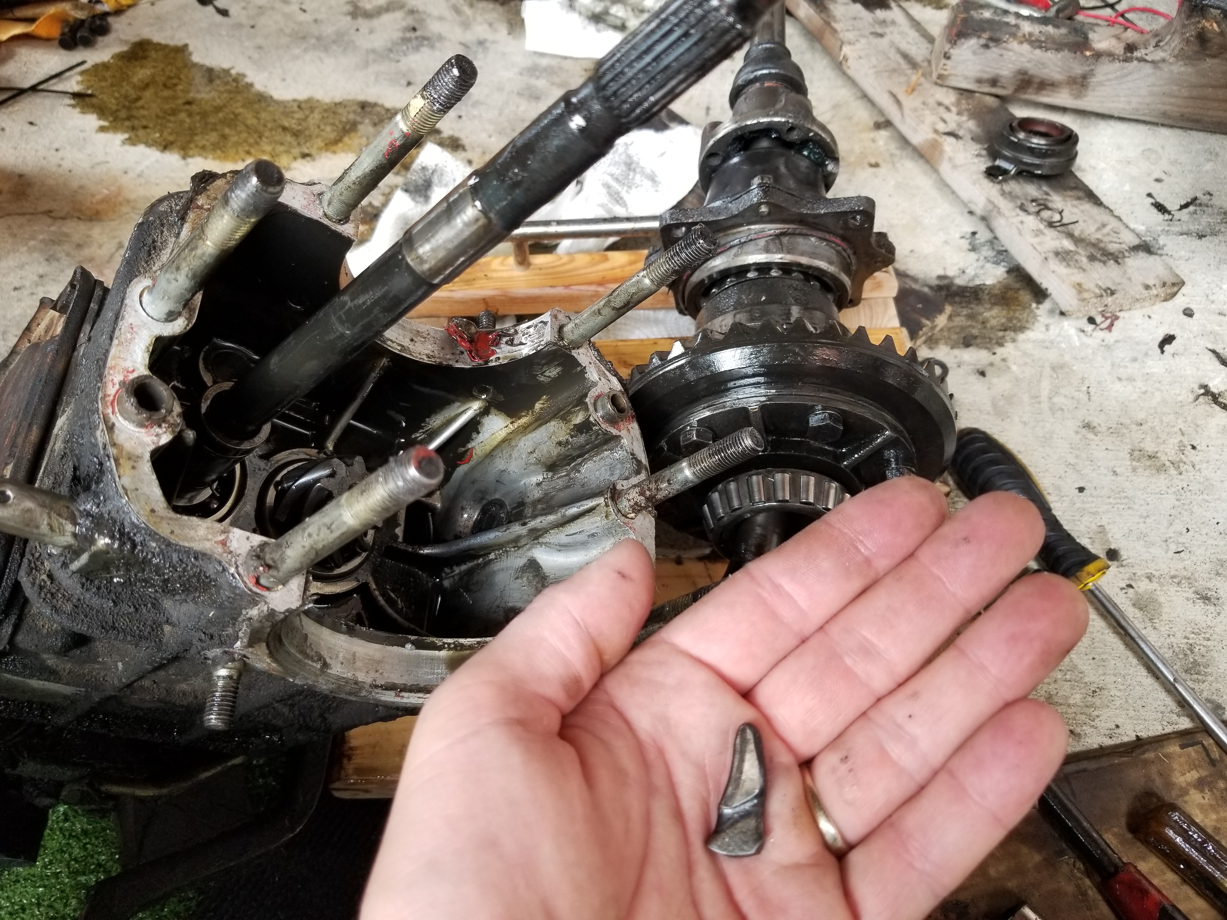

This picture shows what was swapped from one trans to the other. Nothing else was swapped. After reading in the Haynes manual, I believe you're right- the retaining ring on one side was removed and then surely tightened on replacement at more than the spec provided.

The pinion on the gearbox main shaft is matched to the crown wheel in the factory and should not be mixed up so you need to used the correct set as well as setting up the backlash.

The pinion gear is part of the main shaft so you cannot just replace the gear. If you change the whole main shaft it may upset the shimming on the shaft further affecting the backlash. Easier to swop over the crownwheel on the diff housing, six bolts, then you just have the backlash setting via the diff bearing housings to contend with.
Well it's a good thing I didn't try to just do that outer tension ring adjustment and hope the ring gear and pinion would be fine... found this.

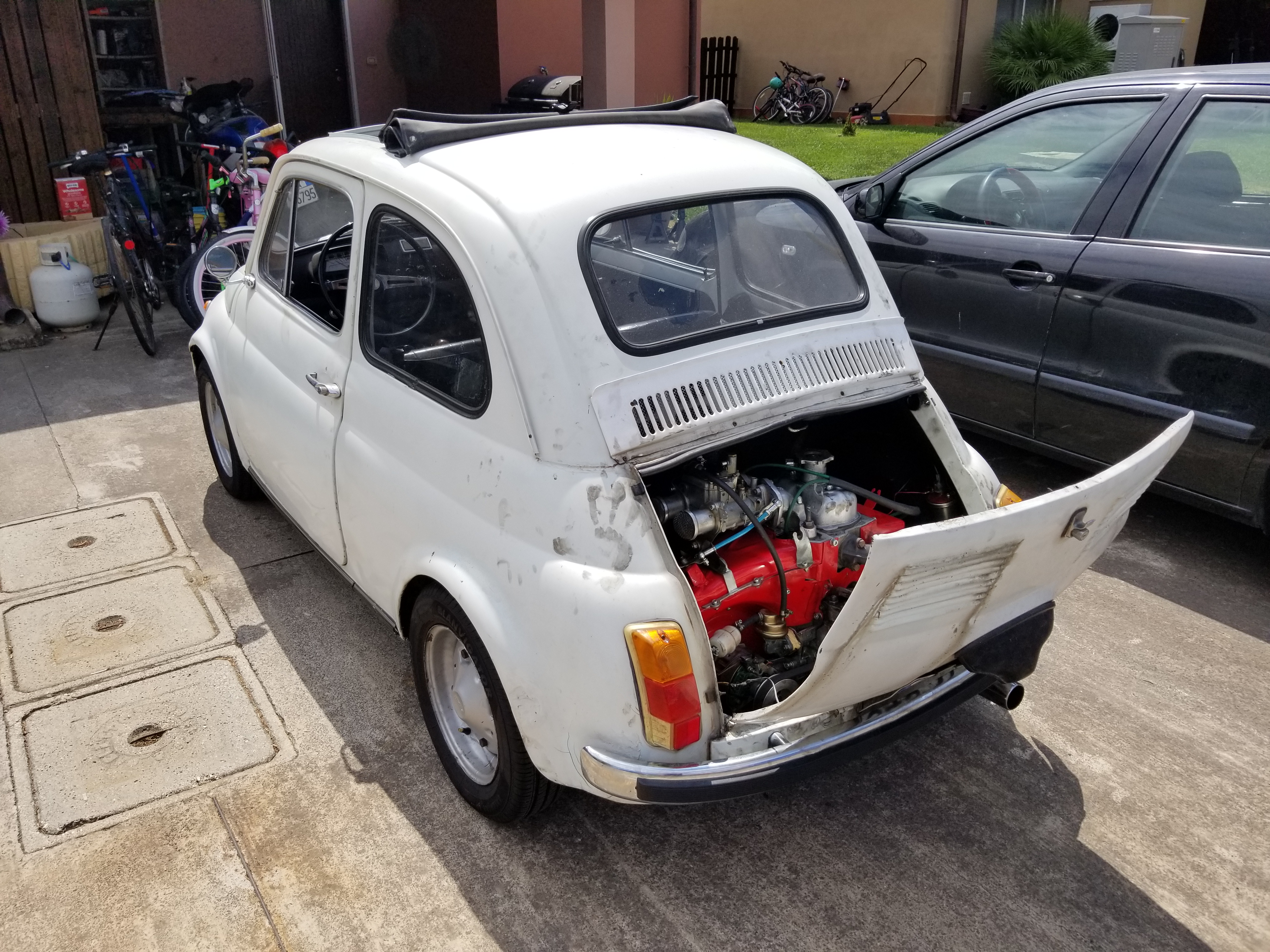

THANK YOU to everyone, she drives again! Needs a degreaser bath, but she drives smooth and with a LOT more power! I'm working on a YouTube video showing some of this project, I will share a link when it's done. Again, thank you all!
