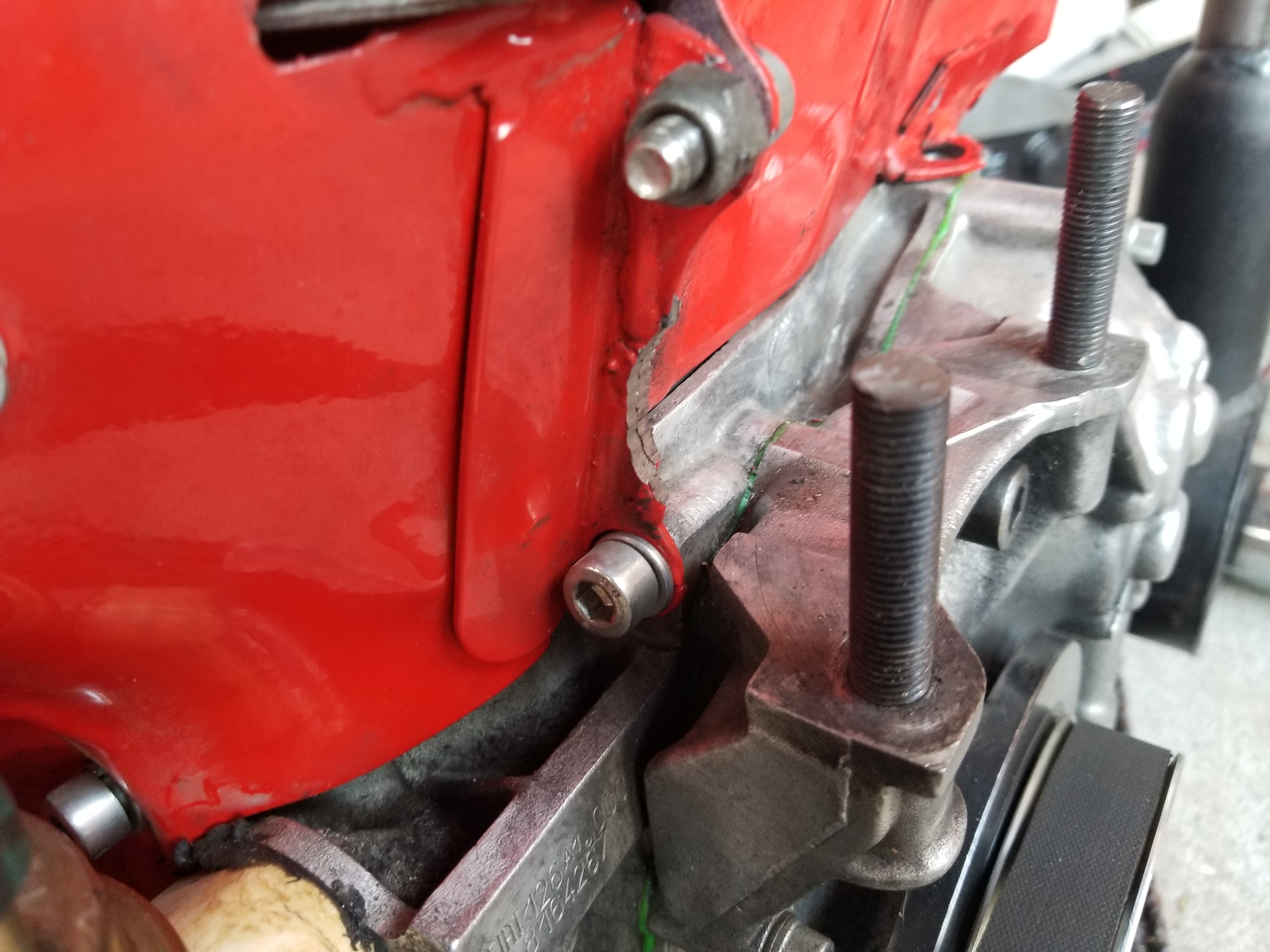

Ian, here you go. Just let me know, anyone, if you'd like another specific picture. The last pic- I'm not yet sure what the notch is for, but I'm sure I'll figure out during the install.

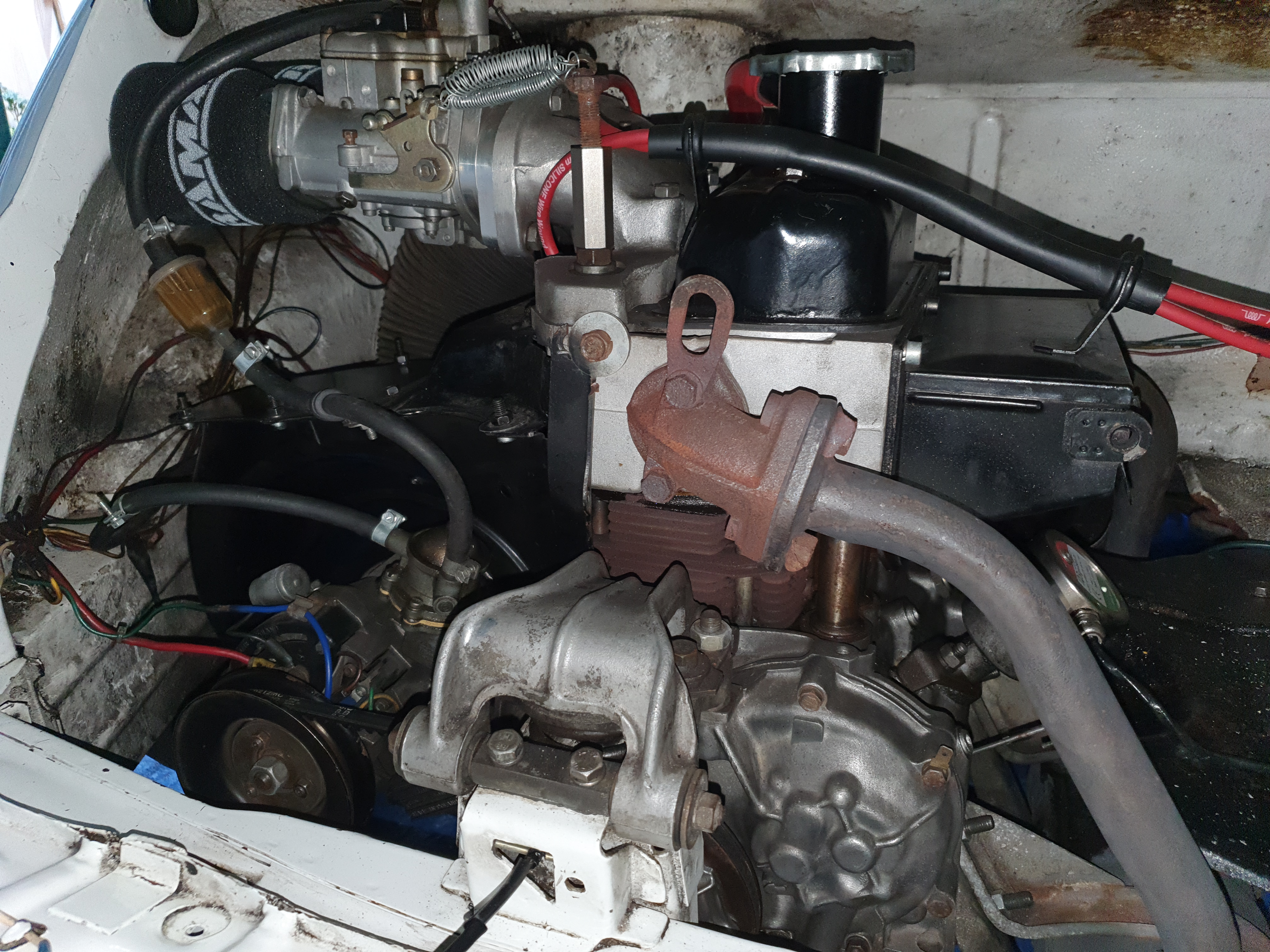

Attached a picture of my little power plant. It is in no way as shiny or nice as your 700cc :)
It complements nicely with the rest of the car; no work of perfection but it runs well and is a lot of fun (y)

Andrew, the cut out in the tinware join is probably for clearance of the rear engine mount it looks like the wriggle room needed to fit the spring and the mount onto the engine studs is tight - you will find out anyway. Thanks for the pics too.

I agree with Ian---it is to give you a bit more 'wriggle room' for fitting the rear engine mount. May I also suggest that you check that the fuel line up from the fuel-pump is of the correct type and that you fit a proper fuel-pipe clip/clamp on it---might be worthwhile replacing the jubilee clip on the 'in' pipe with a proper fuel-clip/clamp.

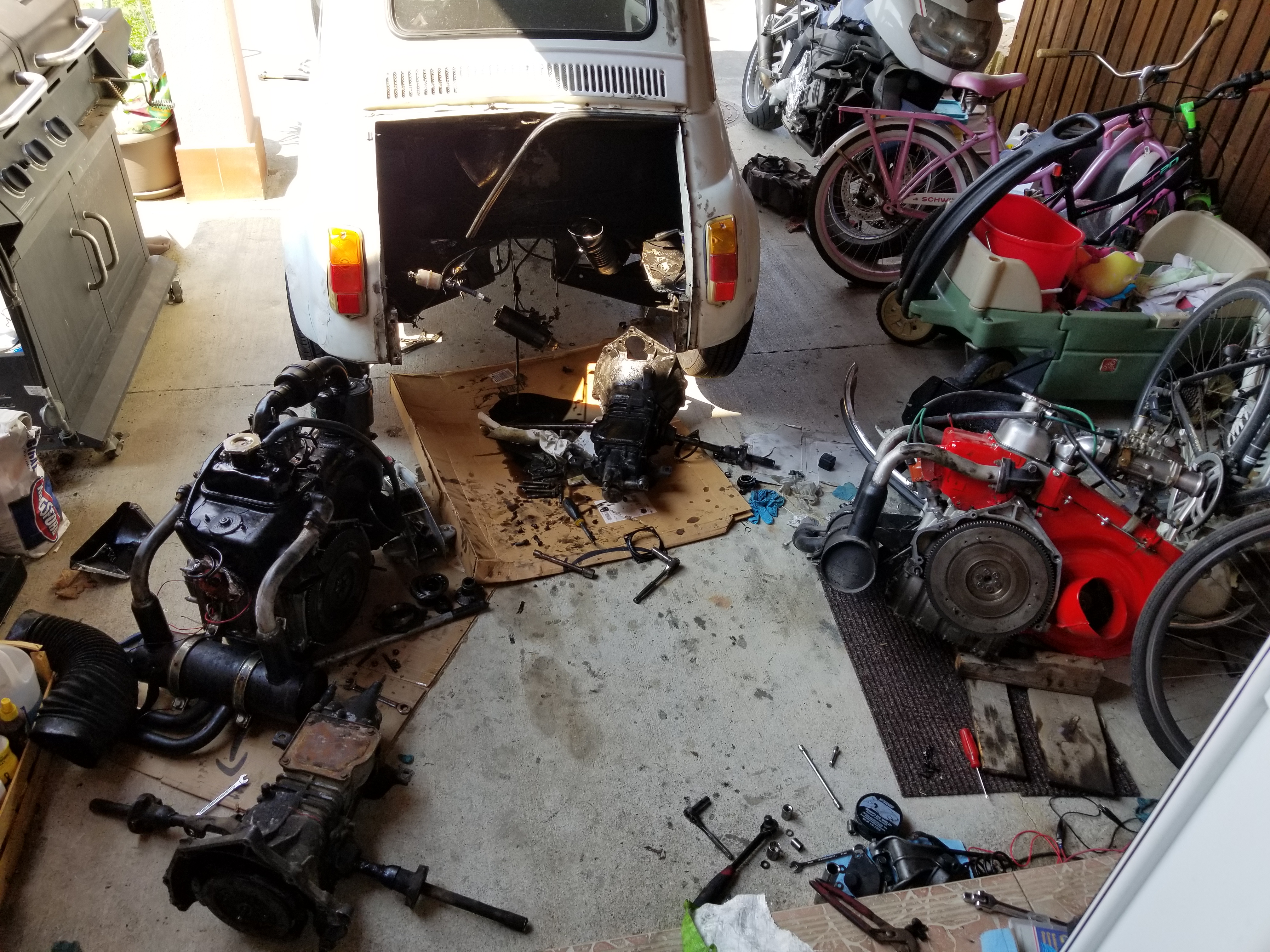

Took about 35 minutes to pull the engine yesterday with help from my neighbor. That's when I realized this was going to be a lot more work than I thought. I had totally forgotten that although my gearbox is *internally* a 126 gearbox, it is in a 500 case... and therefore does not mate to the new engine. Luckily, when I previously purchased the 126A1 engine I planned to build up, I also decided to buy it's matching transmission just to have a spare. Stopped for the day yesterday after removing the shafts from the trans I was using, resuming soon today at installing them to the 126 trans and hopefully smooth sailing for reassembly.
Had a number of dilemmas, the last of which is something wrong with the gearbox. When I run the engine in neutral, all is well. If I put it in gear, any gear, it makes loud gear noise and has a substantial amount of resistance, it will stall the engine without some throttle applied even though the wheels are lifted off the ground and spin freely by hand in neutral. I can't continue on it today, and any insight would be much appreciated. I've posted a video of it to my YouTube channel, here is the link:
[ame]https://youtu.be/LinSDBFNm8Q[/ame]
To clarify- it does not have resistance to the idle or make any noise while the clutch is pressed.
Diff bearings too tight?
