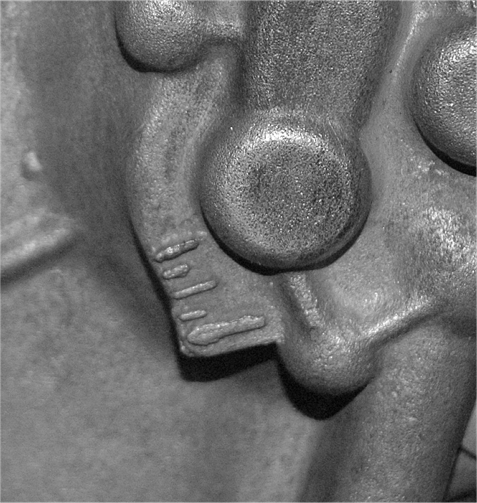

One thing I'm not sure of is what cam is fitted. I found some markings on the cam, but as I've no idea who originally machined it, I don't think I'm going to work out what they mean. I'll take it, along with the other parts, to the engineering firm to see if they can work out what it is. I'm hoping it's something like a 43/73 or a 40/80.

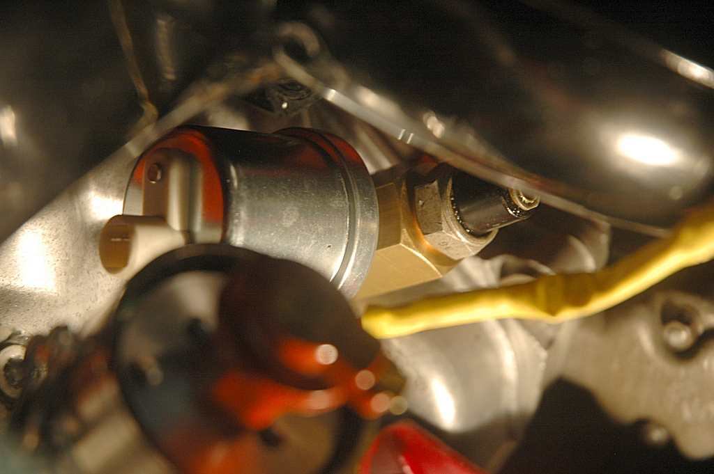

Interesting project and I hope that you get the car to fit the engine. I have not seen a crankcase with that boss above the oil light switch to take a pressure sender before. I looked to see if I could see the engine number but it looks as if that area has been ground away. The timing chain looks more like a 126 Bis as it has no automatic tensioners like the aircooled engines. Also no locking tab washers on the camshaft sprocket hex screws. Are there countersunk shakeproof washers on those two front main bearing csk screws ?
There are a few odd things about that engine - I must admit, I hadn't looked that closely until now.

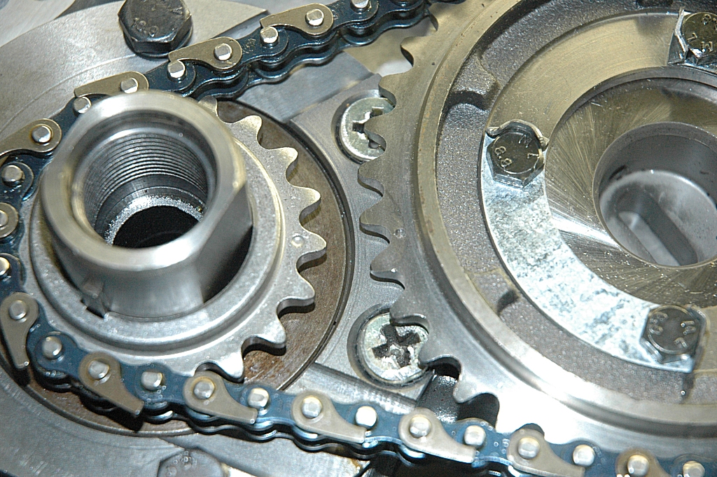

I've posted a couple of photos of mine complete with an installed and tested, but as yet unconnected, oil pressure gauge sensor.
Toshi is correct -
There should be shakeproof washers under the Phillips-head countersunk bolts and hefty spring washers under the hex-head bolts. It's also not a bad idea to loctite the threads as well.
The camshaft sprocket bolts should be secured with lock tabs - as should the flywheel at the other end of the crankshaft and the hollow bolt on the front pulley. From memory, the other places that there are lock tabs are on the big end bearing caps.
The self tensioners can be seen on the timing chain.
Chris
