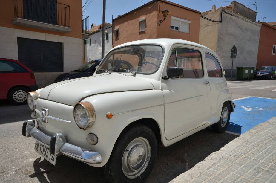

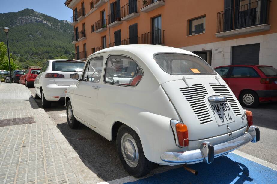

Seat 600 on Mallorca today...just for interest.

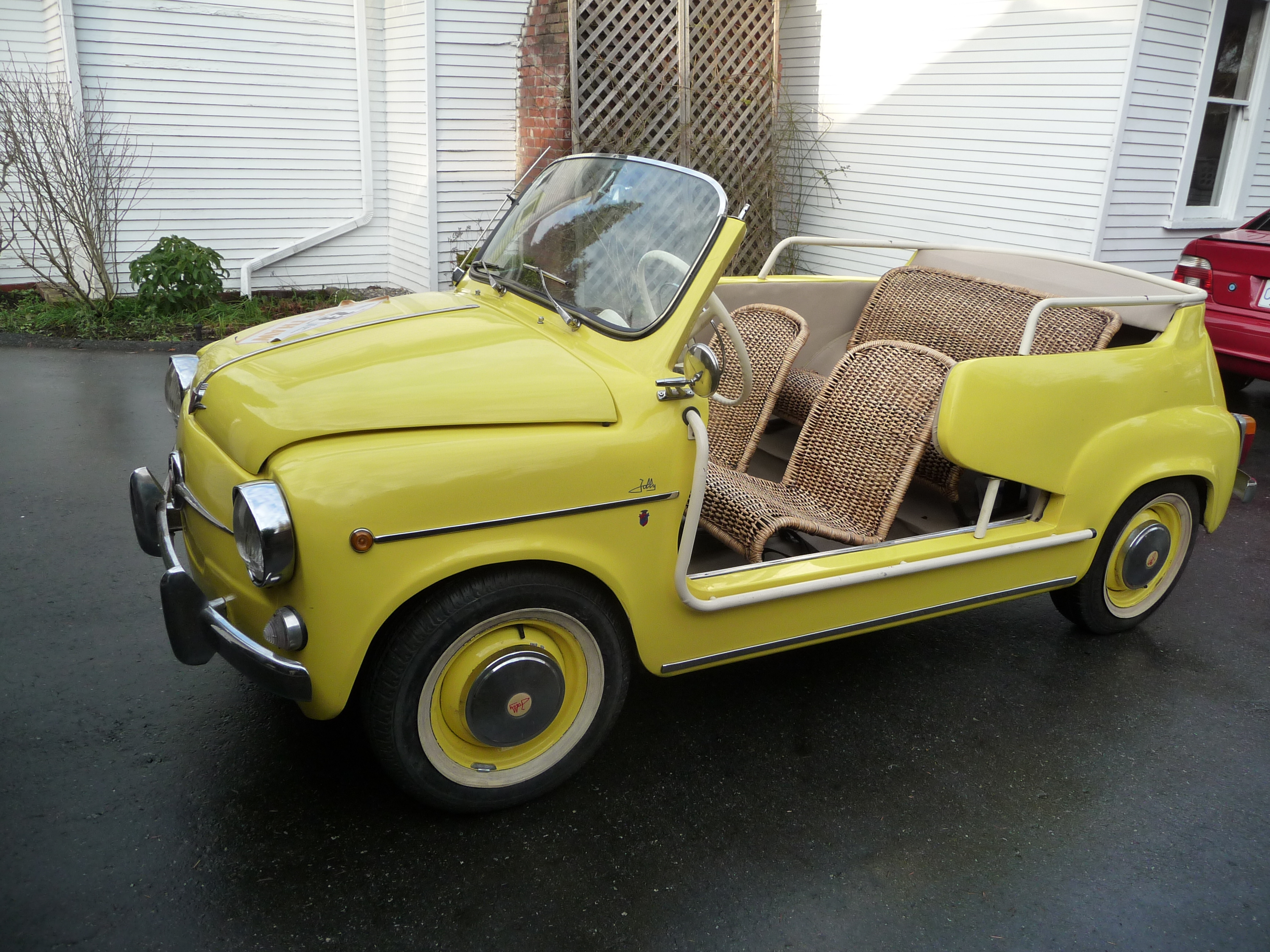

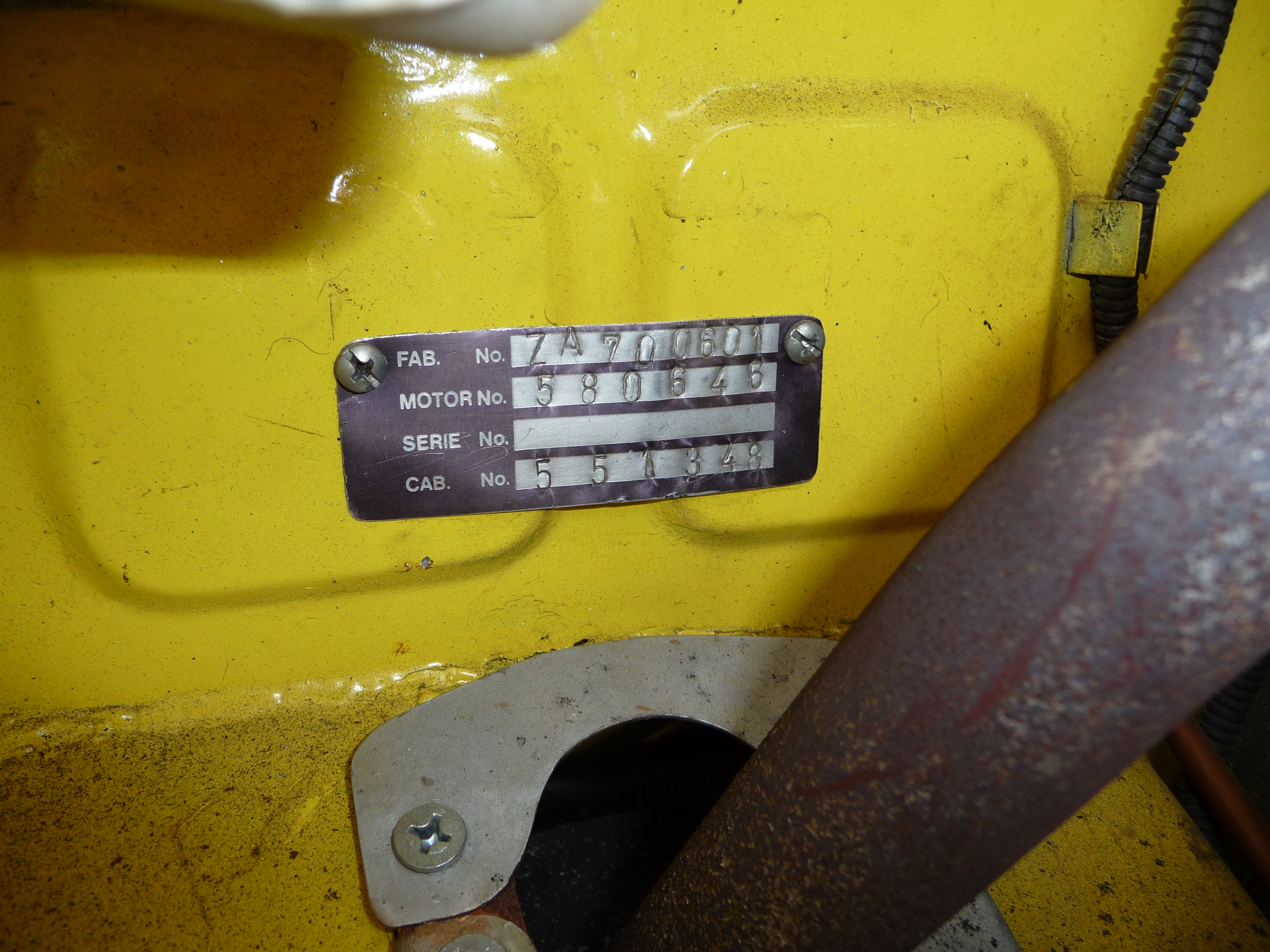

Hi everyone-I am a new member and I joined because I am trying to help a friend who does not 'do' the internet--I hope that is ok?
My friend has bought a 'Jolly' it is in generally good shape, runs and drives well but has a few weird points.
It is badged and registered as a 'Seat' but has all the correct (apparently) parts including 'Jolly' hubcaps and trim.
The vehicle was apparently shipped from Spain to Colombia in the seventies, where it was registered. In 2016 it was shipped to Vancouver by a Colombian who moved here. My friend bought it from him.
We are trying to figure out the year of the chassis. It is registered as a 1967 but we think it is earlier.
The chassis plate is different to others on this site-Can anyone tell us more? Is the chassis number the top row of numbers?

please don't quote me.. what I express is an opinion based on my knowledge....
and Information that can be found by searching online...
Don't think that's a Genuine Ghia Jolly...
there were many copies afterwards that you could say were "Jokers of the Beach" (the translation of jolly "Spiaggina" )
and "Hubcaps maketh not the car..."
It has some points that are different to the Ghia Jollies converted by Carrozzeria Ghia..
Jollys never had the script on the hub caps
the Ghia badges are wrong
The rear side panels were never covered in an fabric or panel
the Side tubing isn't right..
It does not have Jolly bumpers
and there are many features of the Body conversion that are wrong.
The Seat 600 were made in Spain till 1973..
Sorry but not an expert on Seat production
Sorry if my opinion a (and that is all it is an opinion) is not what you wish to hear for your friend
A nice fun car non the less
there is a guy in the USA who has much more detailed knowledge on 600 Jolly's I can try to find his contact details... he will not give much info other than say if he considers it a genuine or fake..
He holds details of almost every 600 Jolly in the world that is known.
Many thanks for your opinion Bigtwin. I would really appreciate it if you could find contact details for the expert in the USA.
This looks to be a period photo of an original Ghia Jolly based on the Fiat 600. Not sure if the Spanish Seat company ever had an agreement with Ghia or Fiat to distribute them under their own badge.
As you can see and as described above, there are quite a few detail differences between this car and your friend's car.
Still trying to find more information.
Chris
Hmm, Thanks for that. My friends car has the holes where the front sidelights were-it was 'updated' in Colombia apparently. The trim on top of the windshield was added in the past two weeks to conceal the fact that the windshield is not laminated... The front grill is different but were there differences between various years?
The Seat badging is also a big question mark of course.
I have sent an email to Steve Pantieri who is apparently the wiz on these.
