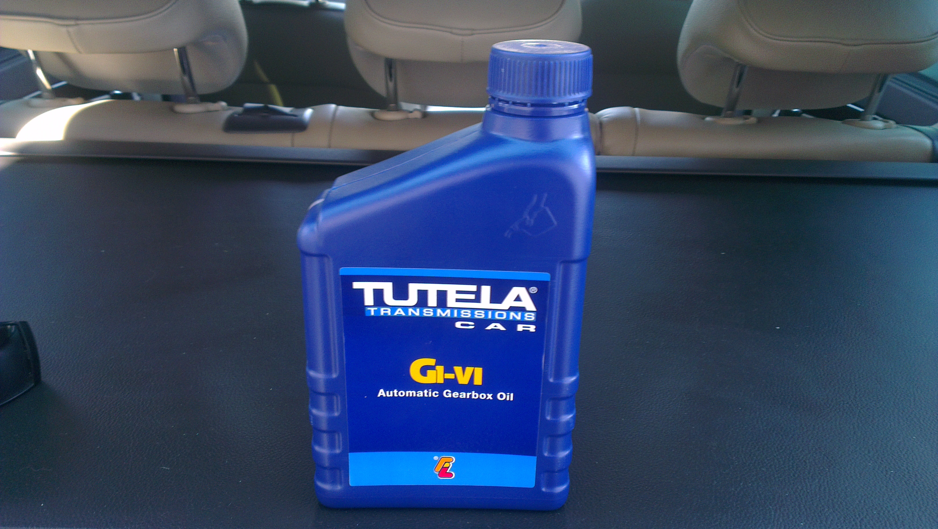

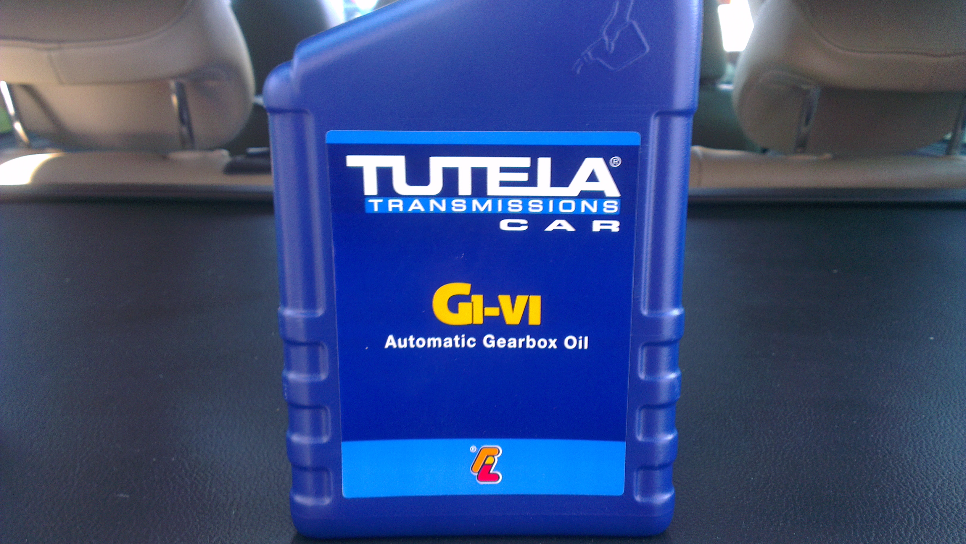

Drain screw somewhere on the side if i remember correctly and selenia GI V or something like that is the fluid (green color same as the PS fluid) GM also has it (look in my changing the PS fluid DIY post there is a picture and part number for both Fiat and GM).
There are a couple of threads on here about changing the ATF, do a search or have a look at my posts. Fiat do sell the correct fluid, it is Tutela GI-VI and I've changed mine twice - no problem getting hold of it. The drain plug incorporates a level tube and is (amazingly enough) at the bottom of the gearbox - you can't miss it with the undertray removed.
Just to let you other 1.9/2.4 m/jet auto owners know that the Fiat recommeded oil for the AWTF-80SC 6 speed auto, which is Tutela G1/V1 is the same as Vauxhalls p/number 93165147, but Vauxhalls is £9.48 per litre and Fiats is £13 per litre. Vauxhall call the box the AF40-6. In fact I am told the oil is actually Mobil ATF 3309, usually lableled as car manufactures own brand, ie Tutela/Volvo/Ford/Vauxhall/Land Rover/Saab etc who all use the same auto gearbox.
