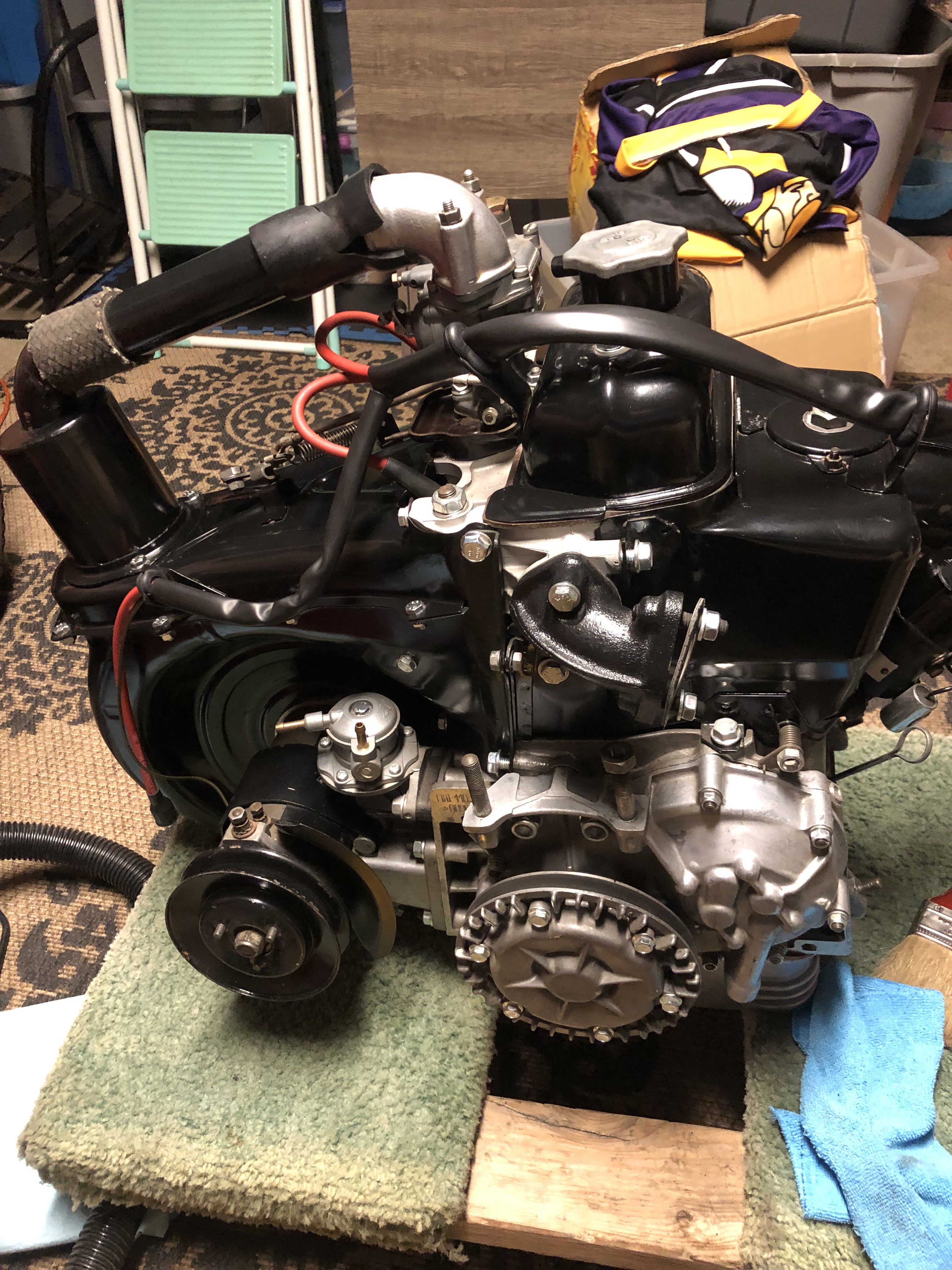

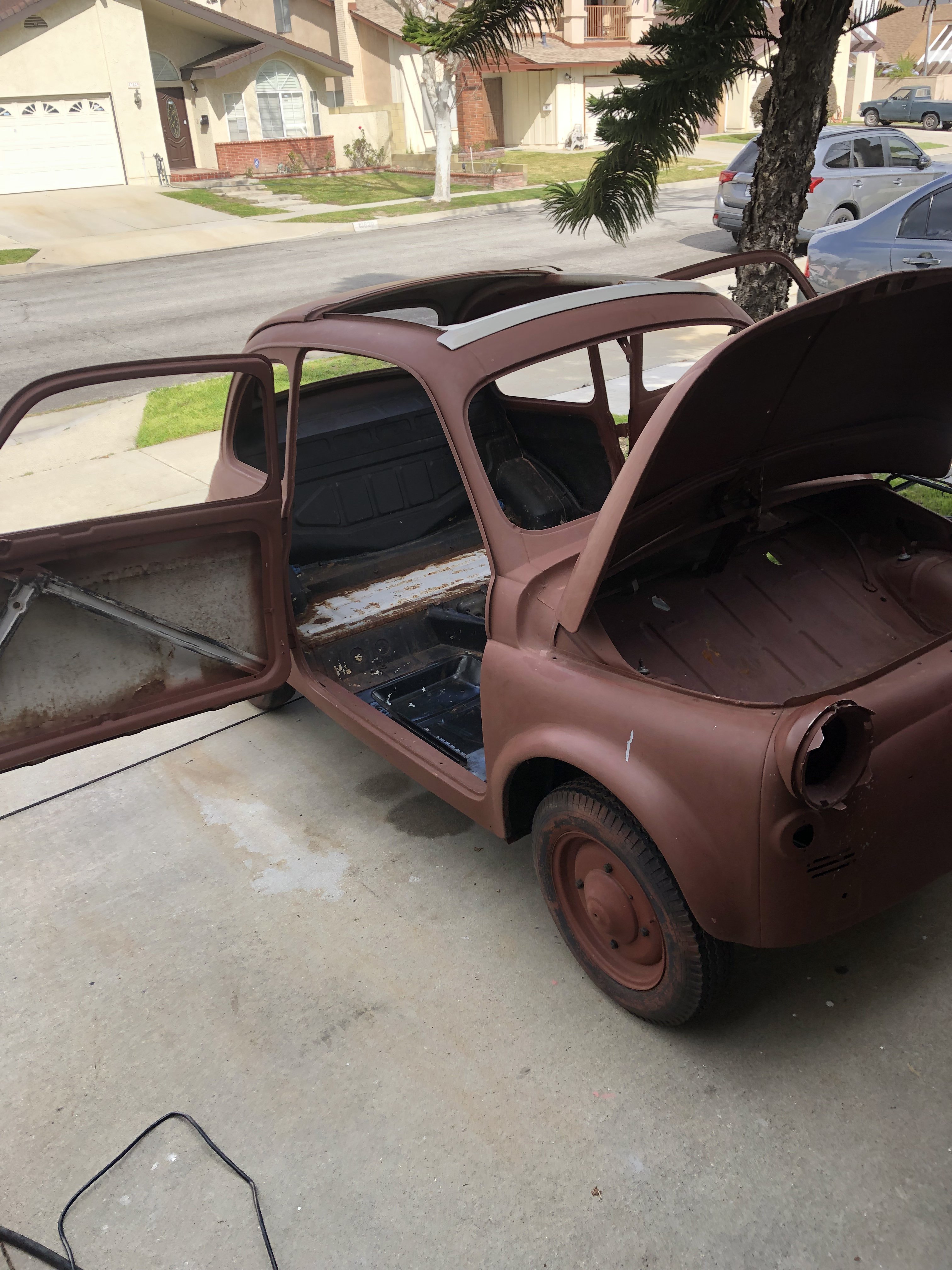

Hello, just picked my 59 up, have engine rebuilt, many parts but may need more, is Mr Fiat the best? Anything in USA? Going to be posting my progress as I restore. I’m going to sell once complete. Thanks for viewing.
