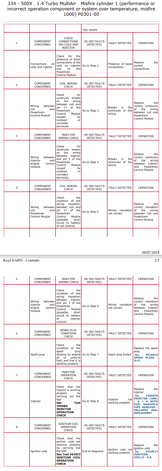

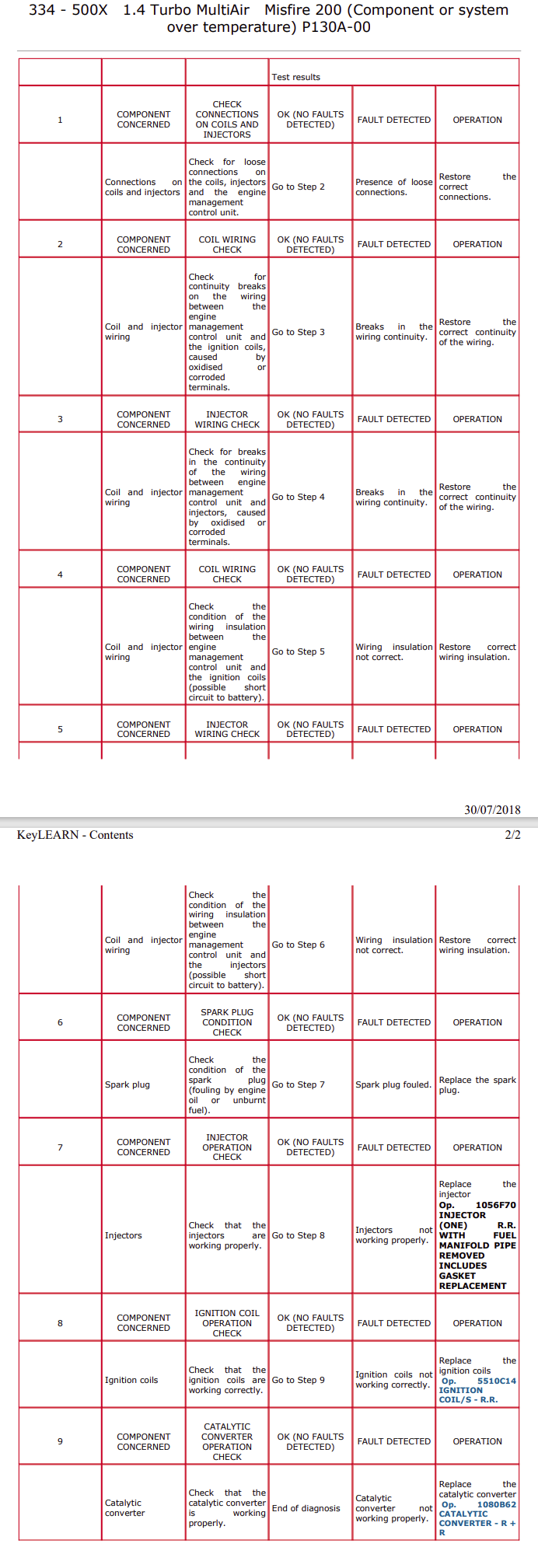

hoping someone can point me in the right direction with a problem my mums 500x 1.4 turbo multiair automatic is having.
so Issues
check engine, and drive mode unavailable appear on dash, car loses power, starts misfiring and juddering until it comes to a standstill. Turn ignition off and back on again and it drives fine again. Engine management light stay of for a while but they goes away. Until the car does it again. It’s pretty frequent now. The cars probably done 50 miles since it started doing it.
faults in the computer are
p0301-00 cylinder 1 misfire
p0304-00 cylinder 4 misfire
p0300-00 random misfire
p130a-00 misfire 200
its also previosly had b106d-86 drive mode system signal invalid and various other ones like this.
long story short, Fiat main dealer advised, new battery, new outside temperature sensor, new plugs, new coils, oil and filter change and the multiair filter replaced. All of which has been carried out but has made no difference whatsoever.
ive read lots about the multiair unit issues and was wondering if this is what it sounds like to any of you guys? do they fail and then work fine again and then fail again. I’m reluctant to keep just throwing bits at it. Fiat were talking about poss injectors. Poss cam timing etc.
any advise much appreciated
cheers Olly
