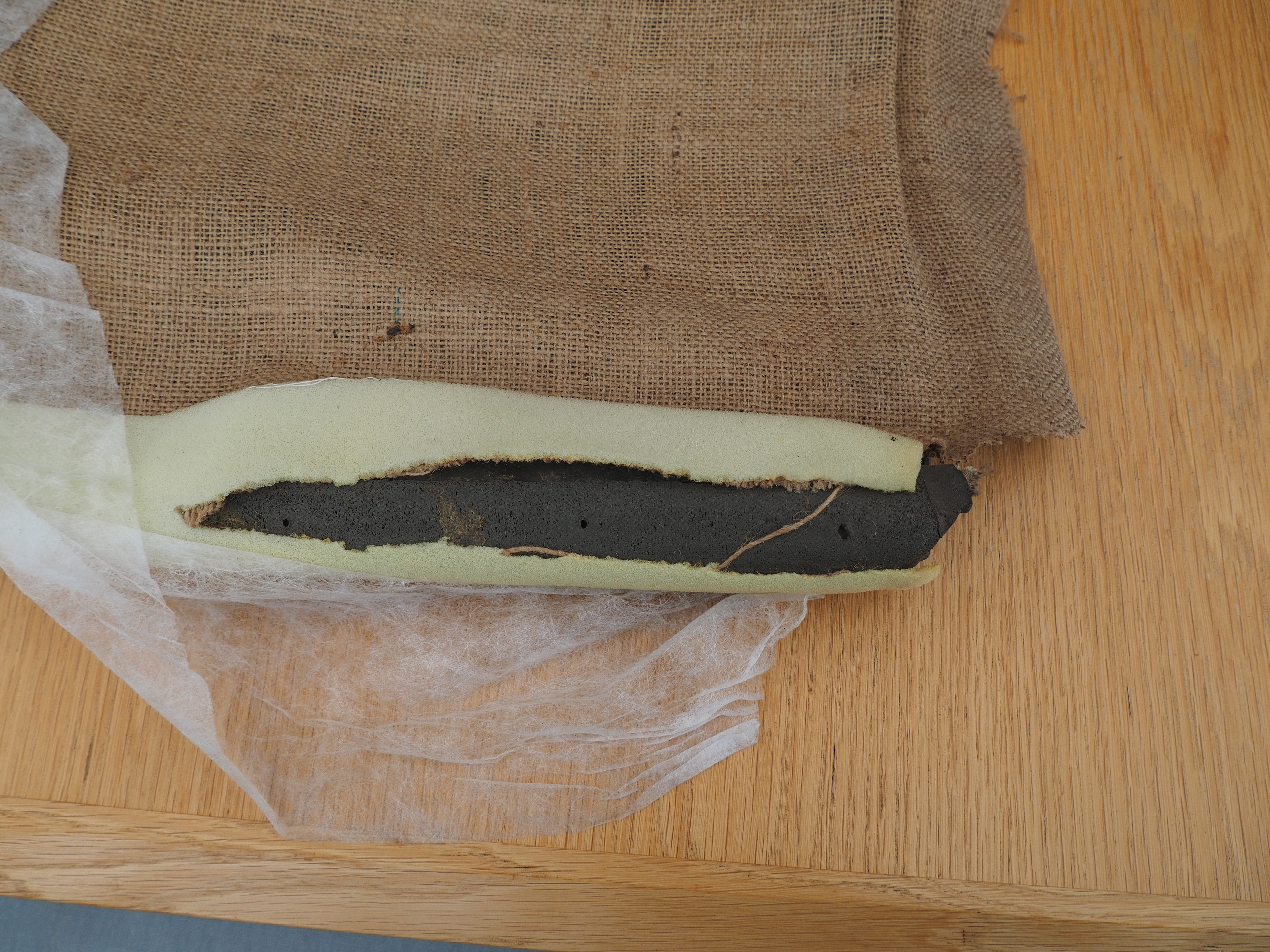

OK, my driver's seat is feeling a bit tired, to the extent that I can feel the lower rear bar on my backside when I sit in it. The passenger seat sees to be OK, so I was wondering whether the seats can be swapped side to side on the car?
Alternatively, is there anything that can be done to improve things e.g. pinching together the loops of the springing underneath and/or putting some extra foam padding in such as camping mat? Or is foam replacement the best option?

To start with, yes they CAN be swapped side-to-side, but I don't reccomend that you do it. The seats are 'handed' so that the back-squab release/lock handle is on the OUTSIDE side of the seat. If you swap them over, there is a good chance that the 'lock' lever (which will now be on the INSIDE side of the seat) won't return to the 'locked' position---it fouls on the central tunnel. Any/all your suggestions will work and help alleviate the situation; have you had an 'electronic' search of your area to see if there is an upholsterer in your area? It doesn't HAVE to be a vehicle upholsterer---any competetant upholsterer should be able to re-pack to seat to make it more comfortable.
Checking a bit more it was really the backrest that had gone baggy, so I removed the cover and foam from the backrest and found the culprit: the hessian backing had split away from the moulded rubber most of the way up one side of the rubber tube cover, making the front of the backrest sag. I've stuck it back with spray adhesive and stitched it with strong thread for extra strength. I'll refit it all tomorrow and check it out.
