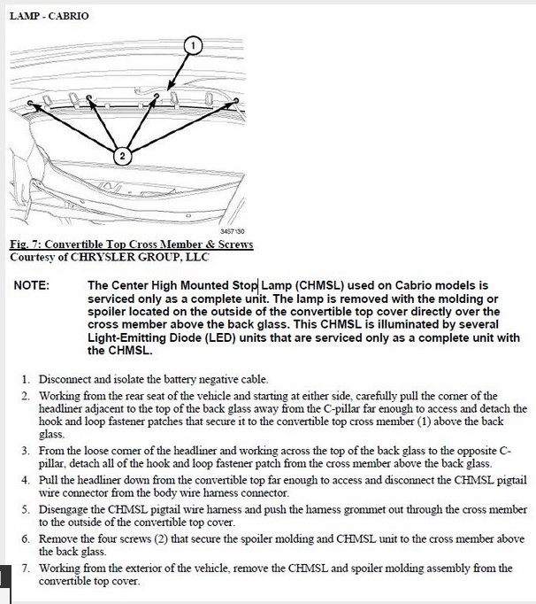

The 'blown' LED in the brake light has probably succumbed to condensation. The only cure is a new brake light which is fitted from inside the spoiler. Forum member BigKev outlined the procedure a couple of years ago and I'll try to find the post for you. Basically it involved pulling the trim above the window aside and undoing about four screws to remove the spoiler.
Later;
Quote from BigKev;
“Well, actually I had a go at this last year (this is an old thread). The rear portion of head lining is unclipped, then four screws are removed to release the spoiler, then the whole LED unit can be replaced. On assembly, apply more sealant to the four screw holes to combat leaks, replace screws and headlining. Fiddly working in the back of the car (it is for me as I am a huge fella!) but not difficult for a competent DIY type.
The new LED unit is hellishly expensive though, at over £100!!!”

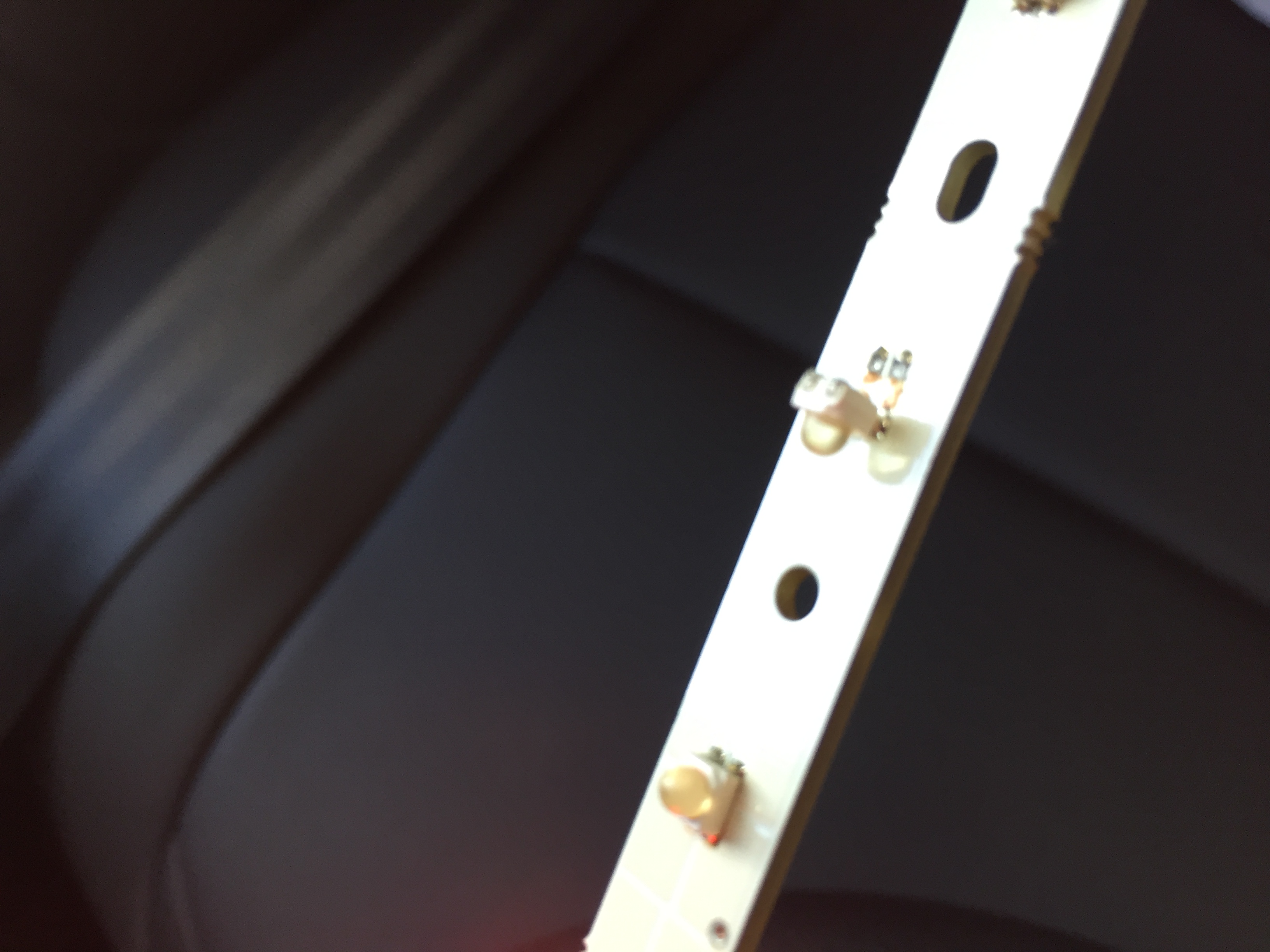

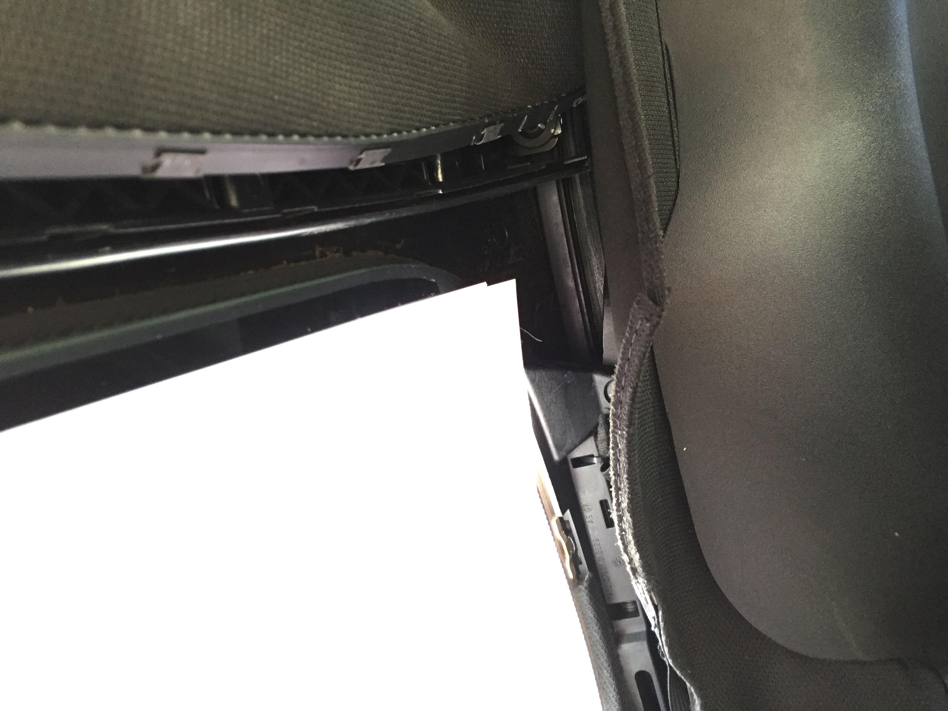

I just had to remove my third 500c brake light due a some of the LED's not working. I've had the car from new and the Brake light has lasted 5yrs ...not good really .
Ordered a replacement from today , Fiat Part number : 77365246 @ £155 !!!
As they always seem to fill up with water I thought I would take the old light apart to see where it needs sealing to stop the new one leaking and becoming faulting again at this silly price!
The issue seems to be around the red lens and its mount to the lens backing , so once the new one arrives I will be sealing around the light to try and make it last longer then 5yrs !
To gain access to the light is quite easy once the roof lining is removed and the previously notes written on this are quite easy to follow but here are a few pictures of the lining and the lens apart showing the issue with the SMD ( surface mounted device) Led broken off the circuit board , I suspect due to the damp of the water getting into the lens .
