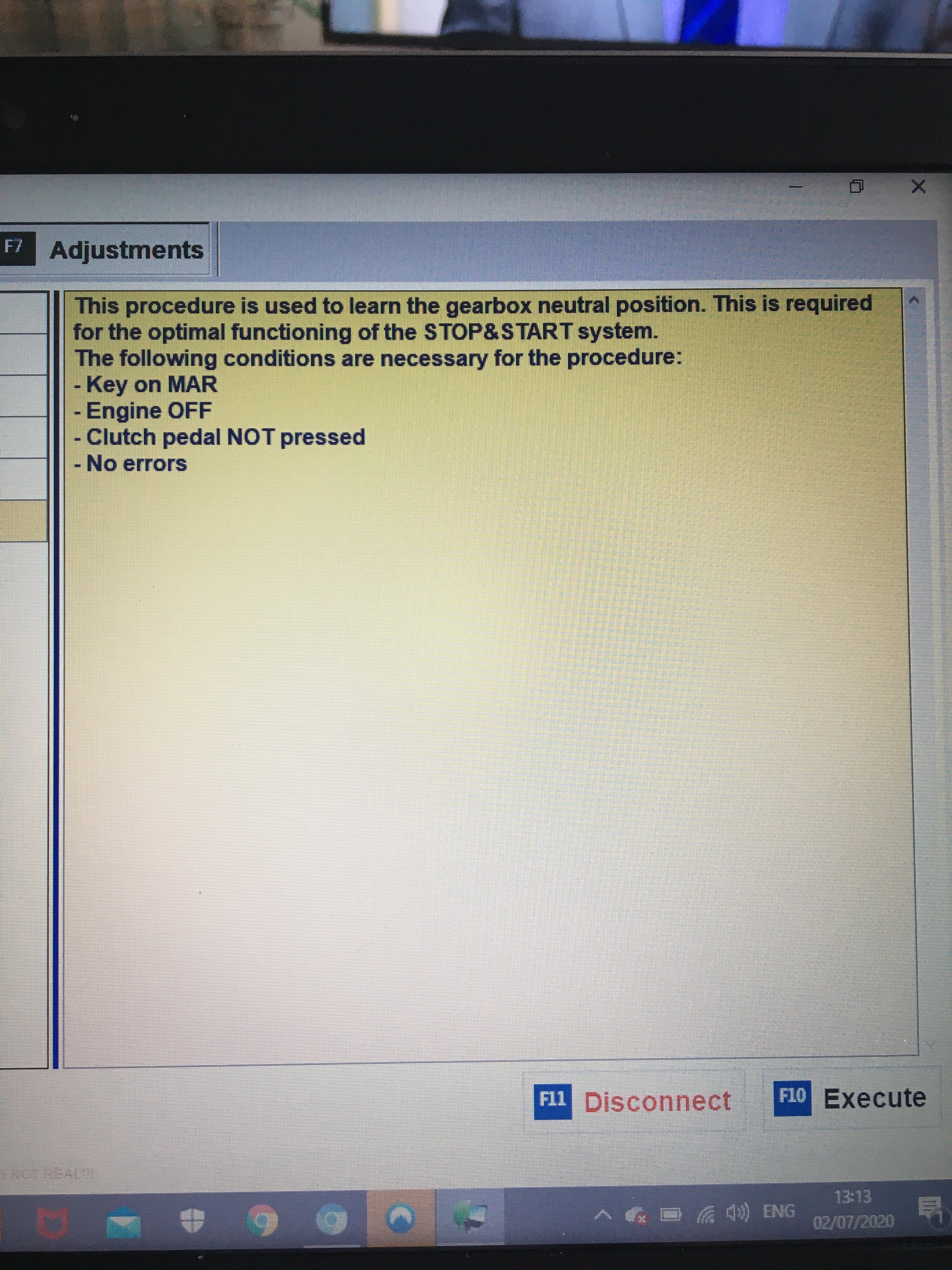

View attachment 1Hello,Still having issues with my SS [emoji23] it’s so flaky just tested my battery it’s reading 12.7 on the little chart that came with tester that is supposed to be high... in your experience is that correct?
Also I was periodically checking my car with MES I noticed this thing called neutral signal learn so I tried it as it suggests for optimal functioning of the SS but it won’t execute I’ve no errors either so I’m a little confused View attachment 210668View attachment 1
Hello,
Testing condition of battery using voltage reading is notoriously unreliable , even if the pre voltage read conditions are followed(I won't get into those conditions here)
You could take your car to a halfords shop and ask them for a free battery check. Halfords near me use a yuasa battery tester that new costs around £1600 . Even then it is not gaurenteed to be a100% reliable test.
