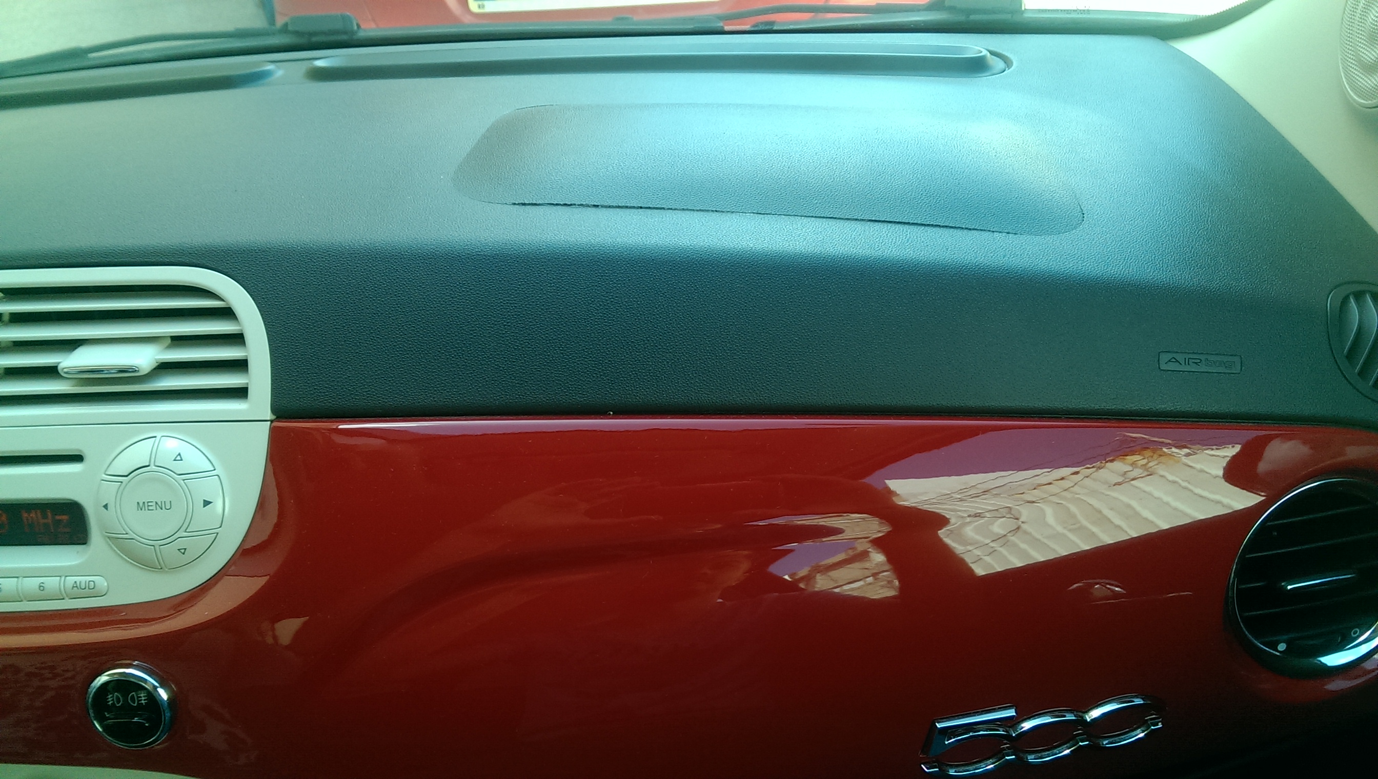

BTW the Fiat HQ doesn't really give a s**t most of the times, for example i live in Israel and for some reason almost every normal Fiat 500 on the road has this passenger airbag getting "popped" out of the dashboard, and it looks really bad and ugly, who knows about the safety, we got a huge web forum where dozens of people with the same issue responded, even with the new Punto's (2009-now)
Fiat wont recognize it, even sent them an Email that never got responded for!
I went to the dealership where i was told to pay 1681 EUR to replace that (after giving me the face of "ohh you too with this problem"), only after a long conversations they agreed to the price of 450 EUR, and even that is too much.
