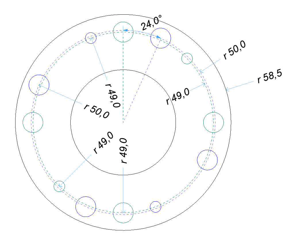

After some thinking... This should be totally doable "in situ".
Either with a magnetic base drill, or an indexable guide, or both.
Gonna cad this to see what happens with the bolt spacing. Even 5x112 might work out.
Well, turns out the flange is not big enough for 5x bolt patterns, according to inter of web the diameter is about 117mm.
4x100 is doable, optimum rotation of the pattern is about 24 degrees, that would leave maximum separation on all holes.
