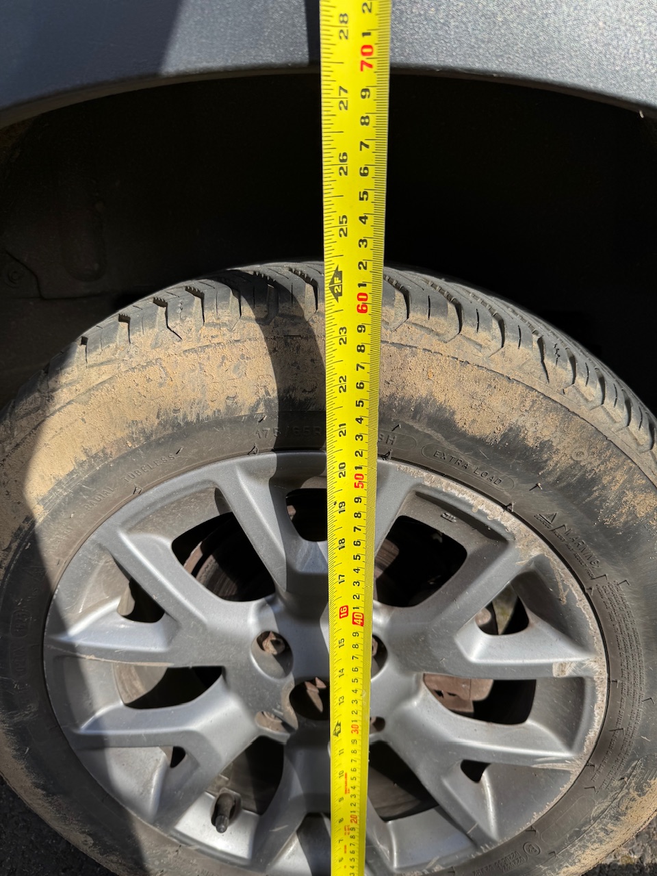

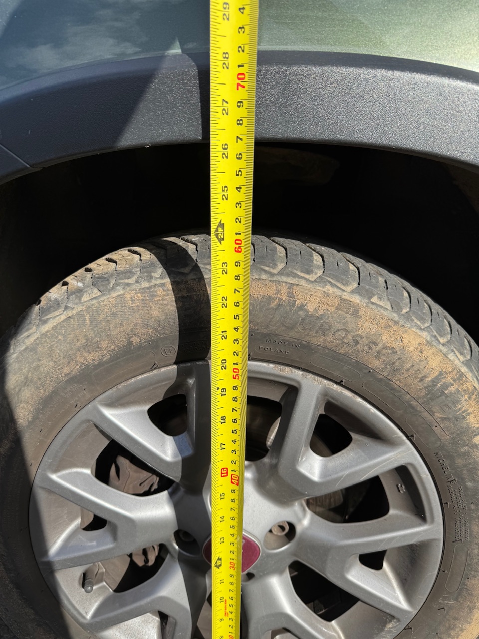

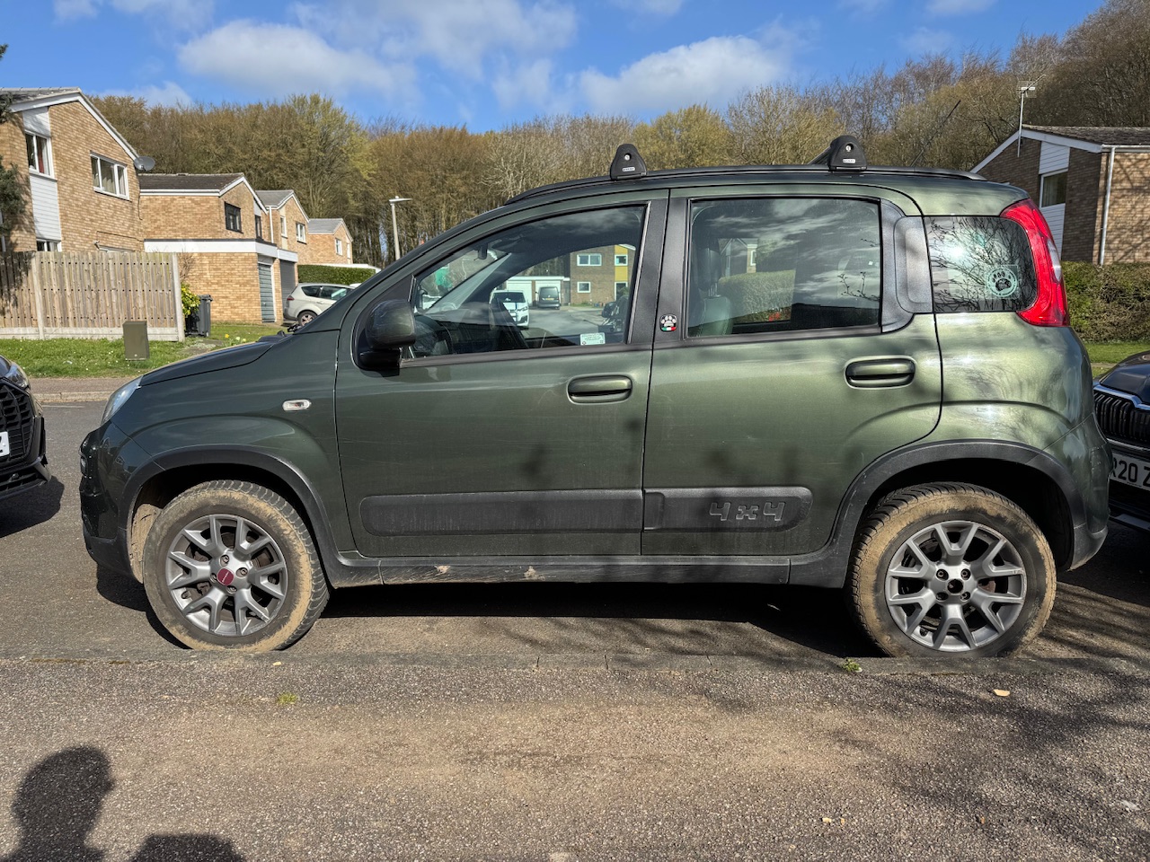

Just measured mine: road surface to arch at front is 670mm (first photo). At rear it’s around 700mm unladen (second photo). This is a Diesel 4x4 on 175/65r15 tyres. A 4x4 Cross will be 6mm higher than this owing to its marginally taller tyres. Third photo shows ‘slightly nose down’ attitude.
A rough indication is that there should be about 150 to 160mm between the ground and the lowest point of the engine undertray/sump guard.
