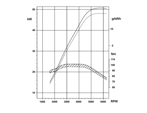

That's the problem with test driving old cars
The engine curves of the 60hp and 69hp are near as dam it identical except right at the rev limit
I posted the engine dyno print outs of both awhile back
There so many variables, cam timing, plugs, air filter, compression and so on to get a fair comparison
These are off an engine dyno
Rebuilt engine after 50 hours run time
You should not be able to tell the difference in normal driving, if both cars are 100%, reduced compression causing bad low down torque due to incorrect timing is common the 69hp
69HP
60HP
Trace up from the 2000,3000,4000 marks
VVT only kicks in at higher rpm
I rate the 1.2 8v engine, the torque curve is spot on for 60-80mph crusing even when fully loaded.
Completely agree - it was one of the first things I noticed when getting to know my 60hp Panda.
It pulls much better than a few 1.4s of similar age I've driven, and suits the car perfectly I think.
It really helps that it generates maximum torque at 2500rpm - significantly lower than a lot of equivalent engines.
