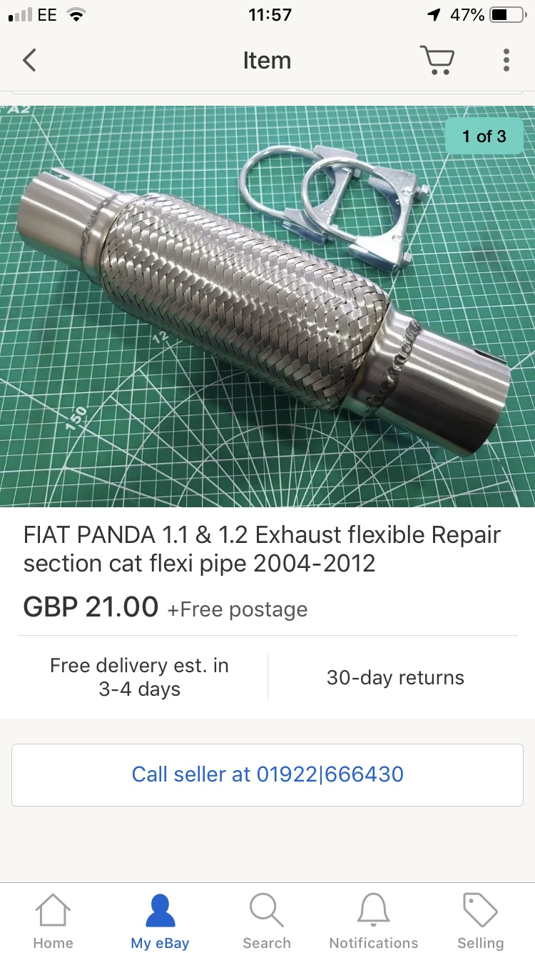

looking through ePer. Can't see any small connecting pipe ?
On my exhaust the cat section is connected to the middle section with a flexible pipe like this IMG_1557.JPG

Can you cut the pipe under the car, move the front part to the catalyst outlet and joint with flex joint? Then fill in the gap with a straight pipe and exhaust clamps? Or even cut the front end out and fit a longer straight pipe.
