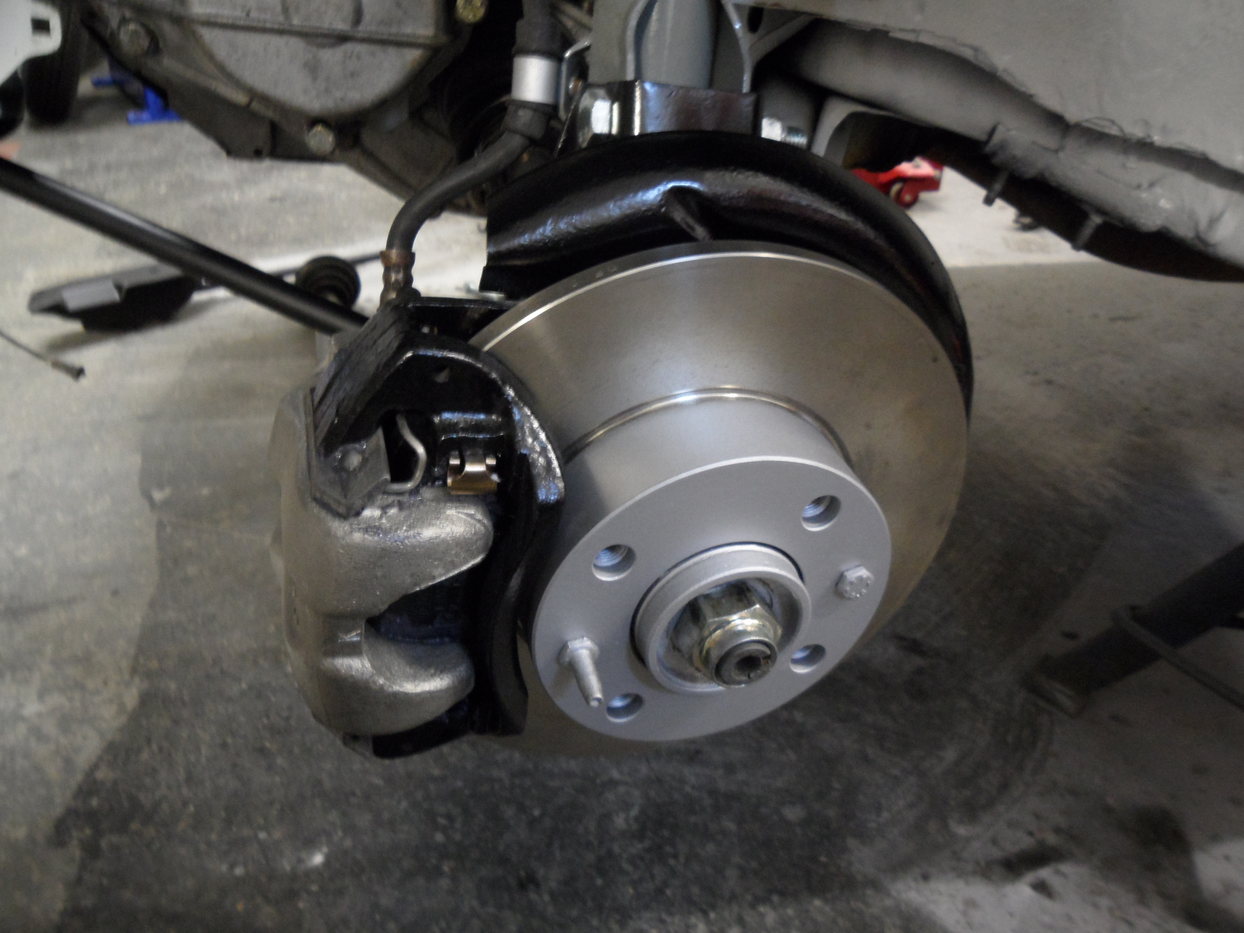

I decided to paint the centre of the disc, not original but it will stop it being brown in a couple of months.

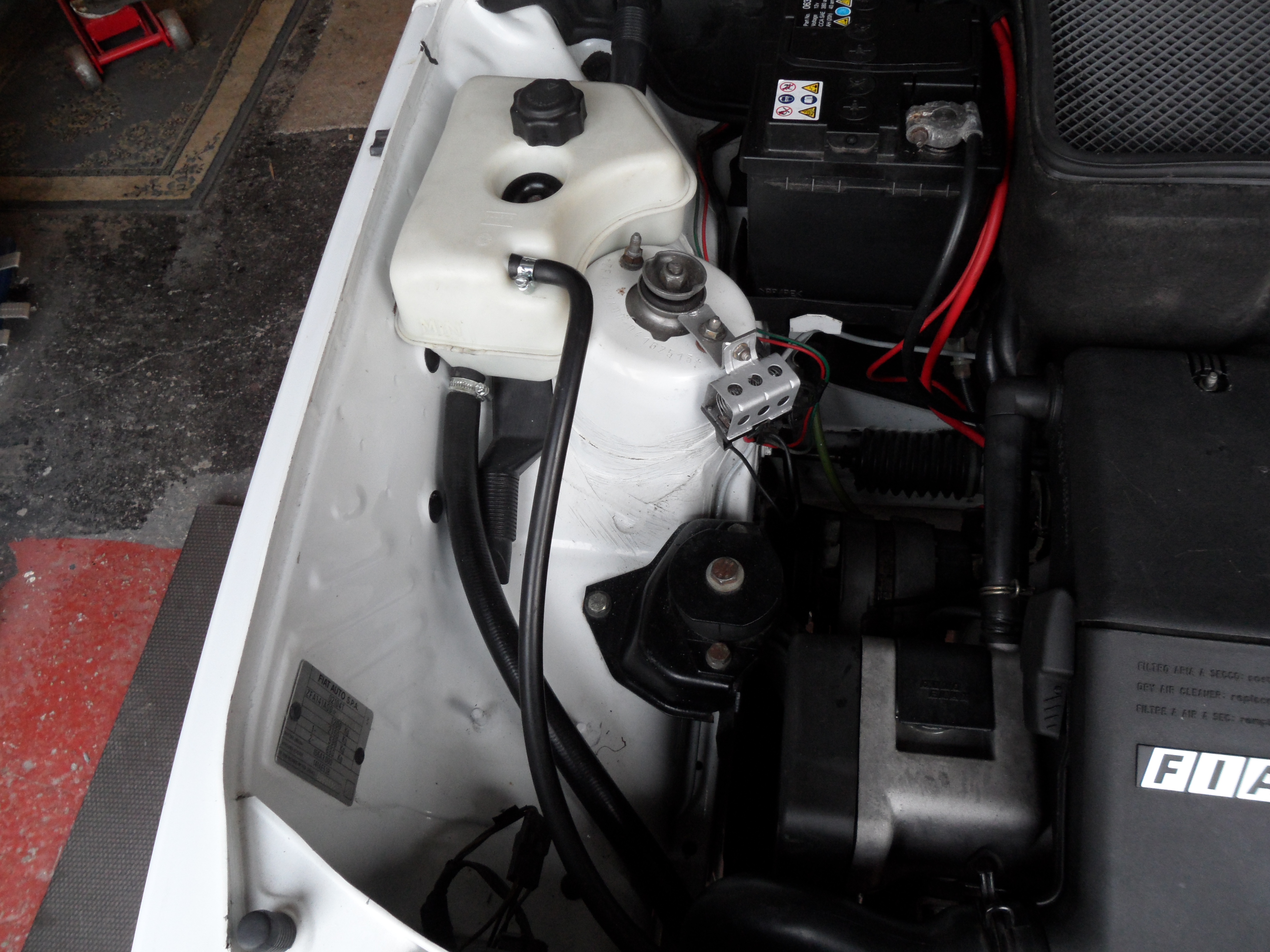

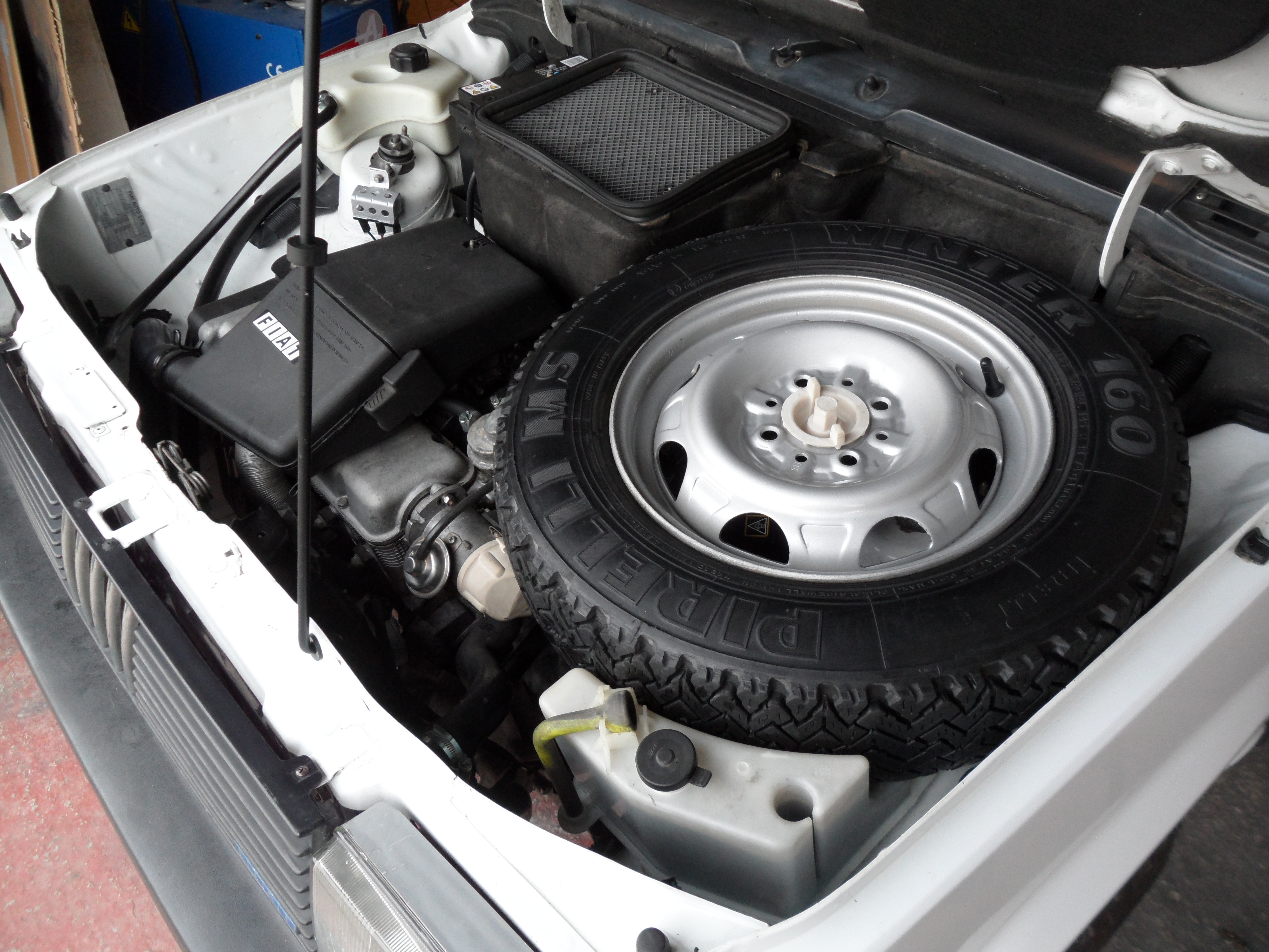

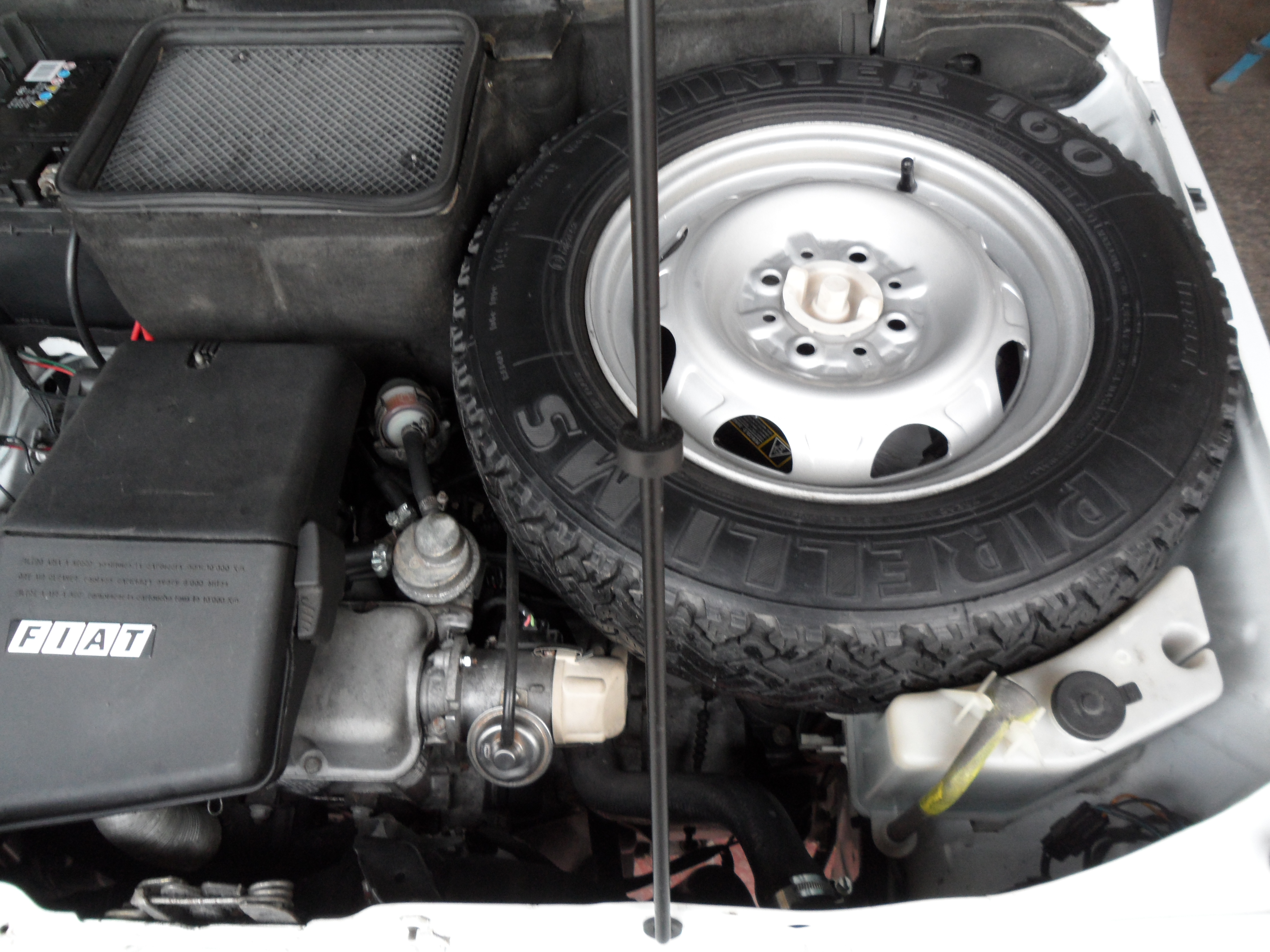

As it's as good as done here are some final pics.........
shame about the rough running, and now you have to slum it in that tatty mk1 eh:p;) could be worse.
Still looks stunning though. Not sure I'm going to make it to any shows this year, too embarrassed now:eek:
