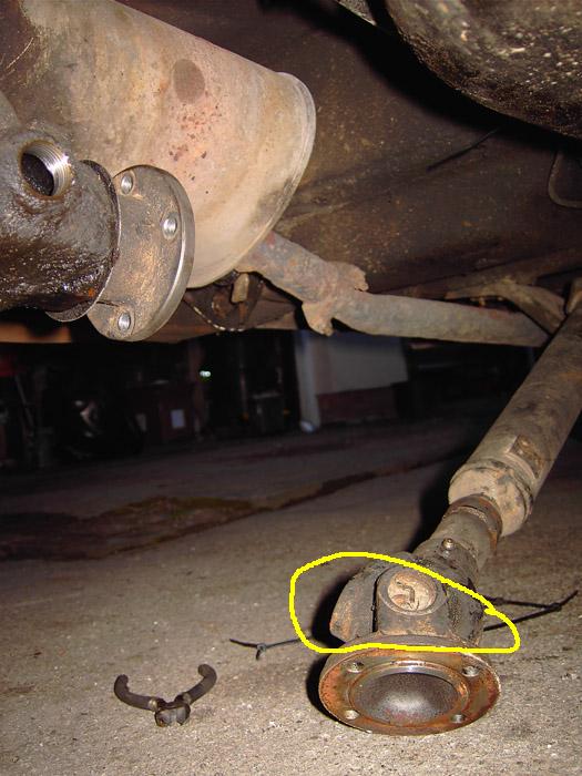

Small play in drive shaft diff which is normal of course..
Drive shaft disconnected and soon to be tied up next to the fuel tank for test run...
Not sure there should be play in that part Jaff as the shaft just after the UJ should do that. There is also an expanding section on the front part of the shaft but the gearbox section it bolts to is solid.

Damn I'm crap lol.. okay to contradict myself totally (i'm tired) The actual drive shaft has no play.. if i pull the 4x4 lever and try to move it its pretty solid the UJ points all seem good.. the part with the small amount of play and indeed the ultimate result of the rattle is the actual rear axel drive (photo 1).
I drained the oil and checked the bearings inside and they all seem solid and good. The play seems to occur somewhere between the actual read axel drive and the wheels.. I'm sure this is normal as i doubt you could get this totally solid but I don't know anything about these drive's...
Grr.. this is a tough one :(
Yep that's what I thought you meant but the pic shows as if there is side to side movement as well as the slight turning play which I believe is normal, the side to side isn't.
However......the propshaft will always turn with the back wheels whether the 4x4 lever is in the 2 or 4wd mode it just wont drive the prop in the 2wd mode. SO the propshaft and UJ may still be the problem.
I ask again is the UJ stiff to move? if it is it could be throwing the prop out, if not could be the propshaft bearings.
Sorry for my ignorence Alan.. okay the pic is a poor example.. there is only turning play.. other than that its solid no side to side movement. I'd sure bet that was a smashed bearing if there was.
The actual UJ is not stiff and quite flexible, there is no play in it. I have also shaken the propshaft to see if i can hear any noise but there isn't any. As for propshaft bearings I'm not sure how to check those so it might be them..
But all in all speaking as someone with zero experience with these it seems to look good. My theory on the rattling is simple that when 4x4 is not on the propshaft has slight turning play causing knocking. When 4x4 is on.. becasue the machanism 'winds up' there will be no turning play in the shaft at all thus no noise...
