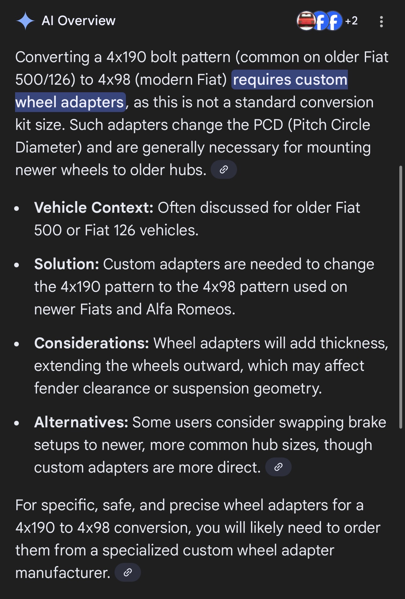

I think you’re gonna have to go straight to 126 series 2 drums, that’s what I did but at the time I wasn’t looking for an adapter as I had issues with my front setup and offset. Someone asked the same question on a 126 forum and no one answered. And the oracle AI, ok I jest, but it doesn’t hold much hope 😩
