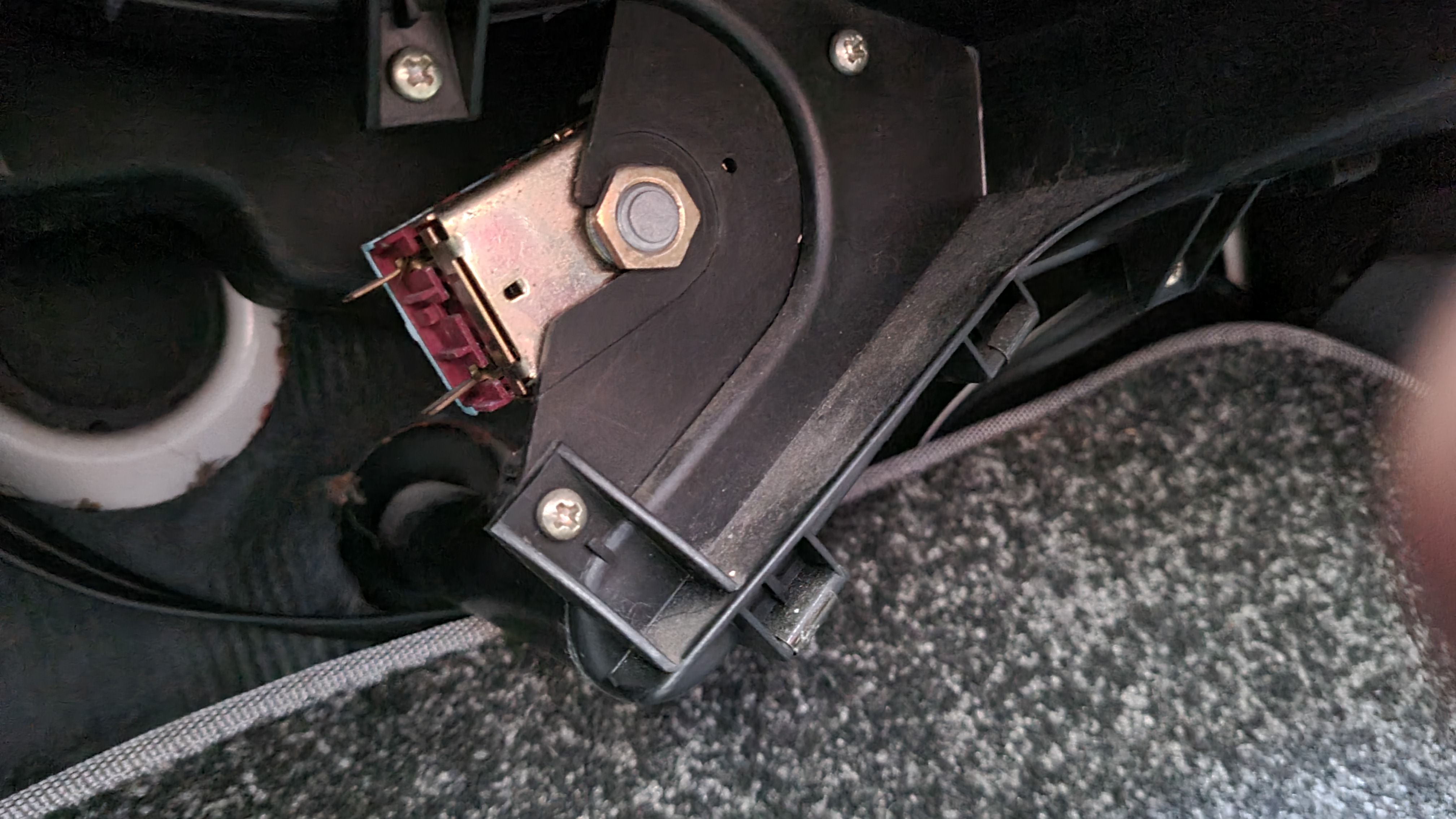

I have always wondered where my air con thermostat is as I realised that it always got too cold and then froze when the air con was on. After searching on another thread I found a clue and then I found the one in the picture attached. I know this is the correct one but as you can see, there are no wires attached.
Can anyone take a pic of their unit and/or tell me where the wires attach to?
I guess I'm going to have to hunt a wiring diagram out at some stage too.

Here is a link to the relevant section of eLearn on 4cardata. Please note that where the descriptive text reads "N086" it would make more sense to substitute "K086". There are also other errors.
Thank you Communicator. The information is very appreciated but I'm unsure if the diagrams is correct as my thermostat has 2 Lins whereas the one in the diagram has 3.
What do you think?
