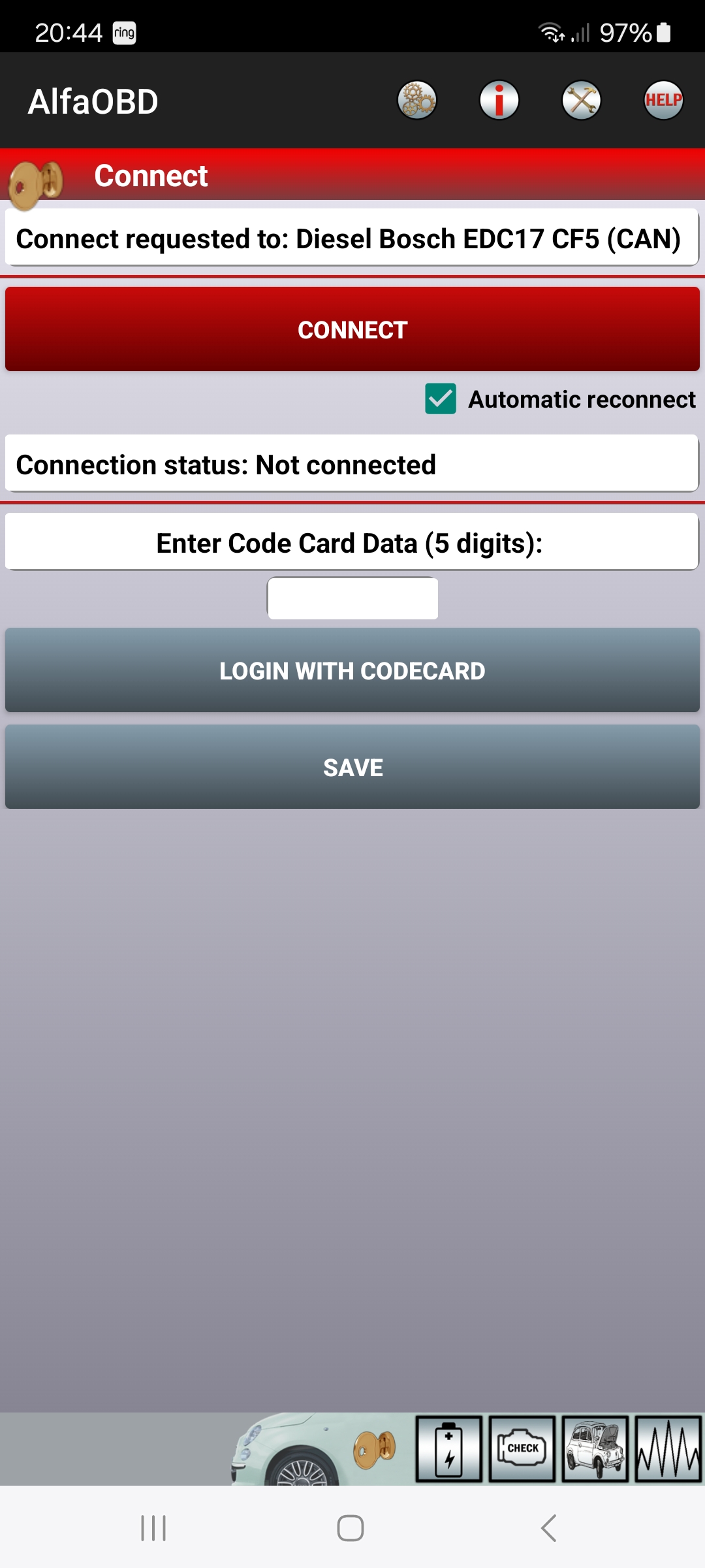

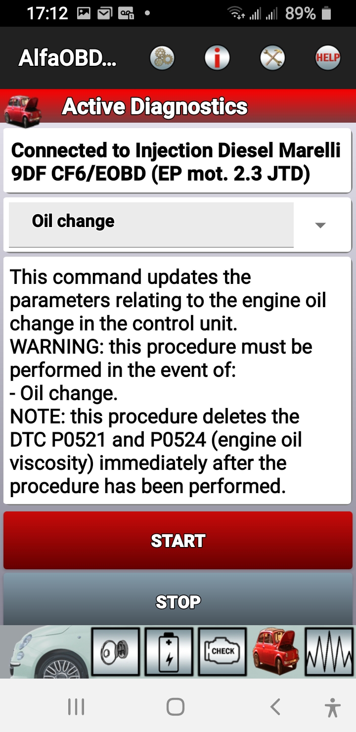

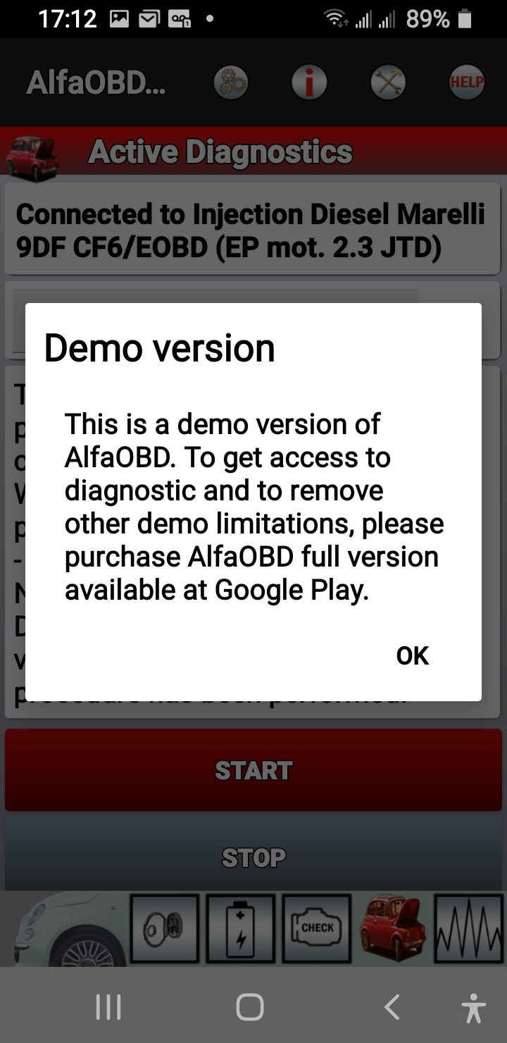

Short answer yes. Long answer dont know for your vehicle, after 2019 they had a bypassable SGW (secure gateway) then later (dont know when) it was moved into the body ecu so not as easily by passable (if at all, someone please verify if poss). The demo version will give you the opportunity to prove connectivity but will not reset the oil systems. see screen shots i tried then used my Multiecuscan to reset. I have and have used both but for general use prefer Multiecuscan, but, alfaobd is always with me on the phone when in the van. Dont forget you will also need an obd interface.
