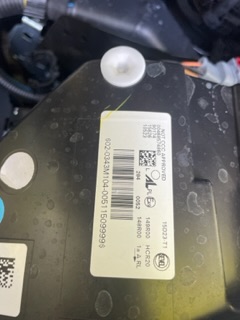

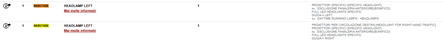

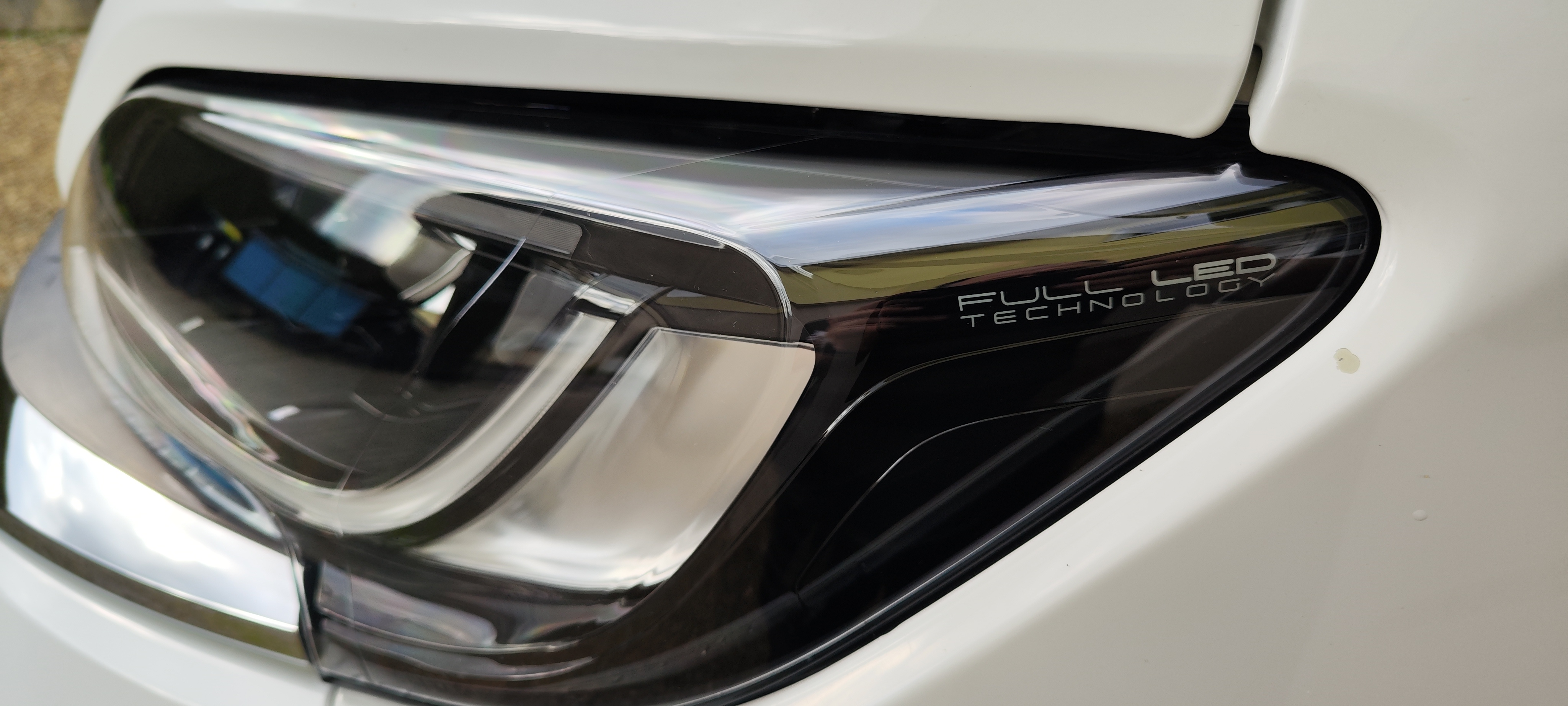

I've ordered a 2022 LHD Ducato based campervan from. France. It's nicely specced including full LED headlights with LED DRLs.
Does anyone know if its possible to adjust these headlights for driving in the UK (so it passes the IVA??)
I've seen elsewhere that these LEDs have quite a flat beam and also seen mention of a 'neutral' beam pattern (whatever that means) but cant find a definitivec nswer to their adjustability for driving on the left ( or back again if on holiday in Europe).
Any help much appreciated.
Thanks
Ian

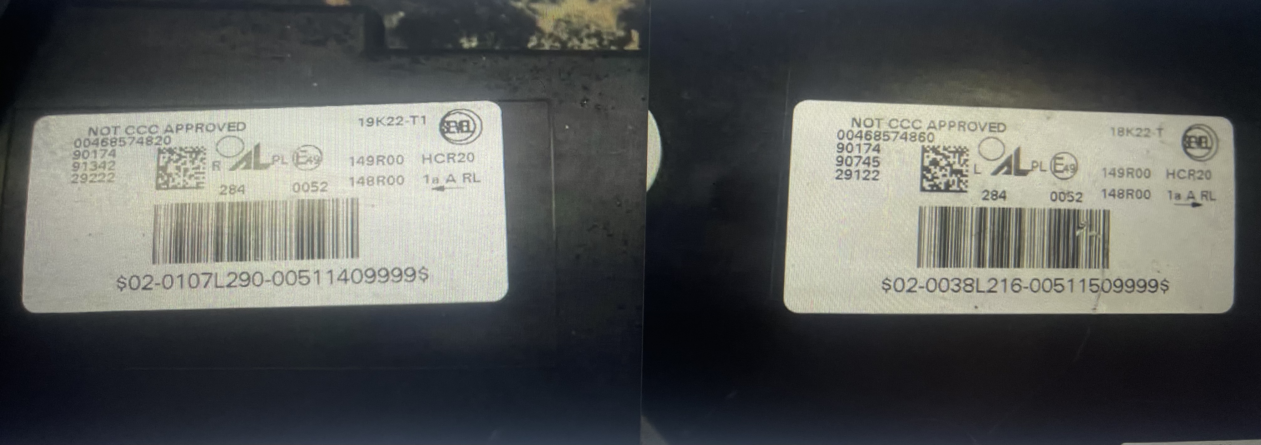

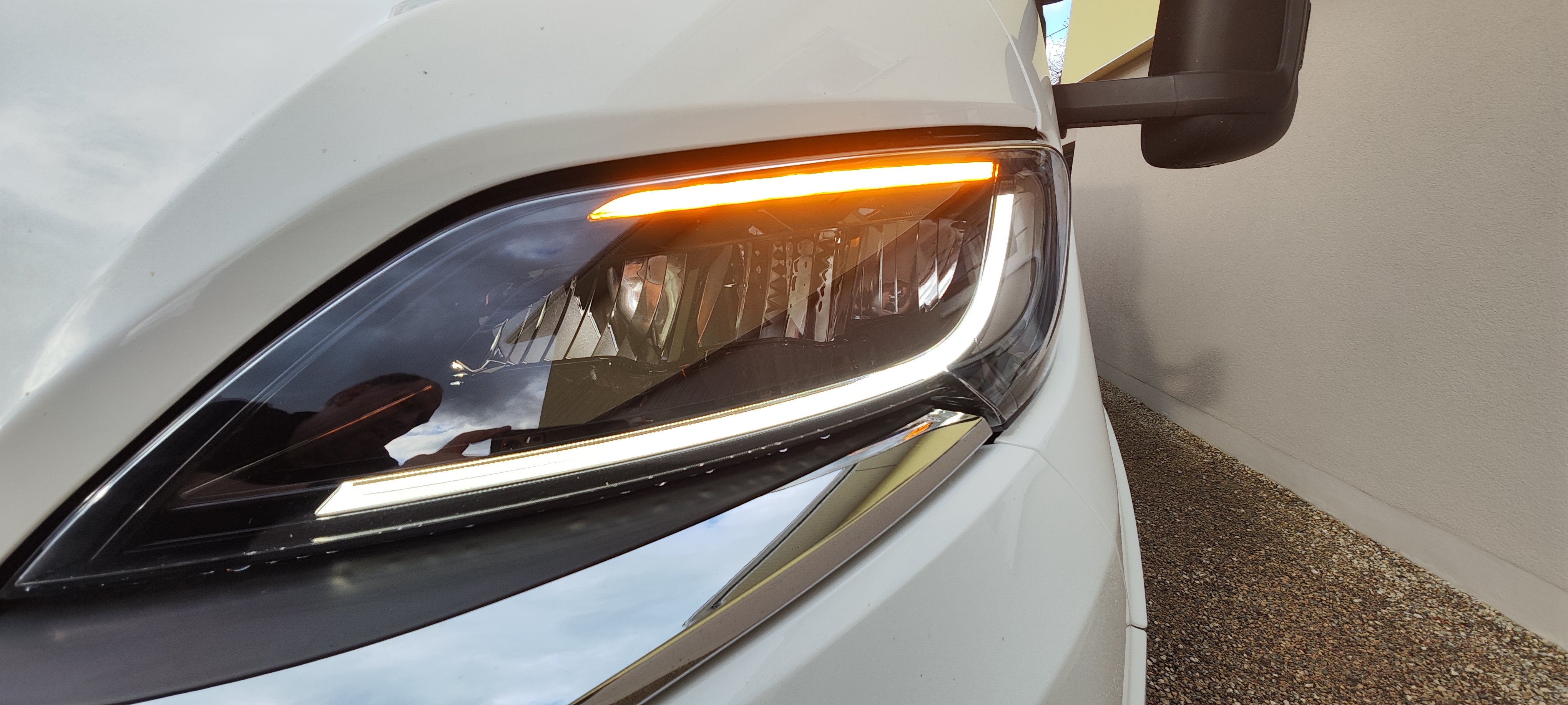

On 2019 (halogen + drl led) it was:
Byte 76: 20
Byte 134: 20
and worked properly with full led headlights, but with errors on dashboard for drl and signals(resolvable with 21w resistors)
I've changed to:
Byte 76: A8
Byte 134: A0
working properly, but still have errors on drl:
B1078-96
B1077-96
Component internal failure.
Can someone help us with custom proxy values from a 2021+ with full led headlights?
