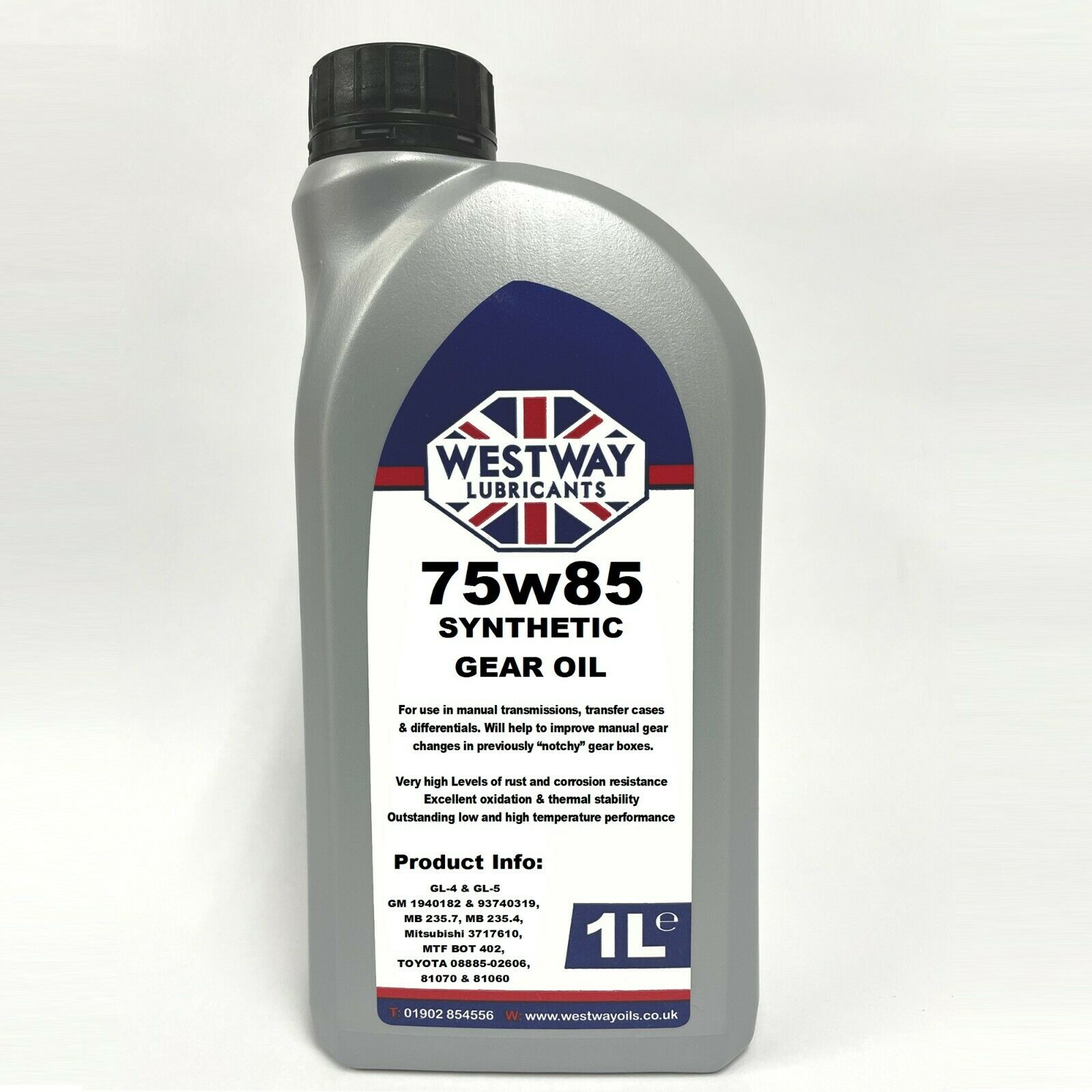

Have a read here too, as you might get the alternative oil for less? (The specs for the rear differential and front PTU - only found in the diesel 4x4 - suggest the newer oil spec (with GL5 in it) supersedes the older spec and can be used in both locations… pretty sure this is what I used in the PTU/idler gearbox
Just on Westway one of their gear oils (not this spec) recently twice failed testing by the Industry Body (VLS) in terms of it not meeting claimed spec. Not all specs are routinely tested, the VLS only responds to complaints. I went with the lubricants recommended & supplied by a dealer.
Just fyi, make own judgements.
