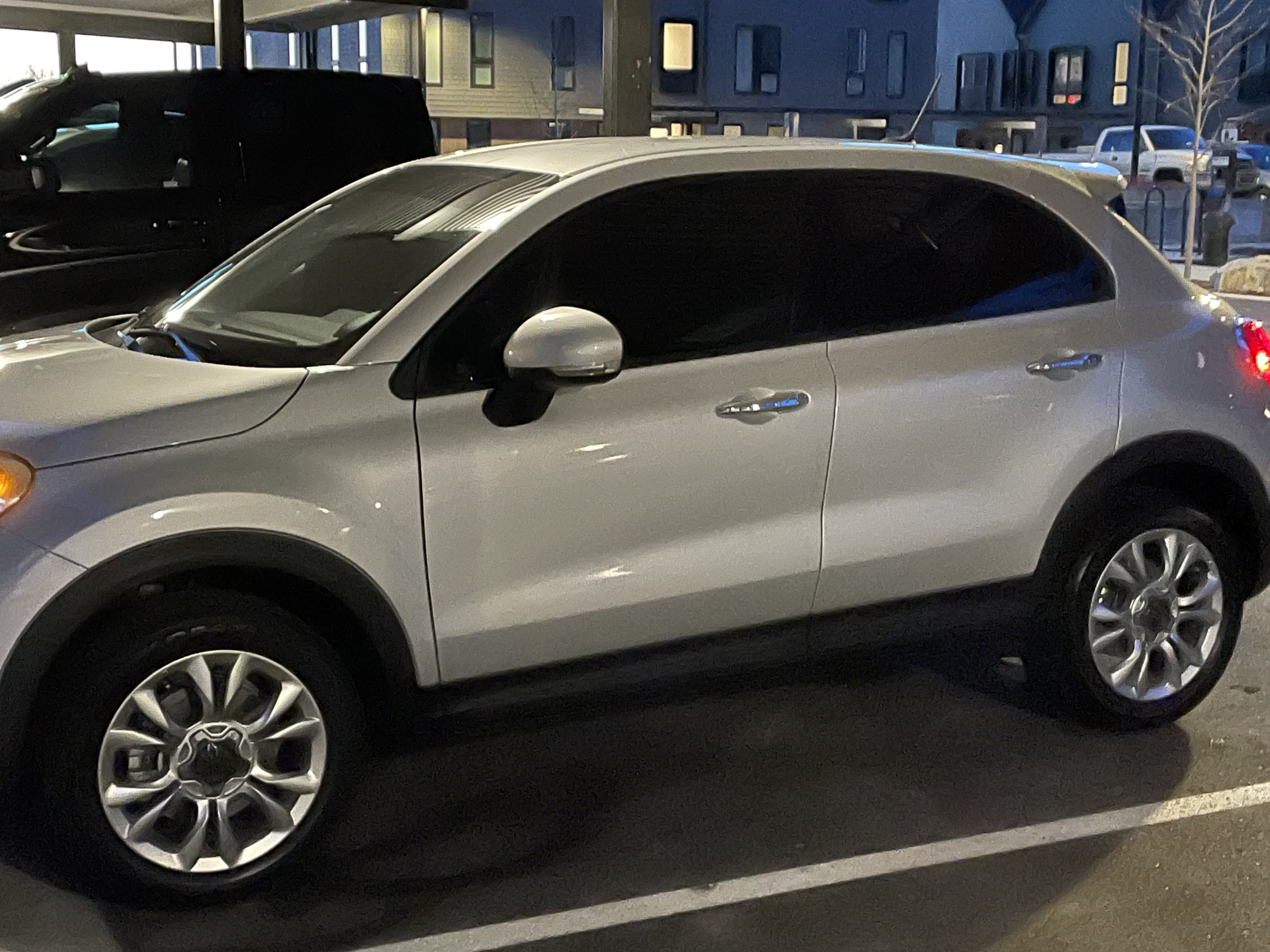

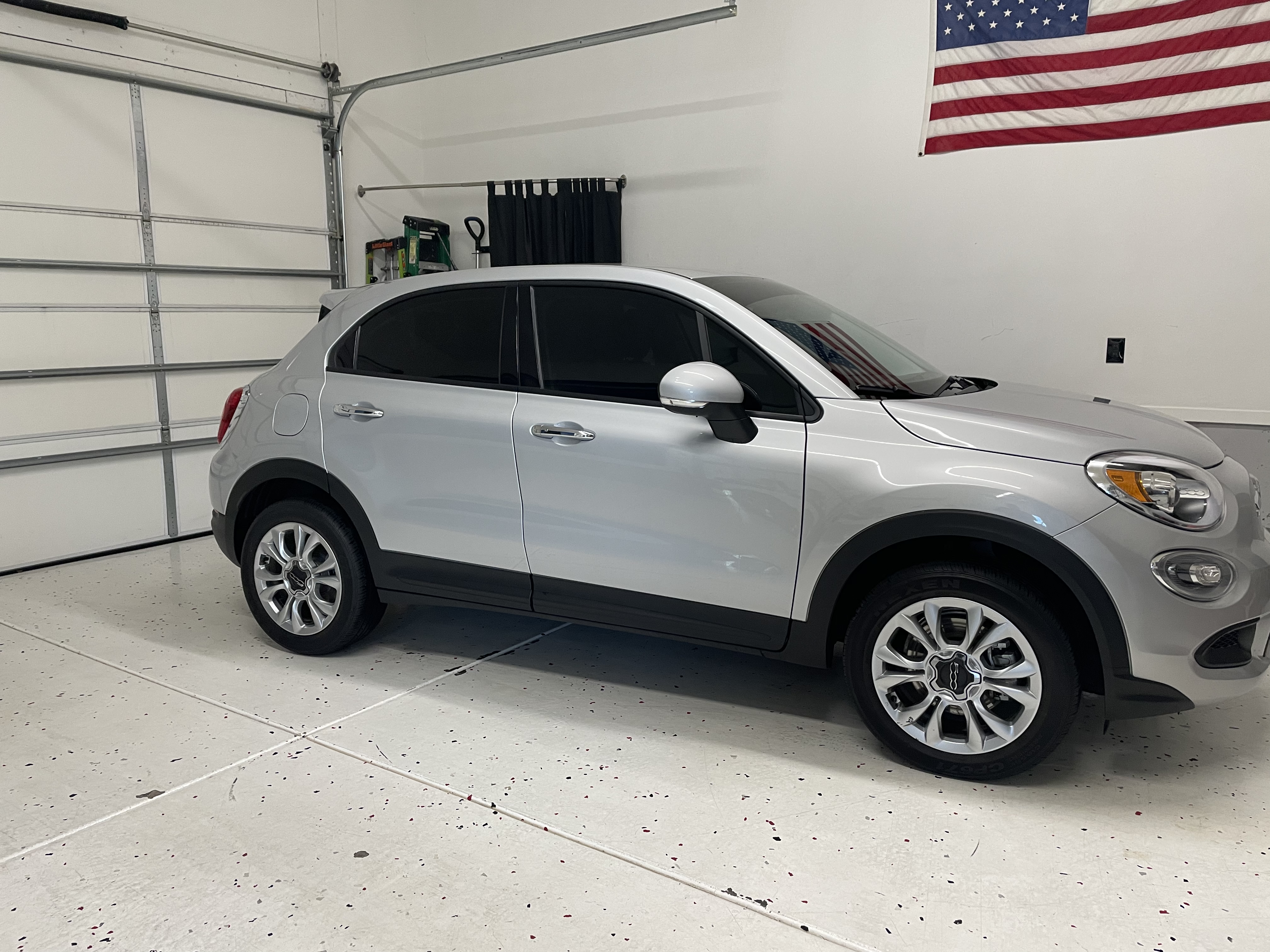

Here is a photo with the tint. Lowering springs came and I decided against the springs after having the car out on the freeway this week. Really liked the ride so keeping it that way for now.
Added tint, interior spider floor mats, rear cargo mat and tomorrow 20mm wheel spacers go on.

Is tinting the front windows to that extent legal, where you are? Looks very dark to me.
Mind you, you may have sunshine and other stuff, which we (UK) doesn't..
Ralf S.
In Idaho - USA. They are dark. Itā€™s the look I wanted. Also did a 6ā€ banner to match at the top of the windshield.

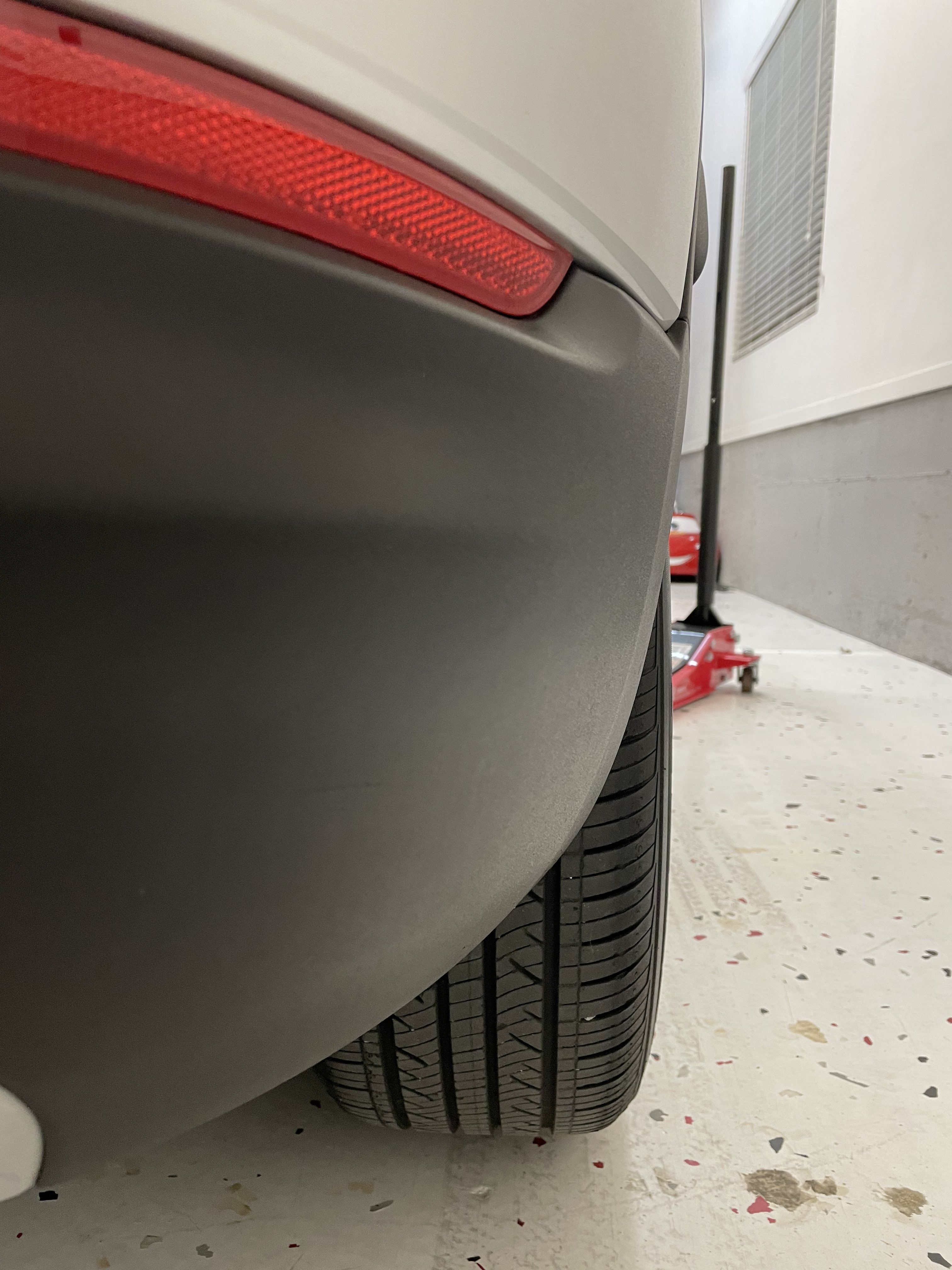

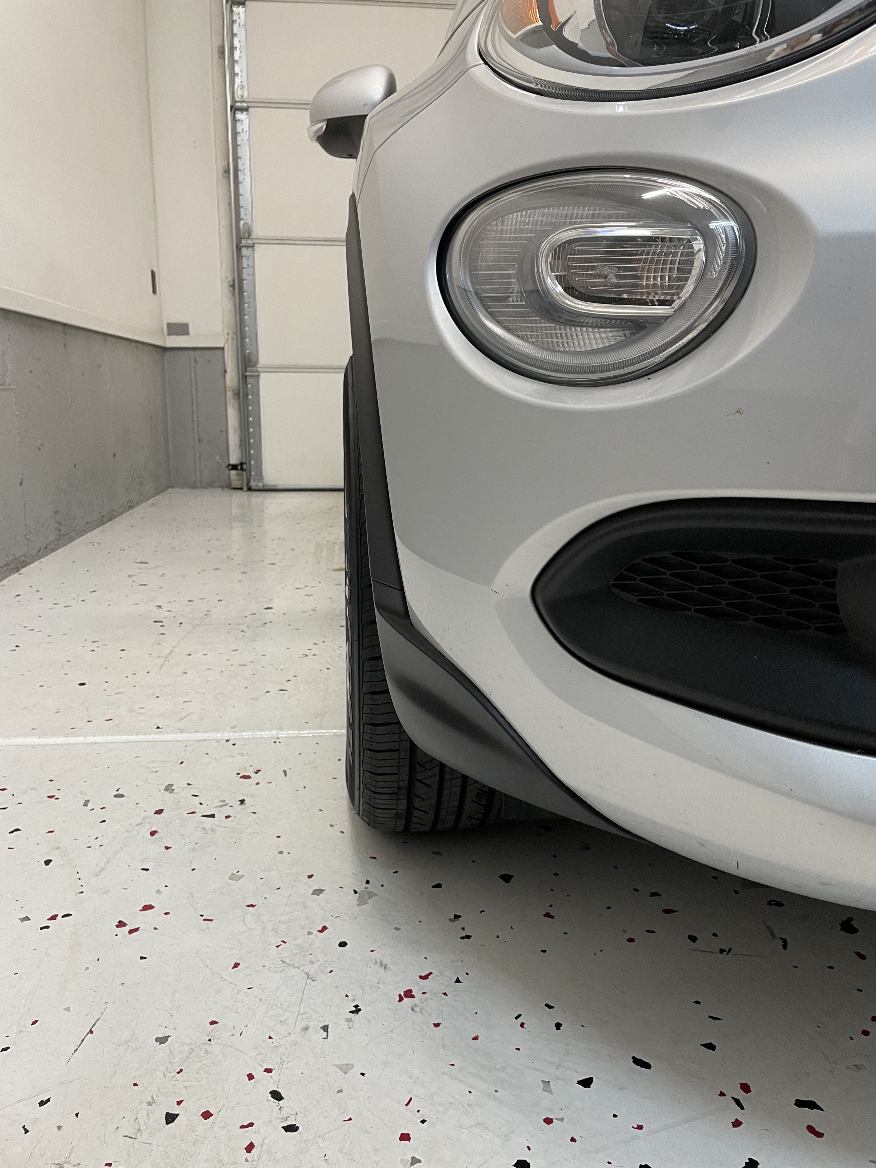

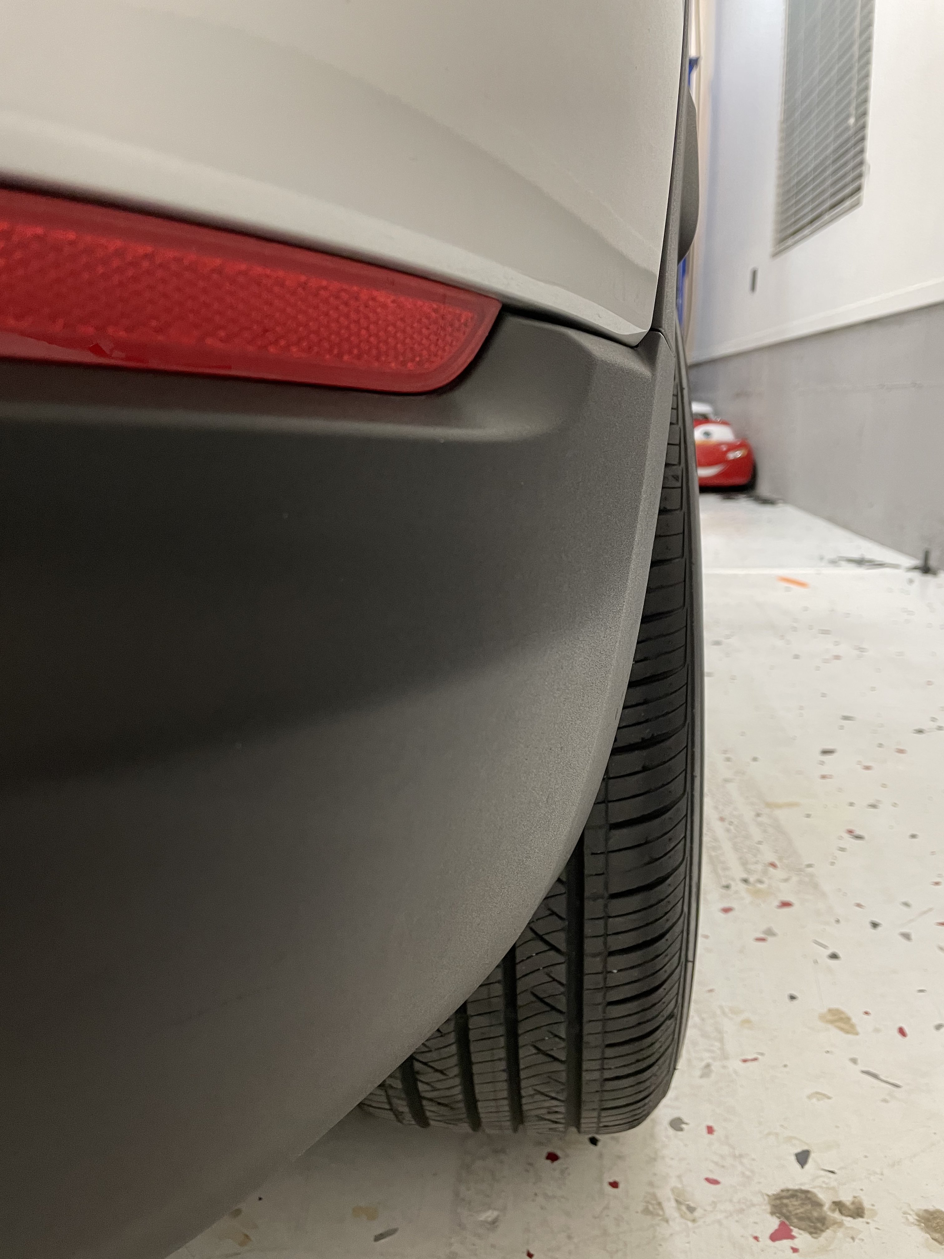

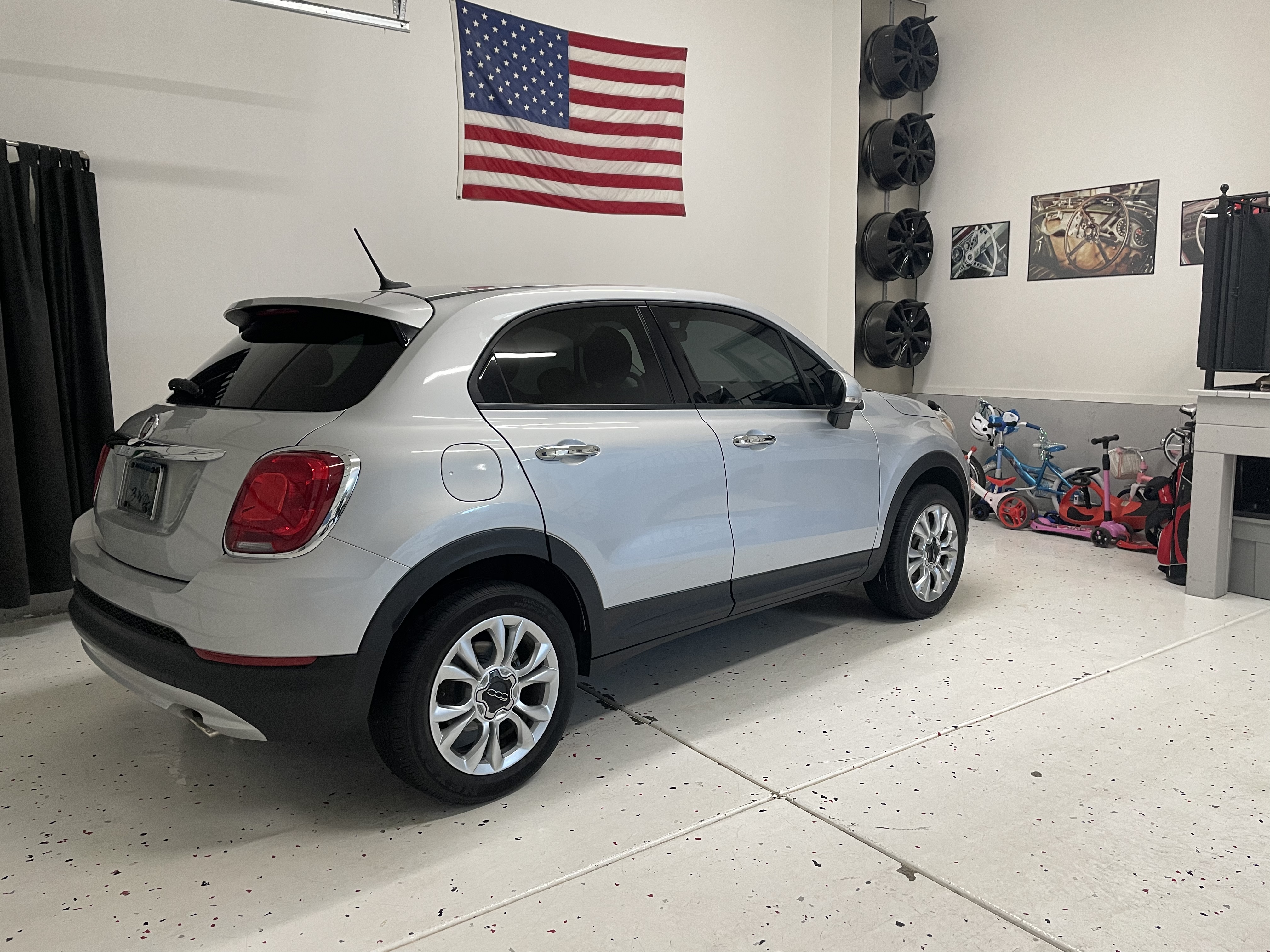

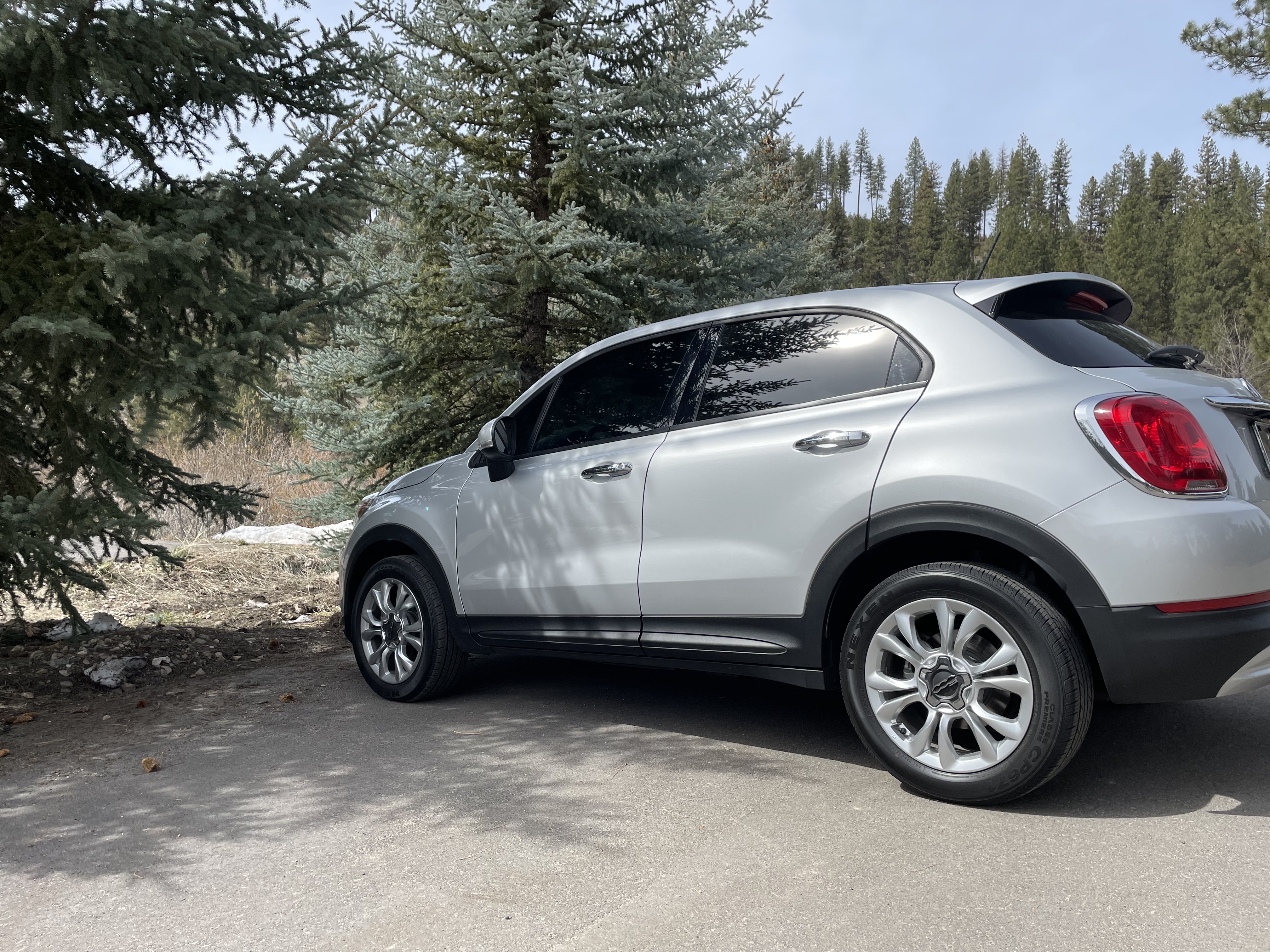

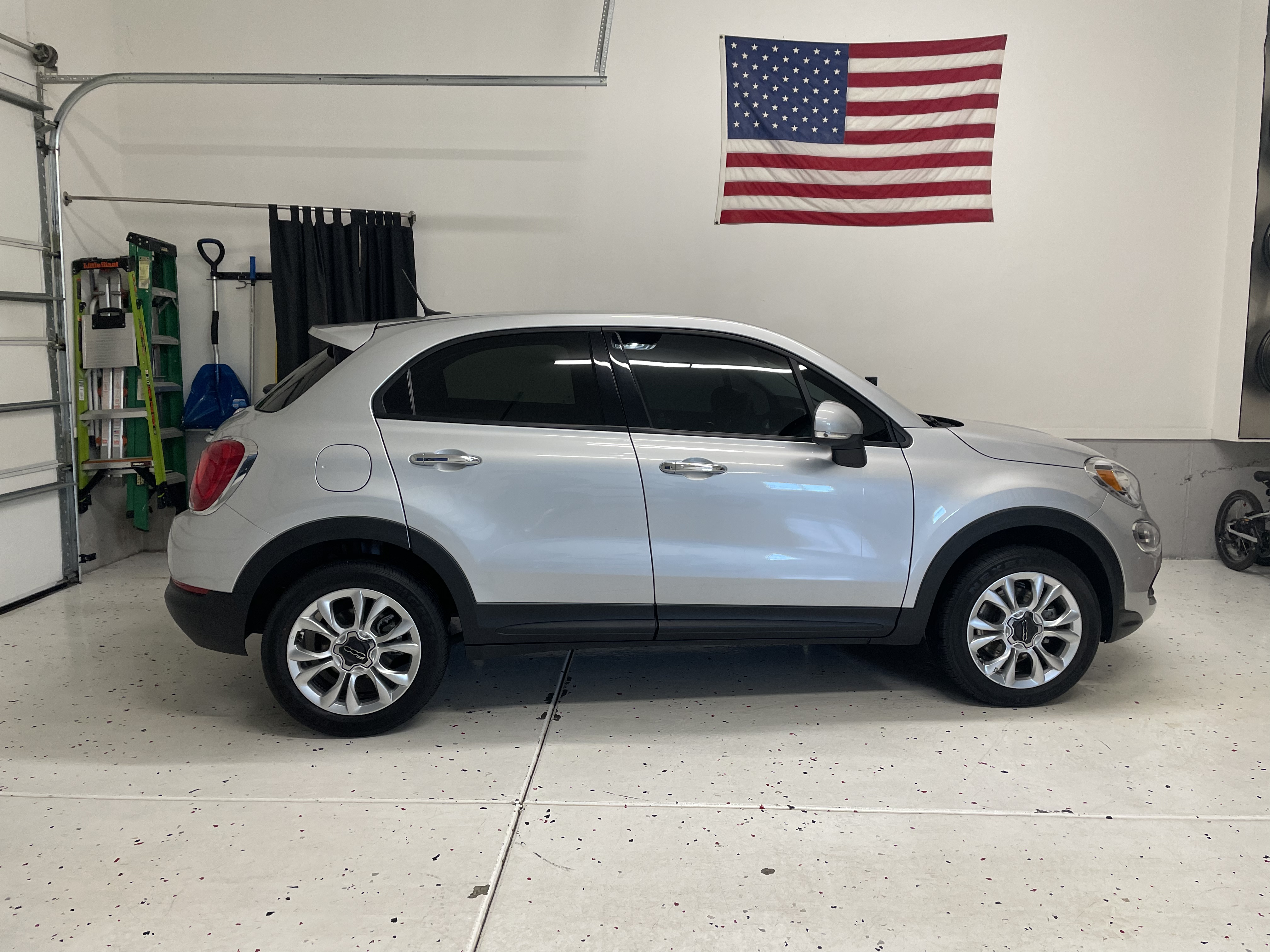

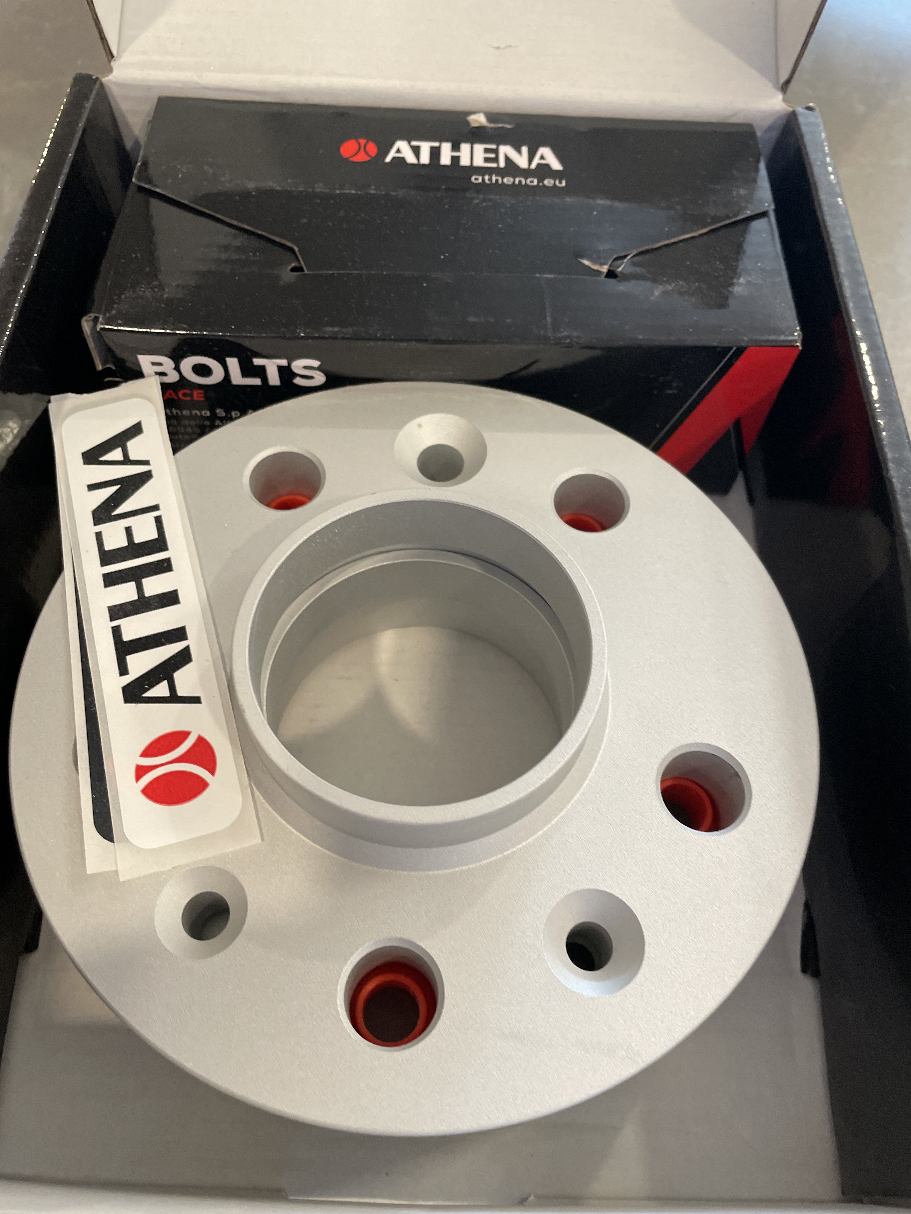

20mm spacers from 500 Madness. Love the look. Before and after of front and rear.

Looks like a good improvement... just check that the front wheels don't touch on the liners on full lock.
I had a Alfa 155 once where the new wheels I bought had a smaller offset, to achieve the same look without spacers. Because the outer edge of the wheel was further out, when the wheels were on full lock, the arc of the tyre came closer to the curve of the liner, and fouled slightly on full lock. It was only really a problem when reversing, since the tyre caught on the "vent" louvres in the liner and went "grrrrrrrrek". I had to increase the offset by removing the 155's standard (on the v6 anyway) 4mm spacer and that sorted it.

Lock to lock seems just fine. No rubbing on my end. Really like the looks. Im sure it will make a difference in handling too. Certainly glad I did this. Would highly recommend them to any 500x owner on stock wheels.
I didnt want to change out the stock wheels because I like the factory look.

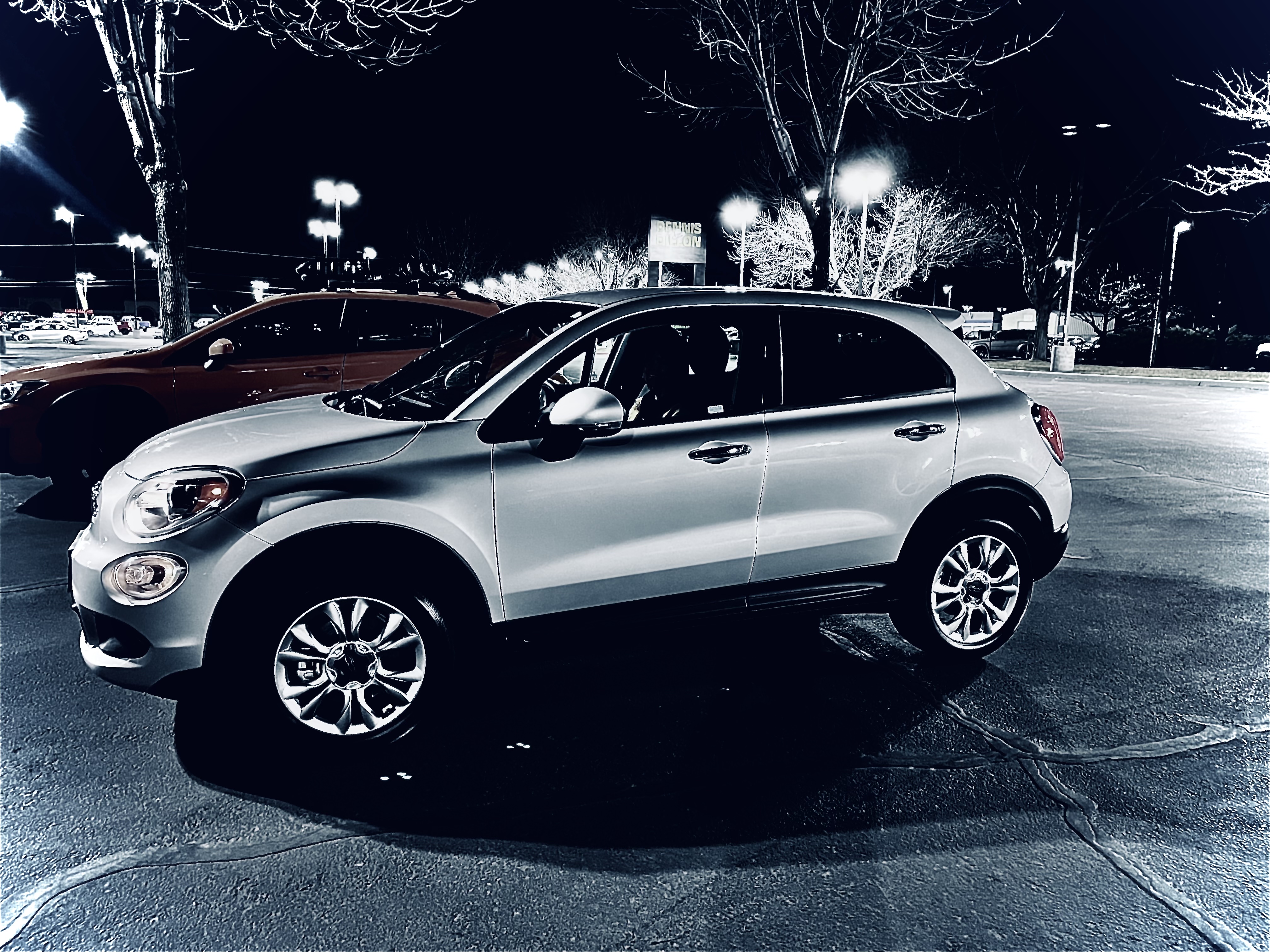

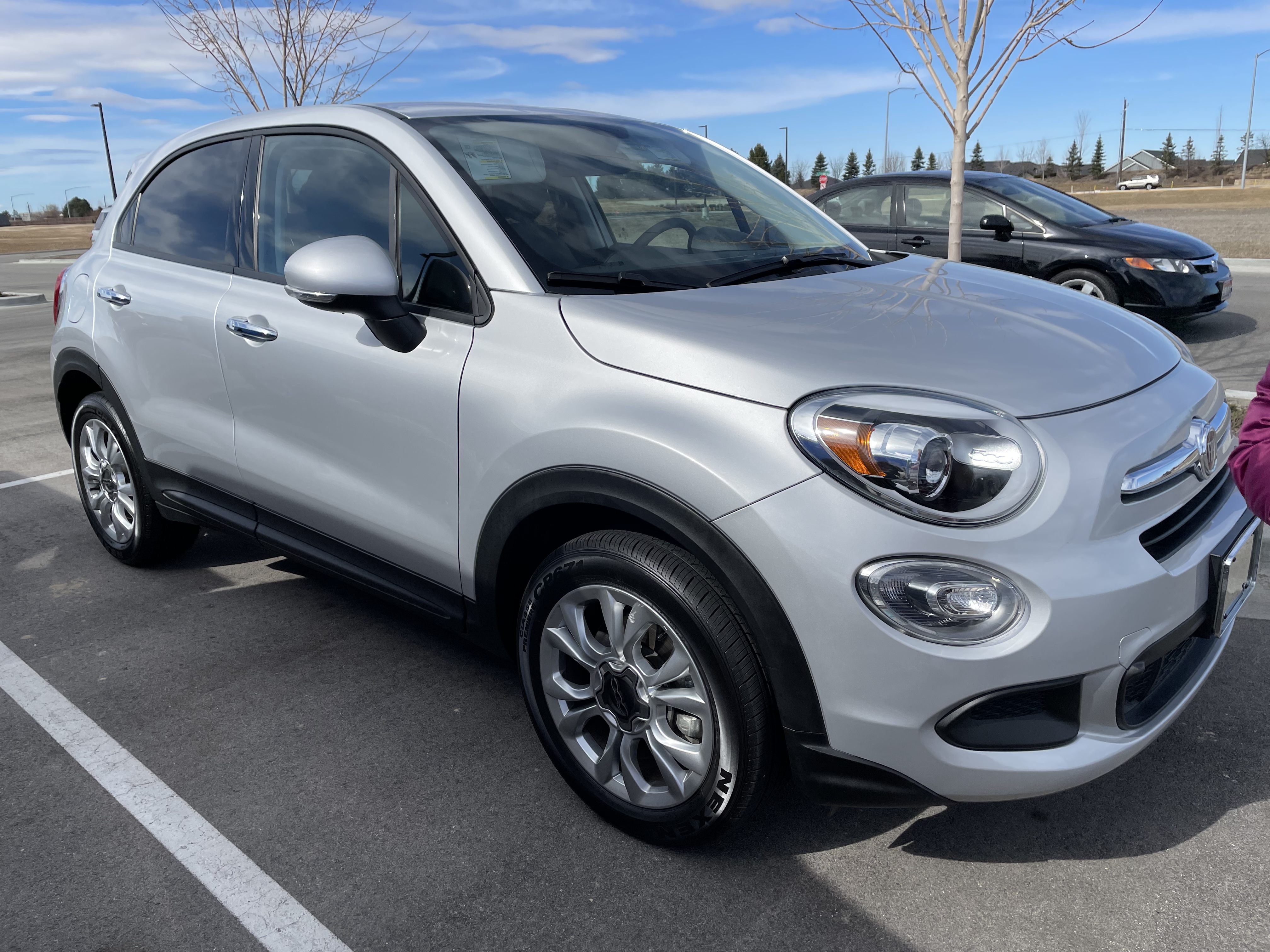

Loving our new to us 2016 500x. Put on about 1500 miles so far and itā€™s been great. A few observations from our end which are noted by many others as well.
- shifting is wonky around town but once on the highway itā€™s fine.
- normal mode is great on trips but sport mode is much more fun to drive
- the added storage space in the rear floor without the full sized spare is great for essentials while on a trip.
We have added the following
- 20mm spacers from 500 madness. The stance is so much better. I do feel like I can tell a handling difference as we did a canyon run after installing and it was a more solid feel.
- Max Spider 3d floor mats from 500 madness are insane. Such a great fit and the protection is wonderful.
- front window tint to match the back. Might not be legal in some places but it is here. Love the look.
- full clay bar and ceramic coating to improve the finish.
- 500 Madness Go Pedal is coming this week to hopefully improve the wonky shifting and overall experience.
The car only has 14k miles total so itā€™s fresh all around. Looking forward to more improvements under our ownership.
