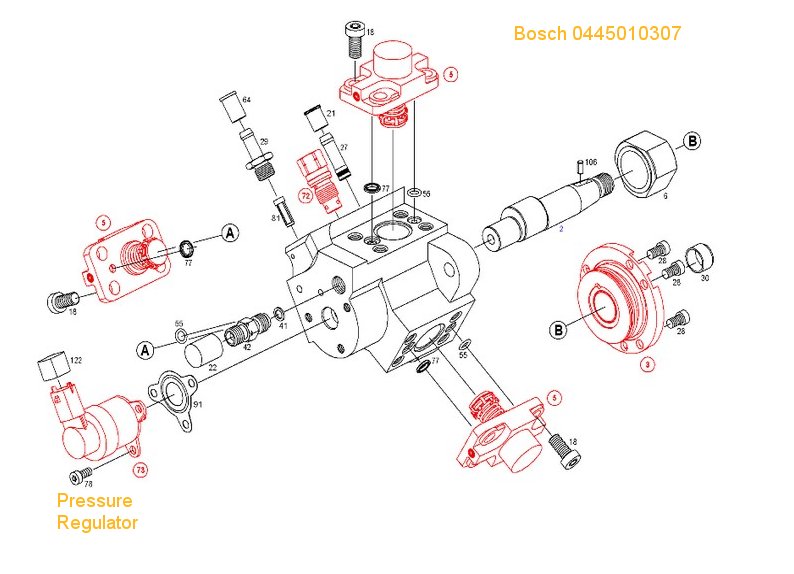

The code P0094 indicates low fuel pressure. If the fuel pressure drops too low, the ECU will cut out the engine to prevent damage. I agree that the Fuel Pressure Regulator valve could be faulty, it is part of the high pressure fuel pump but can be removed separately. This valve is controlled electrically with a PWM signal at about 1 kHz from the ECU via 2 wires. If do you hear a sound from this it should be a steady medium pitched whistle/buzz.
The clicking noises and the random nature of the problem could indicate a problem with the regulator valve. It is not a very expensive component.
It is also possible that the regulator valve is OK but there is a problem with the electrical connection between the ECU and the valve. I suggest you carefully check the connector pins at the valve and the ECU, and the wiring loom for any corrosion or damage.
