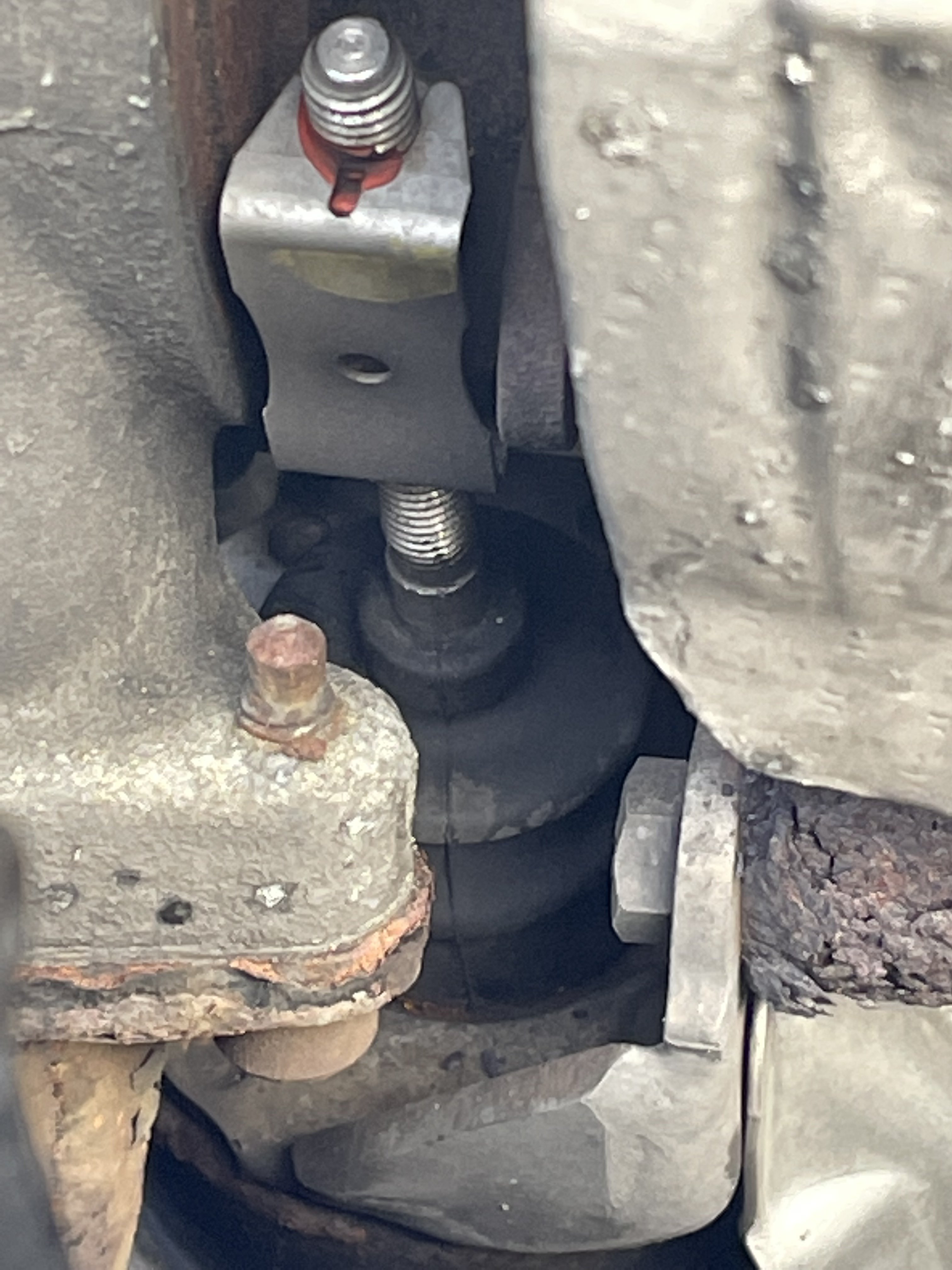

EGR’s look quite fiddly to replace on this engine so I thought I’d try to finely adjust out any minor deficiencies in the valve position with a hammer and 3/8th drive extension as a bolster. I had nothing to lose. There’s a rubber bellows which house what looks like the valve shaft which, on the top of the throw, sits against an adjustable limit stop. This is the part I was aiming for with my newly appointed bolster and gave it a thump or two, hard, but not hard enough to pierce the rubber bellows In case my hair-brained scheme based on pure conjecture and no hard knowledge, actually worked. I have no idea of the internal layout of the EGR.

- I have attached a photo showing the EGR bellows.

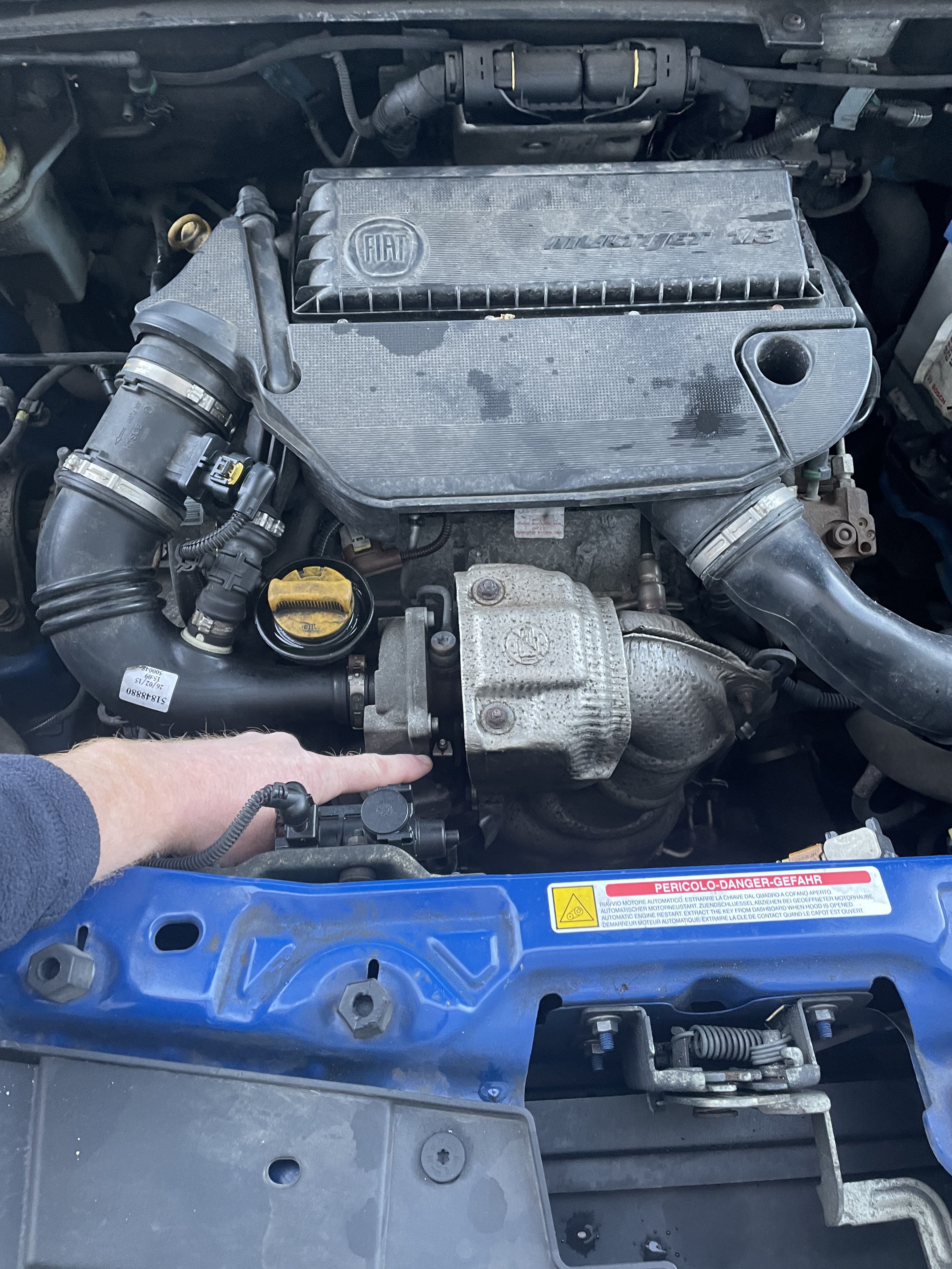

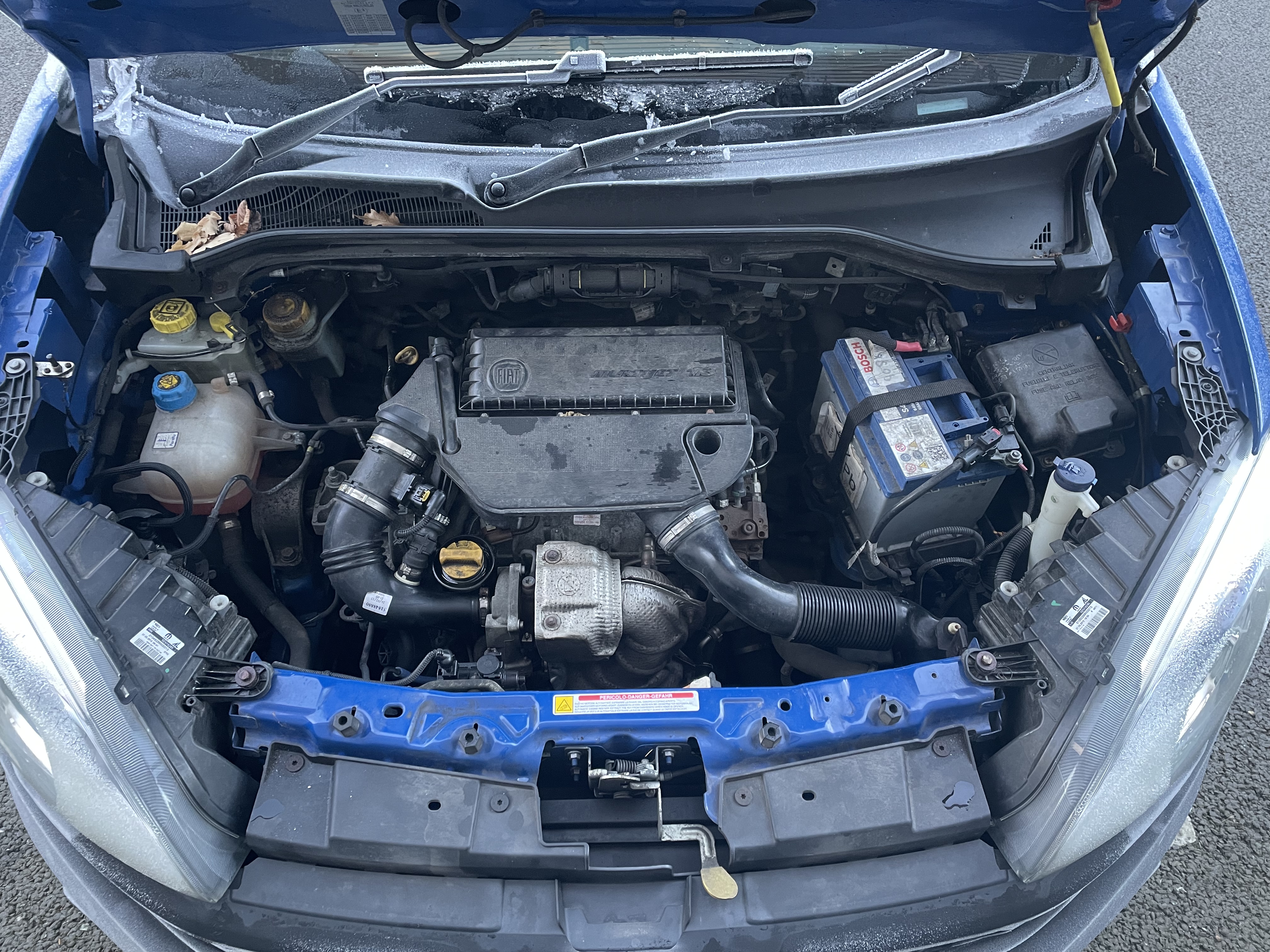

Any chance of an photo slightly wider angle? Just so i can pinpoint where the egr is exactly. I'm finding it quite difficult to be sure of the location on my 2018 Doblo 1.3 Multijet II 95. Thanks.
Hi Farjoh,
No problem at all, please see the attached photos.
As an update, I’ve had no further problems and the Doblo is running very well 😊
