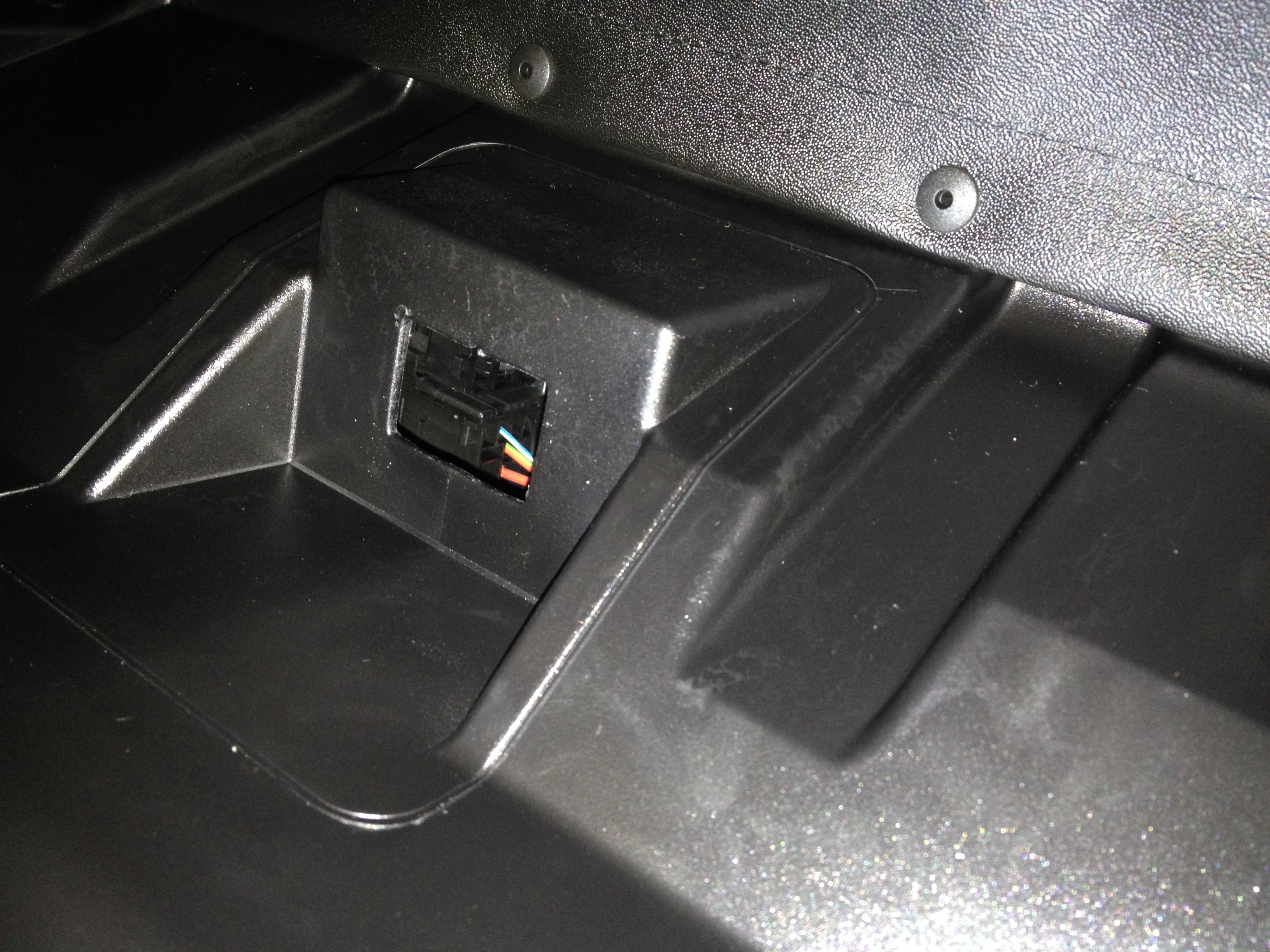

I have just taken delivery of a new Motor Home. It has the new double DIN radio but does not appear to have any means of connecting with my iPhone/iPad so I cannot play my own music. At the handover I was told there was a USB connector in the central lap top compartment, but I can't find it. The unit has Media button, but when I read the manual, this button only appears to work if the radio has Blue & Me.

Are you sure its not there, right at the back you'd nearly have to stick you're head in to plug anything in, my buddy has a little extension cable on his for that reason.
Stuck my head underneath but can't see any socket. There is a square hole where I suspect it should be mounted. I have taken a foto, if I can remember how to upload it!!
sorry the photo has turned out upside down

Wonder should it be there, maybe the coachbuiler forgot to put it back after doing their own wiring.

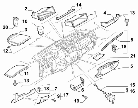

Cable - item 15: 51792639
Connector - item 16: 735550874

Your photo is correct for USB placement
Clearly items 15 & 16 are missing from yours, take it back.

OK, been back to the dealer. They say that hey thought it was there, it is on the Peugeot based Motor Homes.
They contacted the local Fiat Professional dealer who said the USB socket is only fitted with the Blue & Me option.

I have a 2012 Peugeot Boxer motorhome now and always wondered where the USB connection is, after looking at your pictures I have just looked at mine and its the same as yours, no USB just an oblong hole.
