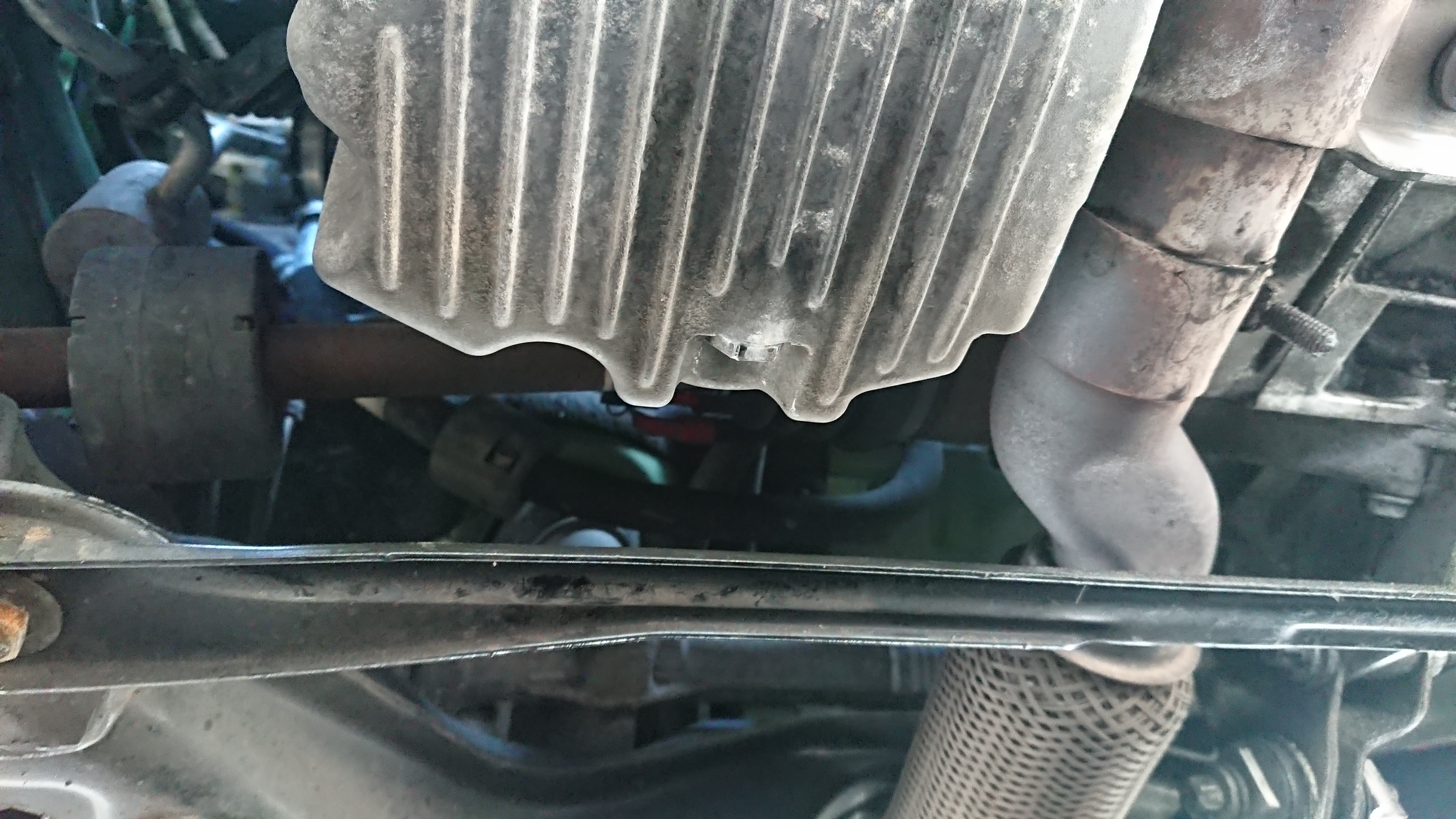

Firstly I attempted my oil change (after buying a 24mm socket to undo the oil filter housing). Got the car jacked up and the undertray off with relative ease to find the sump plug to be in a ridiculous place and blocked by a bar thing...
Looking at it from the front above and from the back of the car below;
My deep 17mm socket isn't quite deep enough to reach past the bar and adding an extension is creating too much play to turn it as its been done up with a rattle gun no doubt. my breaker bar is waay too long to get in there given the weird position of the sump plug.

Undo the bolt on one end of the bar and pull it back and out of the way, see my grande oil change video where I had to do the same.
Thanks for that, you're a star. I assumed the bar was under some sort of tension and if I unbolted it I wouldn't be able to get it back on again! :rolleyes:
