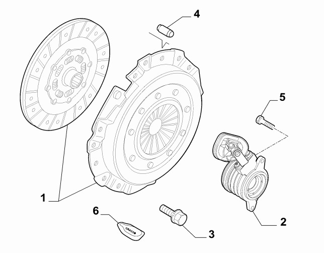

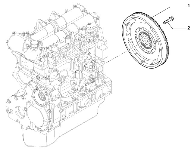

As promised
Picture of the flywheel from the ePer using your VIN & the clutch with internal combined bearing & slave cylinder.
Cheers

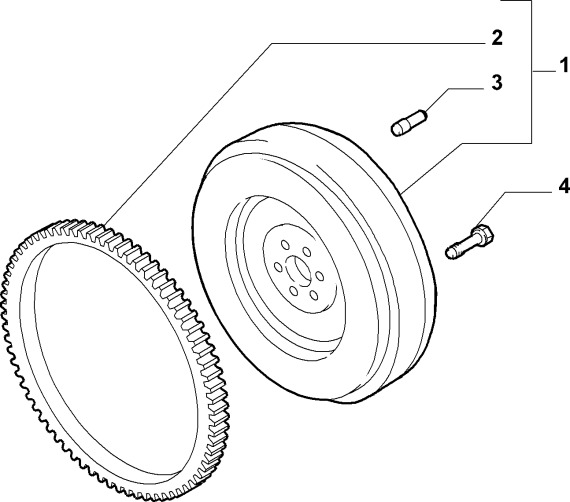

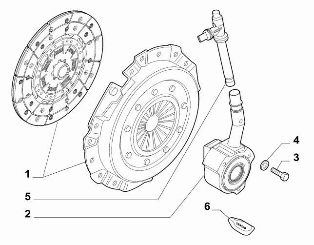

Hi Again
Here is a picture of the flywheel from the 3.0 liter & it does look like a DMF with the flexible center hub, :eek: although the description says nothing about it just "flywheel". the other is the clutch from 3.0 liter as well.
Cheers

I'm pretty sure if it's the 2.3 iveco engine/6spd box the flywheel is standard. If the Peugeot/ford 2.2 engine it is a duel mass flywheel
3.0 is duel mass
My old 2007 x250 2.3 was standard flywheel, the slave cyl will need replacing too
Thanks everyone for easing my mind. I'm confident my 2.3 has a single mass flywheel now and won't get a surprise when they pull it apart.
I believe Seasider has a Citreon and that would explain why he had a dual mass flywheel.
I bought a Valeo clutch and slave cylinder for $600AUD which is more reasonable than a $2k flywheel.
Rolopolo is correct your is DEFFO a "Solid" flywheel .... with mine being the 2.2 (Ford TDCi Transit Mk7 Engine) ..... Your being Iveco 2.3 it WILL have a SOLID FLYWHEEL
