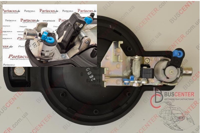

Hi all,my off side rear slide door handle is broken I bought one from Poland but after a long time trying to fit it I found the one they sent is different. When fitted you can only pull the handle about 10mm and the door opens unlike the original which pulls out 20mm, also the central locking fails to operate on that door. Studying the new and original mechanisms the black plastic actuating lever has a different end to it allowing the handle to travel further.
I wonder if the one sent is for a cargo without central locking perhaps?
Does any one know the correct Fiat part number for this handle as the Polish guy claims it correct please?
I bought one from Poland which was suppose to be the one for my 2007 Cargo SX but it was different as the handle would only pull out about 10 mm and the central locking didn't work my one has the blue clips can anyone help with a supplier please as I've lost money posing the duff one back to Poland please? IMG_2874.JPGIMG_3192.JPG
