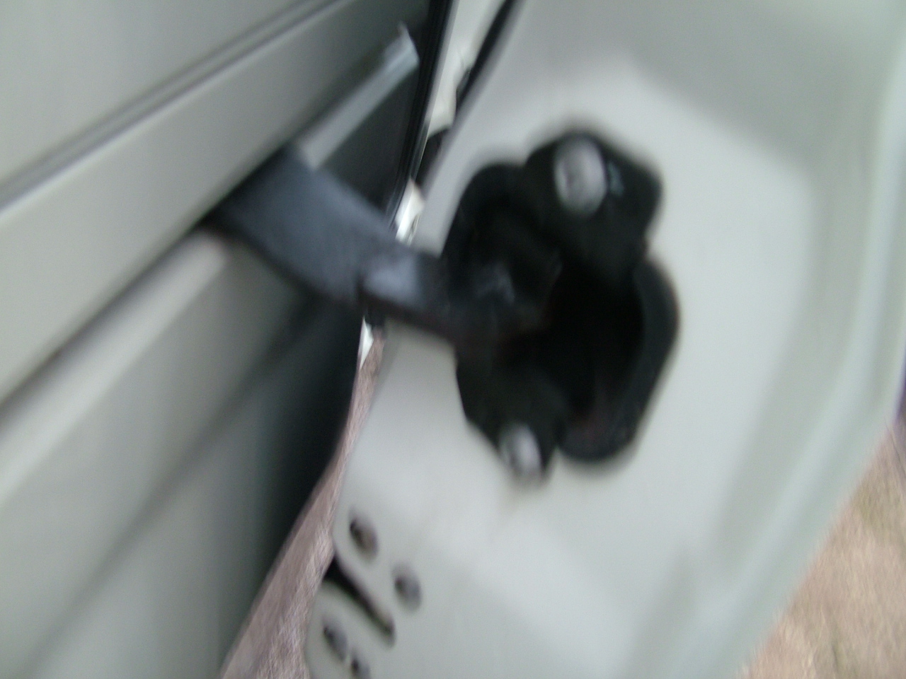

From memory the sliding roller brackets bolted to the doors are held on three 13 mm bolts in a groove, so if adjustment required it is usually a case of slackening the bolts enough to move the door in relation to the brackets to achieve alignment on one bracket at a time until perfection is obtained. :)
Note as mentioned at the beginning the doors are heavy , so do not take bolts right out, only slacken enough for adjustment.
If you are not happy to try this , most small garages should be more than competent to do the job for an hours labour I would have thought.
These are the adjustment points on a 2010 Doblo van o/s sliding door so should be fairly similar.

Just fitting the new parts is not the answer , as they cannot drag the door up into line, that is the reason they have broken in the first place.
You have to slacken the sliding hinge mounts and adjust upwards (not in or out) so that when you offer the door towards the parts you have just fitted they correctly slide into engagement.
Mark the original position of the sliders in case you make it worse so you can revert back, then start with the front bottom slider on the door and slacken, then move it so the door is raised a little on the slider then tighten and slide the door up to the new locators and see if it is going into a better position, do it a little at a time so you can see what difference you are making.
What has happened, is due to wear the door drops down so to align it the actual door needs to raise slightly.
If you slide the door almost to the closed point , you should be able to see the misalignment of those pins to the locator parts you have replaced, this will guide you as to what direction the door has to be raised.
