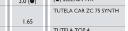

you will need a 12mm and 8mm hex from memory.
there's only just enough room as the robotics makes access slightly more difficult

I put 1.65l of 75W-80 as specified in my handbook in the transmission. Either API GL4 or GL5 is fine. Some have used the more readily available 75W-90
