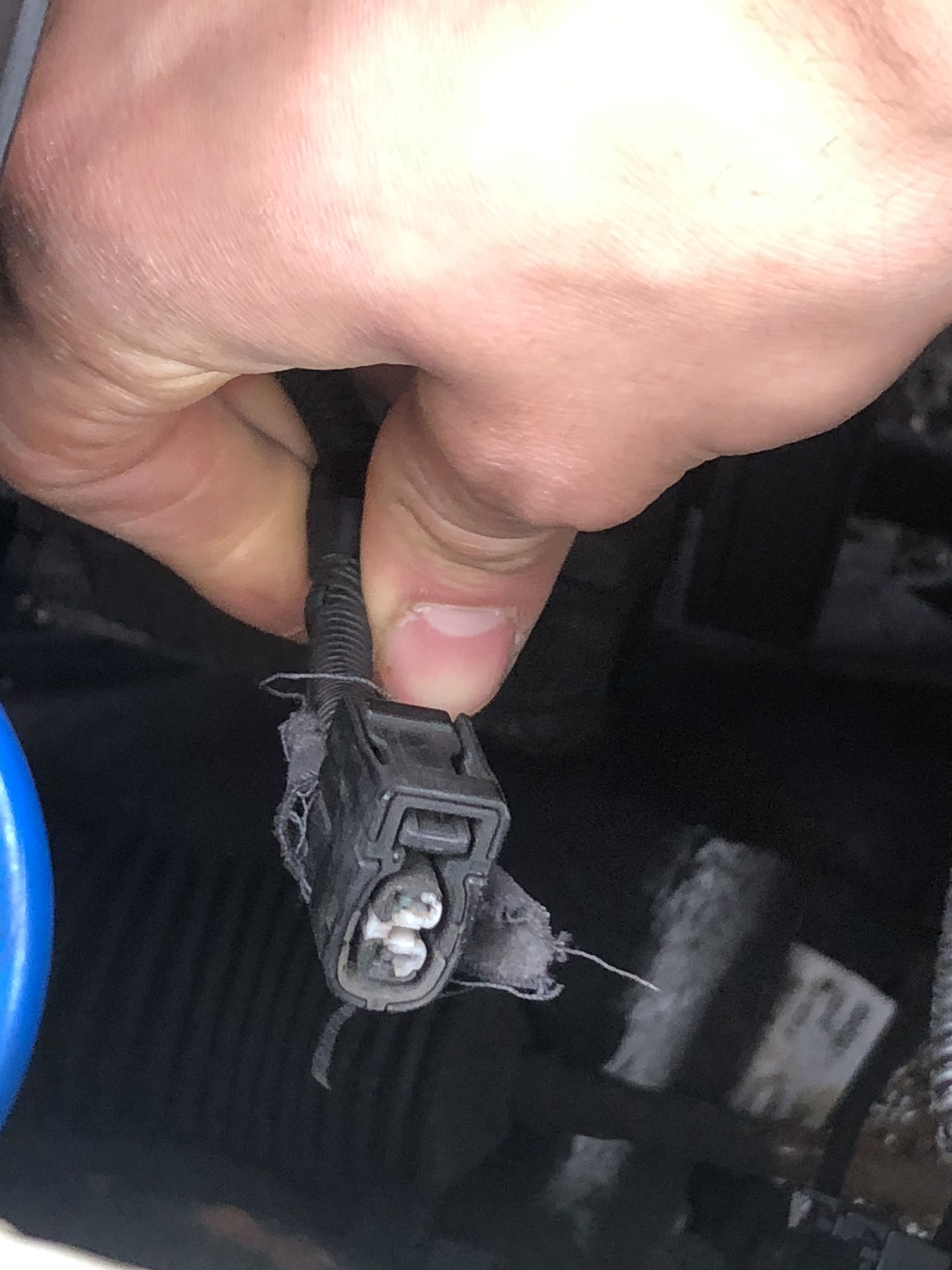

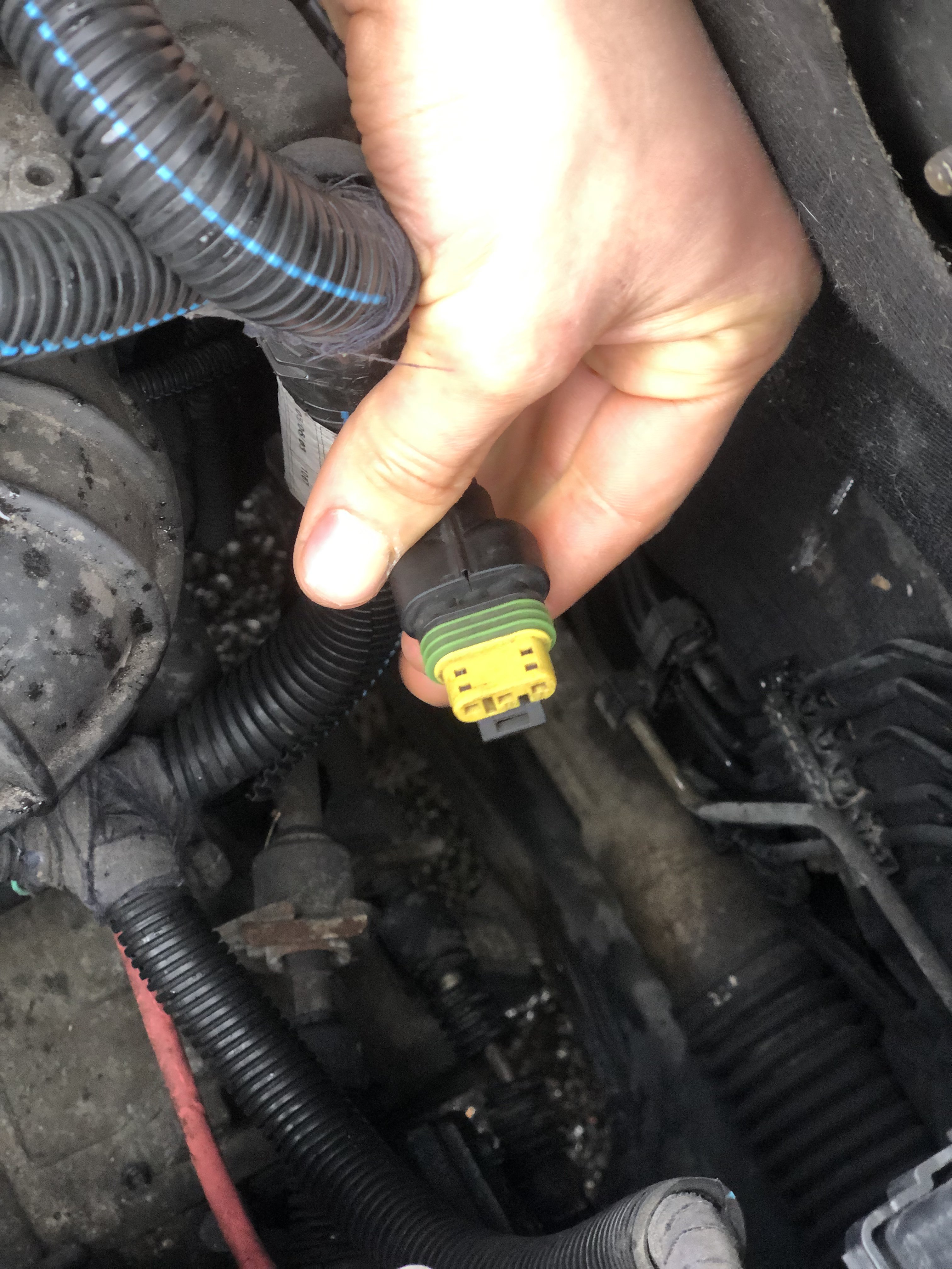

Hi. my son recently purchased a punto from a used car sales garage. The car had an MOT the before the purchase (carried out by the sellers MOT garage) and stopped working on the day after purchase.
Upon inspection by RAC the car has a failed cam belt with a previously failed cam belt tensioner and 2 unplugged sensors inside the engine (which we can only assume the garage unplugged). My question is does anyone know what the sensors are to, would they prevent any warning lights appearing?

As someone else pointed out there are no sensors that when unplugged would turn off an engine warning light. if anything unplugging things will cause problems. The engine warning light on an old MOT should have been a failure if it was recent, which would suggest they were able to turn it off. This could just be an old fault stored in the computer, and someone has plugged the car in and cleared the old fault.

Probably the belt just jumped a tooth when tensioner or waterpump bearing failed. Belts break very rarely. I'd guess that someone has saved a few coins by just changing just the belt, leaving waterpump and tensioner untouched.
I read the rac "report" the rac patrol didn't look at the belt but made a guess that it had broken and a guess that cause was tensioner failure.
So we just don't know for sure.
It is a shame no one has removed the upper belt cover to check the belt, it could be something else that's not an engine write off.
