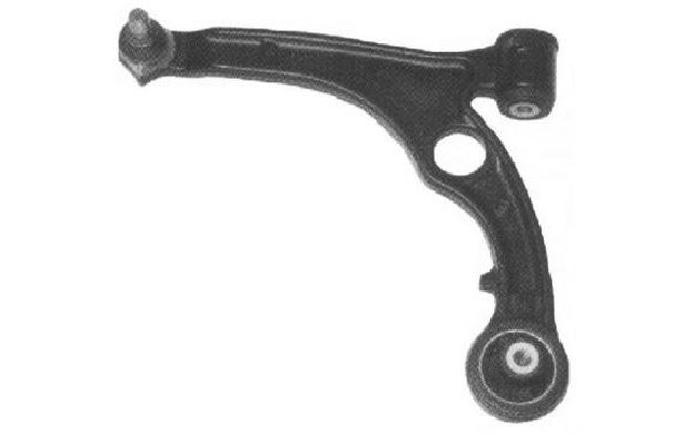

Hello, I have the same problem as Malm described, anybody already know the reason of this complaint?
Should have updated this post after solving this issue, sorry about that.
This was due to a worn part but not related to the shock absorber. I am unsure of the correct English name (direct translation from Swedish would give "linkage arm"). I believe it is called lower control arm in English.
Will try and find the garage receipt and see if there is any reference to a specific part number.
Thank you for the answer. See attachment, is this the part you are talking about?
Rgds Remcoe
Thanks, Changed also my right lower control arm. Also fixed the problem. :)
