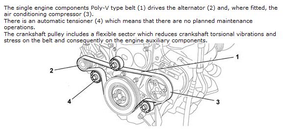

The alternator belt goes around several pulleys as in the diagram below. If your car doesn't have air conditioning, then it won't have pulley 3 in the diagram.
If you look down the left side (as viewed from the front of the car) you will be able to see if the belt is snapped, shredded or missing.
If it has shredded, there's a possibility that parts of it could have gone into the black plastic timing belt cover. If that has happened, it's possible that the timing belt may also have been damaged, which could have caused serious engine damage. Do not try to start the engine, or turn it over until you are sure that the alternator and timing belts are OK.

Yes, sounds like Aux' belt has been Killed in Action. Sitting around in the cold makes rubber a bit harder and less flexible... and on an old and brittle belt, it will be even worse. It probably tore "enough" to no longer tolerate the tensioner's tension...
The noises would be the remains getting shredded in the pulley's etc. It's quite tight between aux' belt and cam-belt though, so I'd be disappointed for you if the pieces found their way into or behind the cam-belt cover. When you have the lower wheel arch liner off, you should take the cam-belt cover off and have a look.
And... if your aux' belt (£15 part which you really ought to check at least once a year) could be in a condition to collapse, then I'm afraid for your cam-belt. How long/mileage has it been in there? Anyhow, make sure that's new/rubbery and with no visible damage or wear on the teeth.
Don't worry about the dashboard dramas... no juice (alternator would have been out of action) does strange things to the Stilo brains. It ought to come back when a new belt is on.
