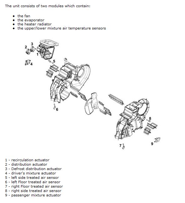

Hi all,
having the following problems with the vents/Climate. It was originally that I was unable to direct the air to the feet. I've tried the resets/get constant clicks from the dash etc. The reset does not complete sucessfully.
I;ve looked at everything I can find here on this. I spent a bit more time on it & found I can ONLY get hot air from the passenger side.
My question is: can someone tell me which Bosche motor controls what.
I think there are 2 each side (or is it 3 inc. recirc).
I've seen pictures on here, but my question is: which one controls what?
I've ordered a replacement motor (going cheap on ebay so giving it a punt), but do I have a problem with 2 (or more).
I also understand that it could be the white plastic rods/cogs, but having now found the hot-only sympton, I figured it was motor-related.
basically, the top one does....?
the bottom one does....?
many thanks, BB
According to eLEARN, there's 4 motors on the left and 1 on the right. According to ePER. they are not all the same.
I suspect the descriptions at 4 and 9 (driver's and passenger's) should be reversed for a RHD car.
