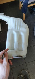

Removed the current one from the van and this is what it looks like

the pRT NUMBER was from eper using the vin numbers so id hope it is right
Well i'm afraid you can take it from me , it's not . The link i sent you was for the part number you quoted , and if you care to take a look yourself , you will clearly see that part number , in the second group of numbers just above the price . There will not be a second part with that part number , they are unique to only one part .
Now then , with that said i can clearly see , that my link is nothing like your picture . It does however look very similar to this one ;

Can i ask , what's wrong with your original . I'm guessing it leaks , can you not repair it .

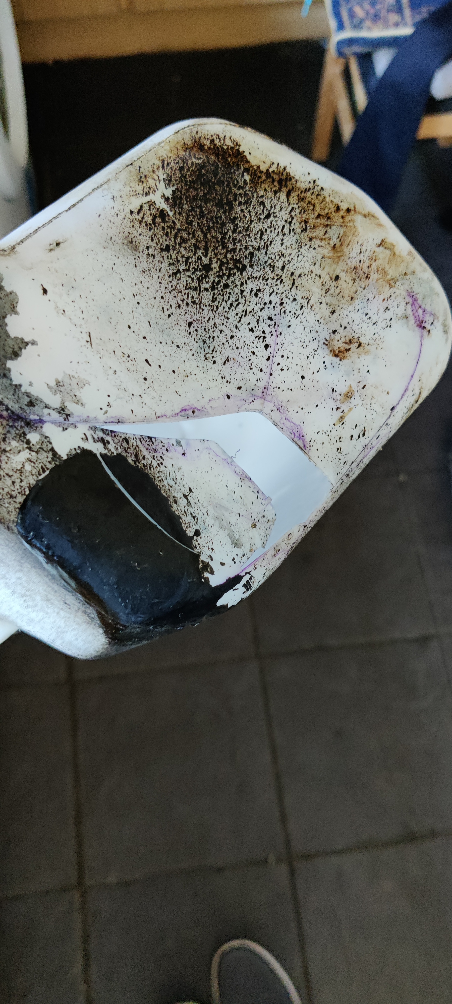

Unlikely it's 5 cracks in the bottom of it and not much chance of glueing it with what's it's made of
Yeah i see , pretty much what i figured . Plastic is difficult to glue at the best of time , that's why i learnt to plastic weld . That little skill , has saved me over two grand to date . I would never suggest this with any kind of consumption storage tank , as i don't know what harmful effects could result , however as it's a windscreen reservoir , it is possible to repair using another method i learnt last year . It is however a long and drawn out preparation process , and a serious issue could be access . You must have full access to all the damage at least on one side .
As it's an engine component , you must first thoroughly degrease the bottle , both inside and out , with a proprietary degreasing agent . I would not advise the use of gunk , which tends to foam (personally i use a product called marine clean) , it needs to be strong but none foaming , ideally bio degradable . Scrub the area on the outside , if need be with a fine pan scrubber . Use the green type , this will scratch , but don't worry . Try and get into the crack as much as you can , and flush the inside several times , allow the bottle to dry .
The next stage is a little tricky , as ideally a Dremel , or similar , would be a serious advantage . You need to open the crack out slightly , i use an engraving bit in my Dremel , but it can be done with a sharp craft knife . Just for christ sake , watch you fingers . Scrape the blade sideways along the crack , getting the point into the crack . Don't worry about finish , and most importantly , don't go all the way through . The object is to open the crack out slightly , and produce a key for the glue to grip at the same time , along with a larger glue area . Now wash thoroughly again , but use washing up liquid this time . Again allow to dry thoroughly , for at least 24 hours , more if possible .
Now using a super glue (there are many brands to choose from) fill the crack , and follow immediately with either baking soda , or bicarbonate of soda . Make sure you get this powder into the crack , and it soaks into the glue , apply more glue is necessary .
I'll be honest here , it will look a mess .
Once dry , the surface will be left hard and uneven , which is difficult , though not impossible to sand , but you will need a Dremel . So take your time , and try to produce a tidy join . It really is a case of what you see , is what you've got , however don't forget the speed a super glue takes to cure . Leave for at least 12 hours , however i would recommend at least 48 , perhaps even several days if possible before getting it wet .
It is not a difficult process , but is time consuming . I have used this method to repair all manner of things , from freezer baskets , to a clutch bracket on my van , though i will admit , i reinforced the latter . At present i'm repairing thin plastic trim from the van . It's far too thin to use a conventional plastic welding process .
One if the broken bits is cracked on nearly all sides so had no strength left so probably won't even be able to attempt that as it folds inside 5he 5ank if you as much as tip it upside down
It's Allmost like its Been hit by a hammer
Yes indeed , it is in a bit of a state . It does look like it's being hit with a hammer , and there even looks to be a bit missing as well . Interesting it's received such a blow , as normally these things are tucked outta the way . Mine is on the nearside inner wing , which if i'm right , is probably where your battery lives . The most likely cause is probably down to the fluid freezing , but to reach the lower parts like this , it would have been completely . My guess would be , it was pure water . I've never suffered a total freeze in 45 years , in any of my cars , but i do have a very strong washer mix , which i maintain , summer or winter . Anyway you seem to have formulated a plan , so i'll back on outta here . As i said earlier , i'm extremely busy with my own van . I've got a major job running , with 2 other , not so major jobs running in the wings . And paint , but i've had to shelve that recently , due to the heat . I'm slowly managing to close pages down on the computer , down to 9 now .
One final comment on the water bottle though , it could still be repaired . The freezer basket i repaired was not quite in such a bad state , but it did have bits hanging off . And of course , being made from flimsy brittle plastic , it also had no strength . You really had to be careful just picking it up , else you could cause even more damage .
The part was irreplaceable , so the only course of action was to attempt a repair , which though successful , was very time consuming . I could only work in one area at a time , due to the properties of the glue , and secure the rest with masking tape . That was over a year ago , and it's back in use , with no signs of the repair breaking down .
One final comment on the water bottle , in that it could still be repaired . The freezer basket i repaired was not quite in such a bad state , but it did have bits hanging off . And of course , being made from flimsy plastic , it also had no strength . You really had to be careful just picking it up , else you could cause even more damage .

and shouldnt have frozen as its broken in the last weeks weeks so no chance of having frozen
theres also all the cracks where you can see the purple staining from the screen washer that was poured in when the leak was found

I'm at a loss as to how your bottle suffered such damage , because these things don't normally break on their own , still what's done , is done .
