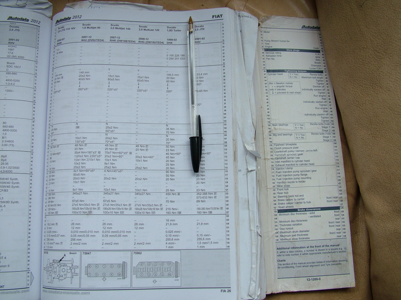

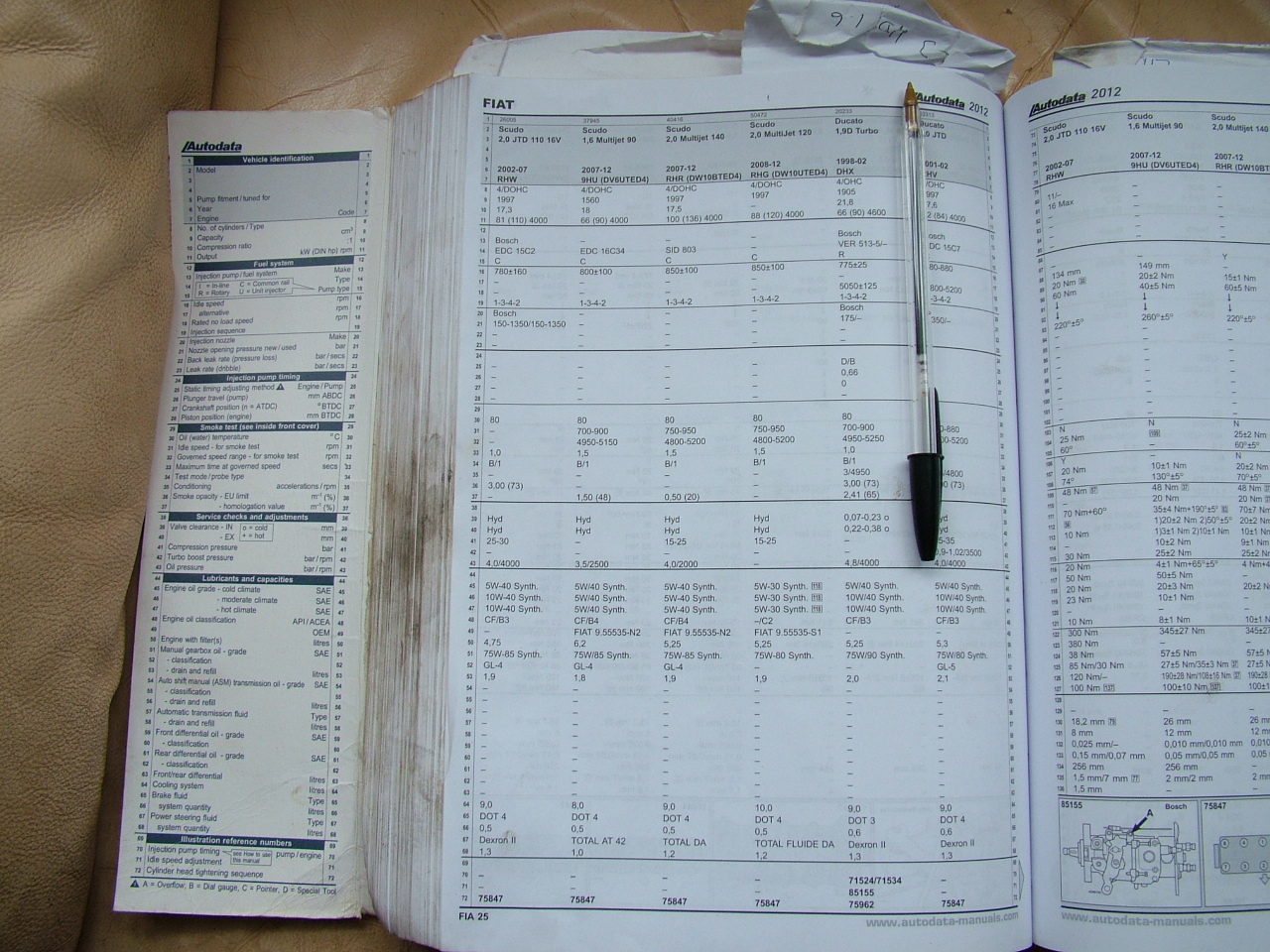

Sorry my timing belt book only goes back to the one just after yours. Your vehicle was probably one of the last DHX versions in 1999 but registered 2000 My Auto Data Technical Service Manual may be of general use for torque settings oils etc. I also found this on the internet about what vehicles used your engine seies numberDHX. Apart from that I am sure other Forum members can help further.

Much appreciated
so looking at that am i right in saying if the timing marker is set then the intake value on piston 1 should be closed about to open
