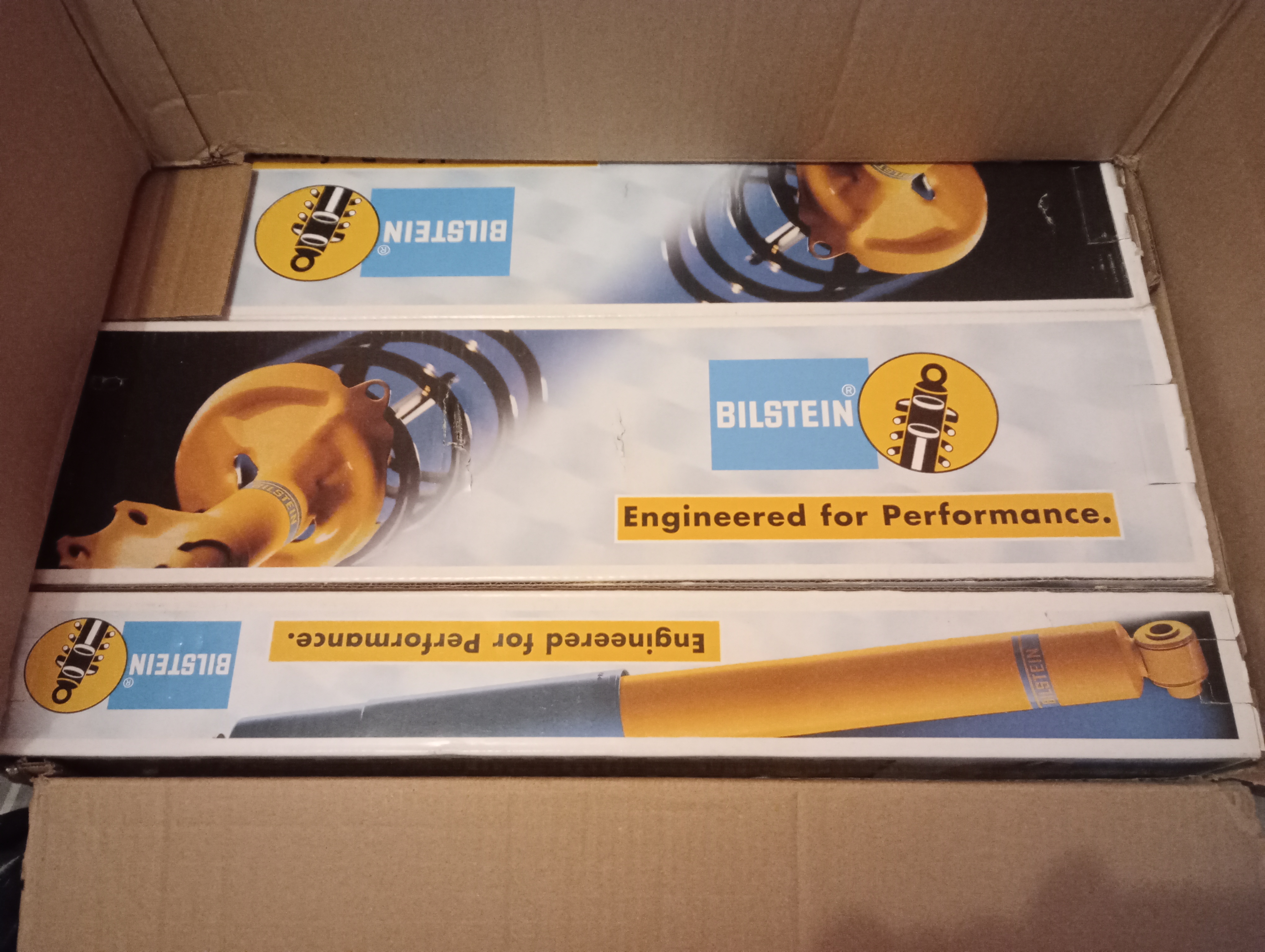

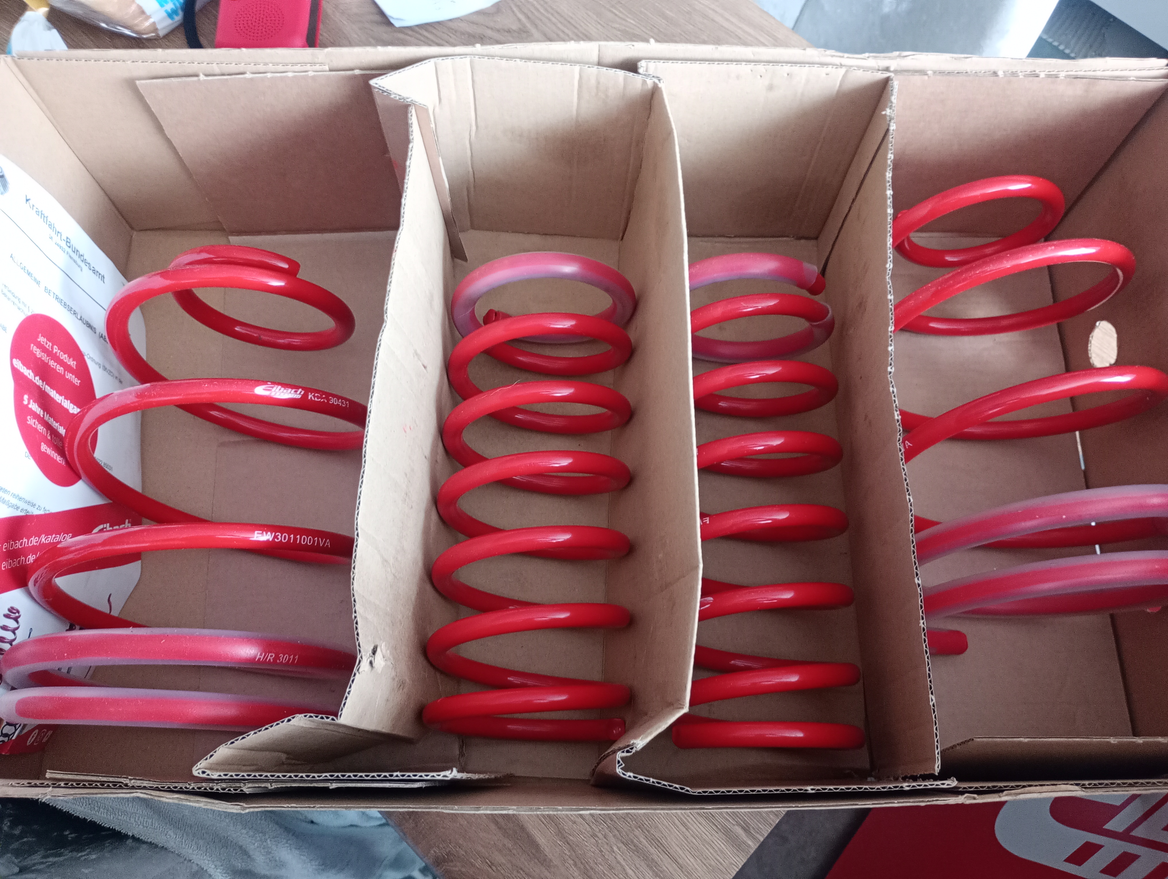

I got a very good deal on eBay a few days ago & they have just arrived this afternoon, it's a Bilstein B12 pro kit for a Seicento with Bilstein B6 performance dampers & Eibach 30mm lowering springs
So I looked up the retail cost of this kit & it is anywhere between £600-£850 depending on where you buy & what offers are on etc, this particular kit was on an eBay auction as the seller had purchased it for motorsport use but never used it so it's still new in the box & I ended up paying the total grand sum of £337 including delivery which is really cheap for this kit so I'm a very happy man 😁 also I joined the Facebook Cinquecento & Seicento owners group & managed to secure myself a cheap Seicento sunroof cover which are as rare as hens teeth for just £25 plus postage as it needs a good clean but that's still dirt cheap 😁
What a bargain! 👍🏻

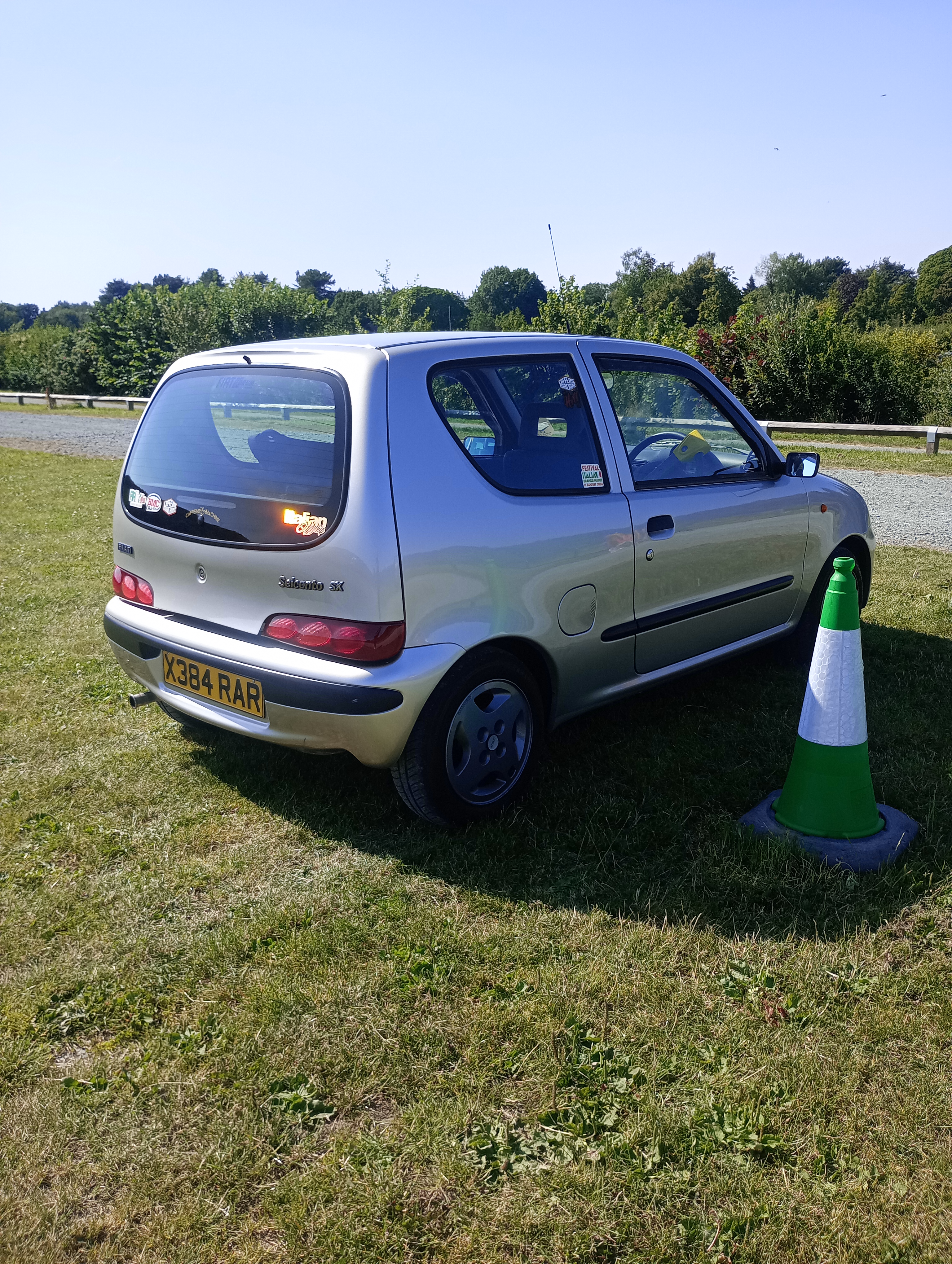

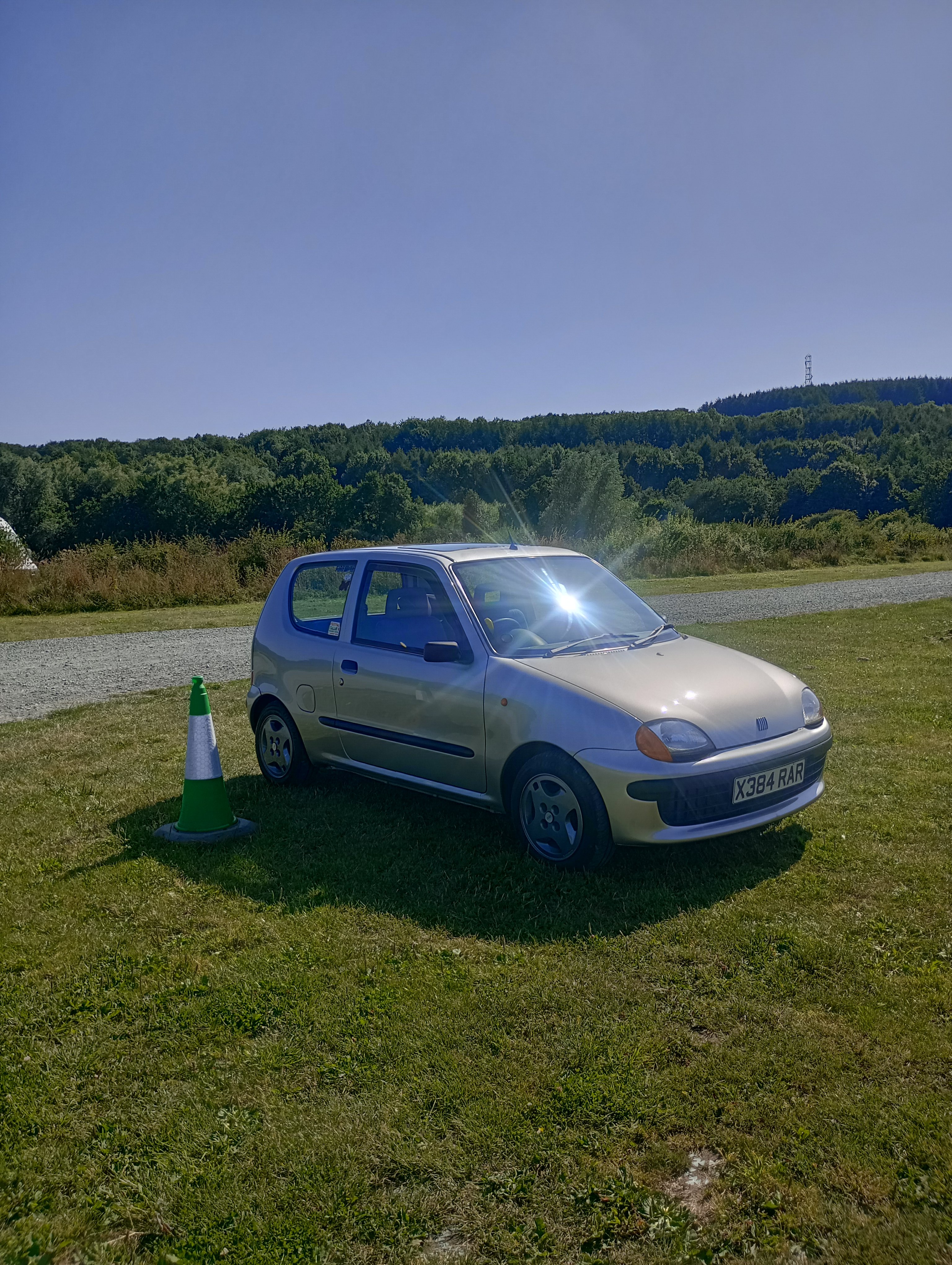

Looking good, although you could've moved the green traffic cone.....
VW would fit those "efficient grip" tyres to their UP! GTI cars - absolutely terrible. Had a Citroen Cactus 10 years ago and they were fitted from the factory - awful. Poor in wet weather, weren't that grippy on dry roads and I seem to remember they were quite noisy too.
I didn't think about the cone at the time 😂 it was a public car park in the Delemere forest. I had the Duragrips on my 2018 panda from the factory & they were really good but these ones are absolutely awful even in dry conditions, they'll be banished after the alignments done Monday morning for hopefully much better tyres
