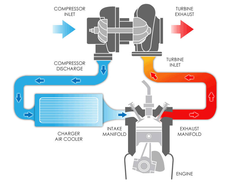

Any of the blue area , ( the area marked "compressor inlet" is ambient air pressure - the air you breathe freely)
anything in blue beyond the turbo (if the turbo is boosting/on boost **) is pressurised air, so the slightest airleak here will result in squeal/whistle
** i.e. when you're pushing the acc. pedal after 2100rpm ish

Thank you for informative reply will try and see if I can suss it so maybe not a bad turbo just a leak somewhere

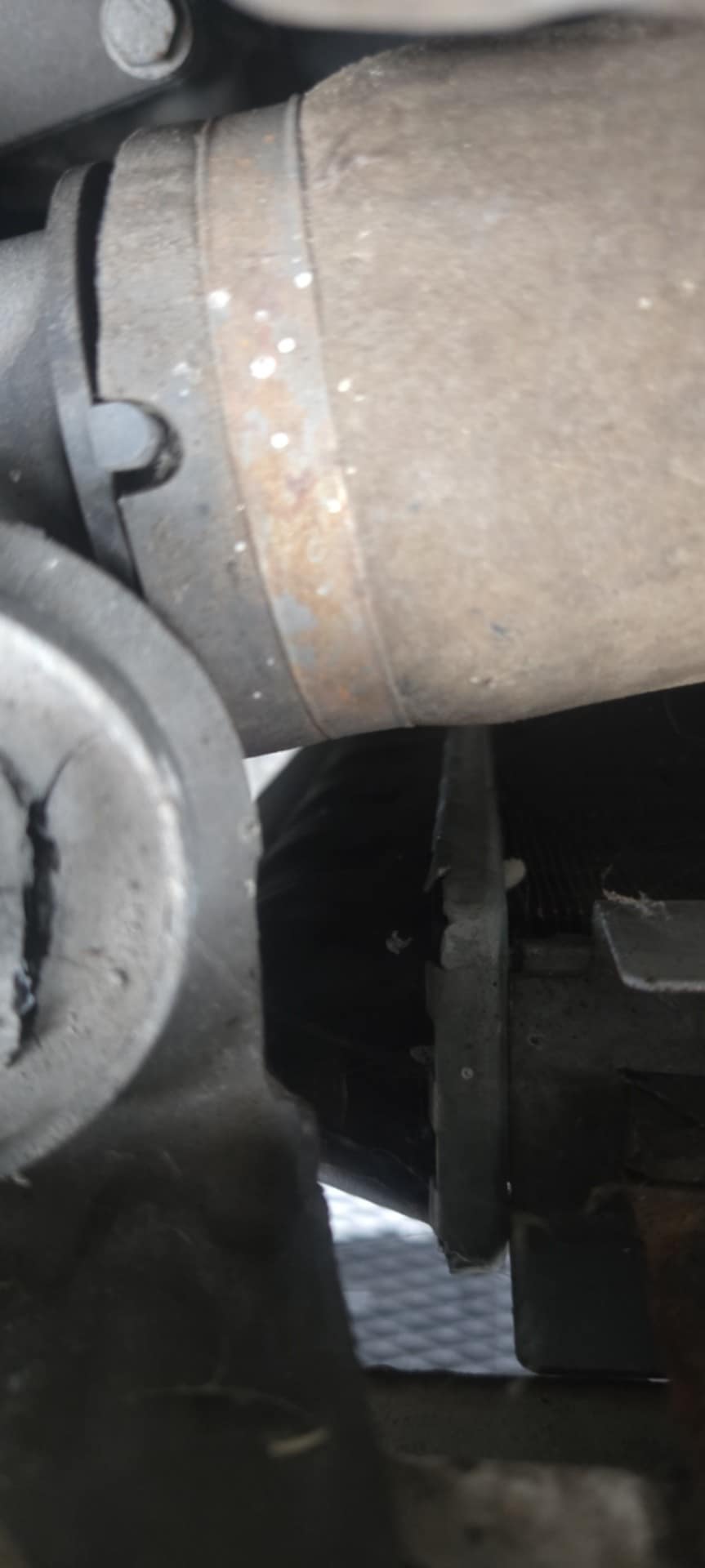

Hi can't see anything noticeable the only one thats not flush is pipe going to intercooler plastic but dont think that will be it all others look secure

Every connection or item in blue in the diagram I posted

Did you see the photo of the small gap i posted earlier thanks.
Hose does not have to be "flush " the clamp band makes the seal
