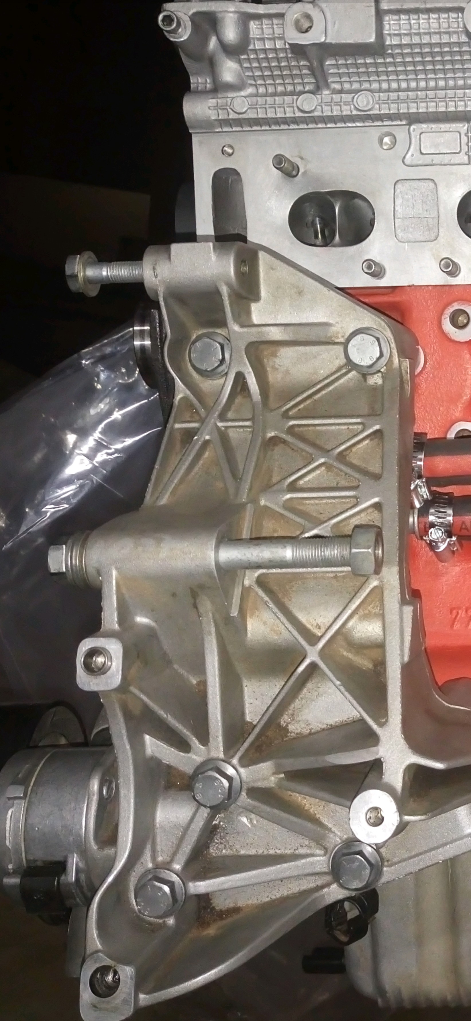

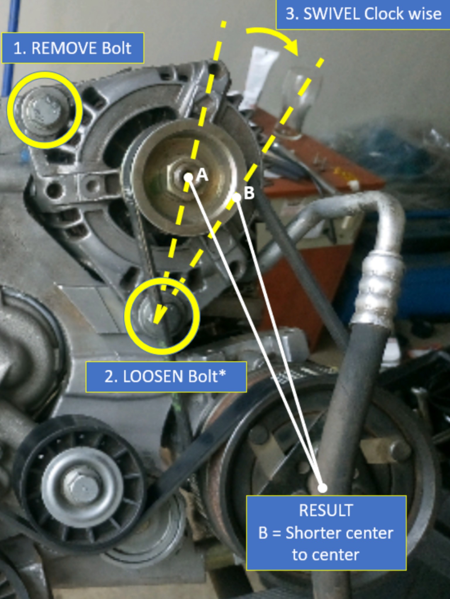

The reason why the Alternator will not move if you just loosen the bolts can be seen in the picture.
So follow the instructions I have just compiled.
Note! Be careful when wedging the Alternator back up so you can insert the bolt, not to damage the thread on the bolt.

I remember changing a belt on something(?) once where one alternator bolt had to come out so that the alternator could rotate around the other, similar to Abarth's photos.
Apart from the alternator still wouldn't rotate (a cup of tea and two Mr Kipling Bakewell tarts made me remember I hadn't loosened the bottom bolt after my success in removing the top bolt.. :D ) the biggest faff was actually removing the top bolt.
It was just long enough to foul on the chassis cross-member.. Ahhhh Ahhhh and in the end the only way to remove it was to remove the engine mount and dangle the motor down on a trolley jack a couple of inches, so the bolt could come out under the cross member.
After that, it was quite simple... :D So.. just dismantle as much of the car as needed... it's easier in the long run, even if it takes you six weeks instead of 6 minutes.
So, 2 weeks later and I've now got the Alternator belt on :D. A complete bitch of a job, and only succeeded by following Abarth L's guide. Fortunately I had a handy Screwfix tool for pivoting the Alternator back into place :)
Of course it wasn't straightforward :mad:, whilst the top bolt came out easily, the bottom one was a nut and bolt and once loosened wouldn't tighten up. I spent most of the morning trying to get in behind the Alternator with a variety of sockets and box spanners to hold it but all to no avail.

No Worries, I did see your post and the one about using a ‘tool’ to wedge the alternator back into place, which is exactly the way to go.
However I didn’t get any joy out of the ‘Cut down Broom Stick’ at all :eek:, so I used a Screwfix https://www.screwfix.com/p/roughneck-17lb-post-hole-digger/62496 which fits snugly into the top of the Alternator, and with a gentle push eases the alignment of the top hole/fixing back into place :D.
