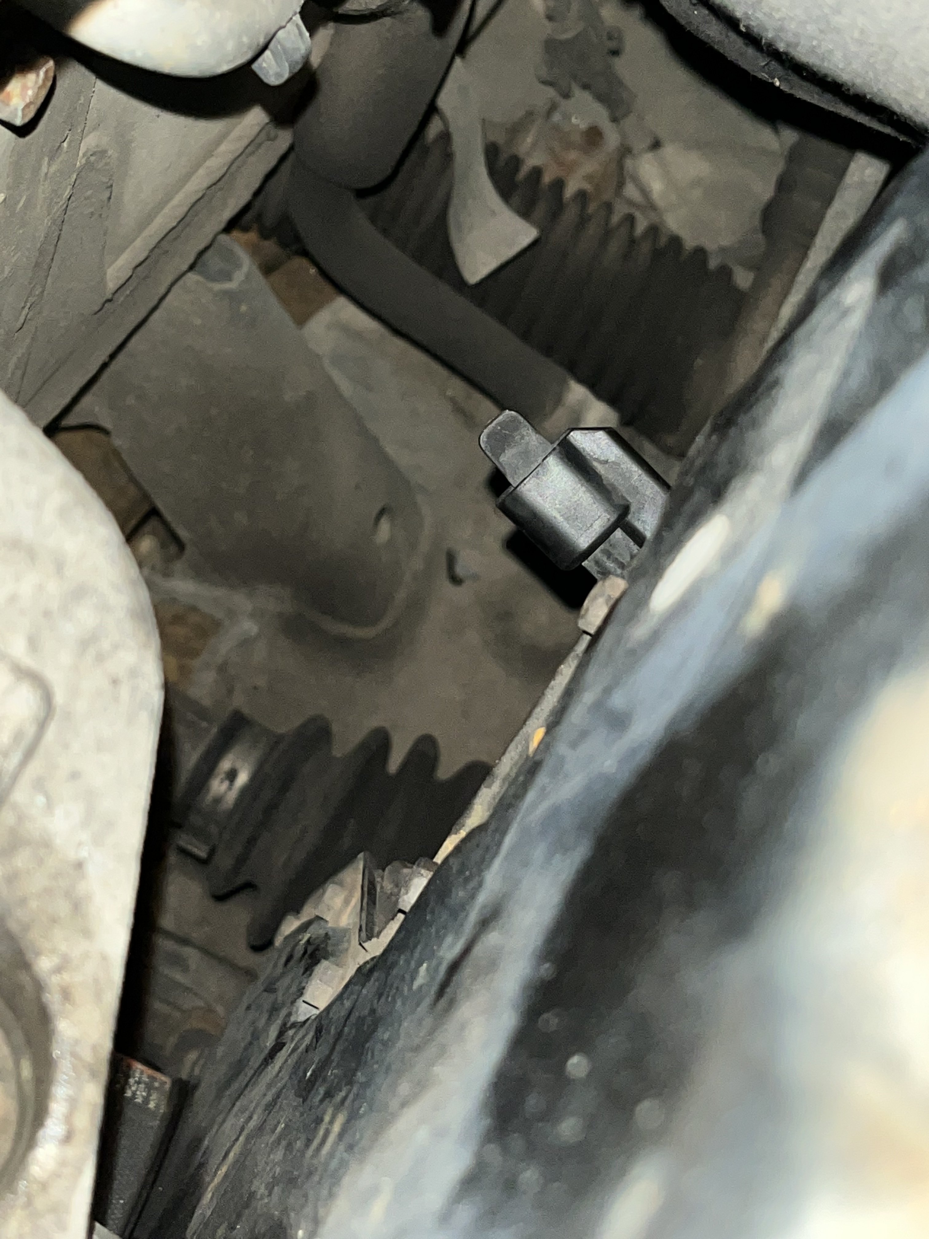

Hi again. Just having a fiddle about and found this lead/plug at the back left hand side of the engine any ideas as it’s not plugged in to anything nor can I find anything for it to plug in to.
If no obvious connecting point in reach of cable, then possibly for an option that is not fitted. Oil level indicator for example.
