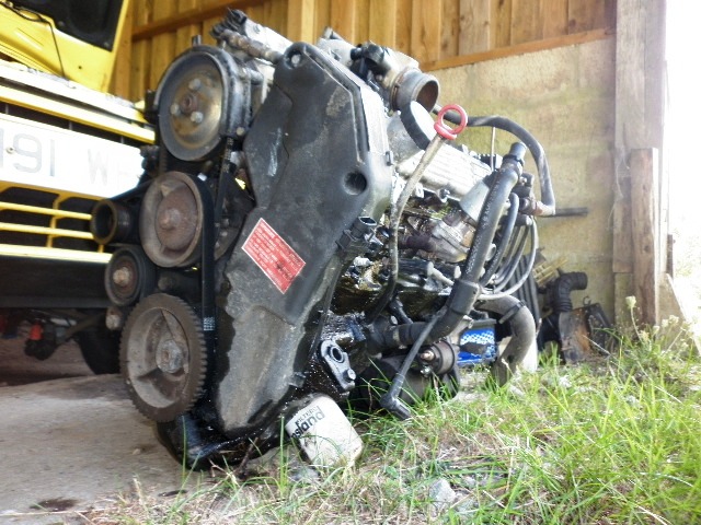

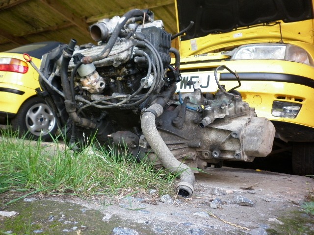

What about the 1581 engine from Punto 90ELX? I have one available right now - i could bring it in my suitcase to Goa for my Xmas holiday! This is basically a long-stroke 128/Uno engine, with MPI, and in the Punto that Uno-type block is coupled to a Punto-type gearbox which has a different bellhousing.

That looks like a lampredi block, as fitted to the uno turbo / punto GT yes that kind of block will fit but you need the uno turbo mounts and gearbox / half shafts...

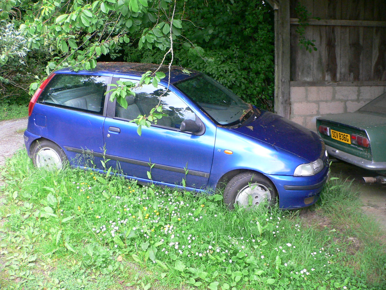

Great this thread has come back to life, as my Uno is now SORNd, I have all the bits for a full sups steering and brake o/haul and am plotting a mk.2 Punto ELX85/Sporting engine and Punto-type gearbox.
The attraction of the latter wd be fuel consumption I can live with for the next 6yrs say, until all-electric really comes in. In a Punto it's nom 45mpg combined - in a lightweight Uno that shd be 50mpg at least. But that means the full MPI, CPU etc and all the faff of rewiring, coding etc. It also means settling for 80bhp, softer in fact than the mk.1 ELX85/Sporting. That shd still be interesting, as the standard 70SX is v lively already, but only gets 35mpg at best.
But it's interesting that a carb on a ELX75 motor (like my old blue one) liberates so much power, without the electronic complications. I already have a brand new 34/34DMTR, so that cd be a quick interim installation, jetted up as advised by Hyperdart above.
So thanks - great thread.
Yes, but easier than that - it's like that fitted to ordinary pre-FIRE Unos. With that engine coupled to a Punto 90ELX gearbox, your Uno/FIRE gearbox mounts (2) and halfshafts that you already have (I think?) will do, and you only need to get the one Uno/Lampredi engine mount.
But the Punto box, intended for 14" wheels, will give rather low gearing in a Uno with 13" wheels.
You just need a mount on the Right hand side on the inner mudguard, for which you should have holes pre threaded in your uno chassis....
I've only seen the lampredis as fitted on the 55/60 pre 89 uno....whilst the one in the picture seems to have the same intake manifold as the 1372 turbo...
