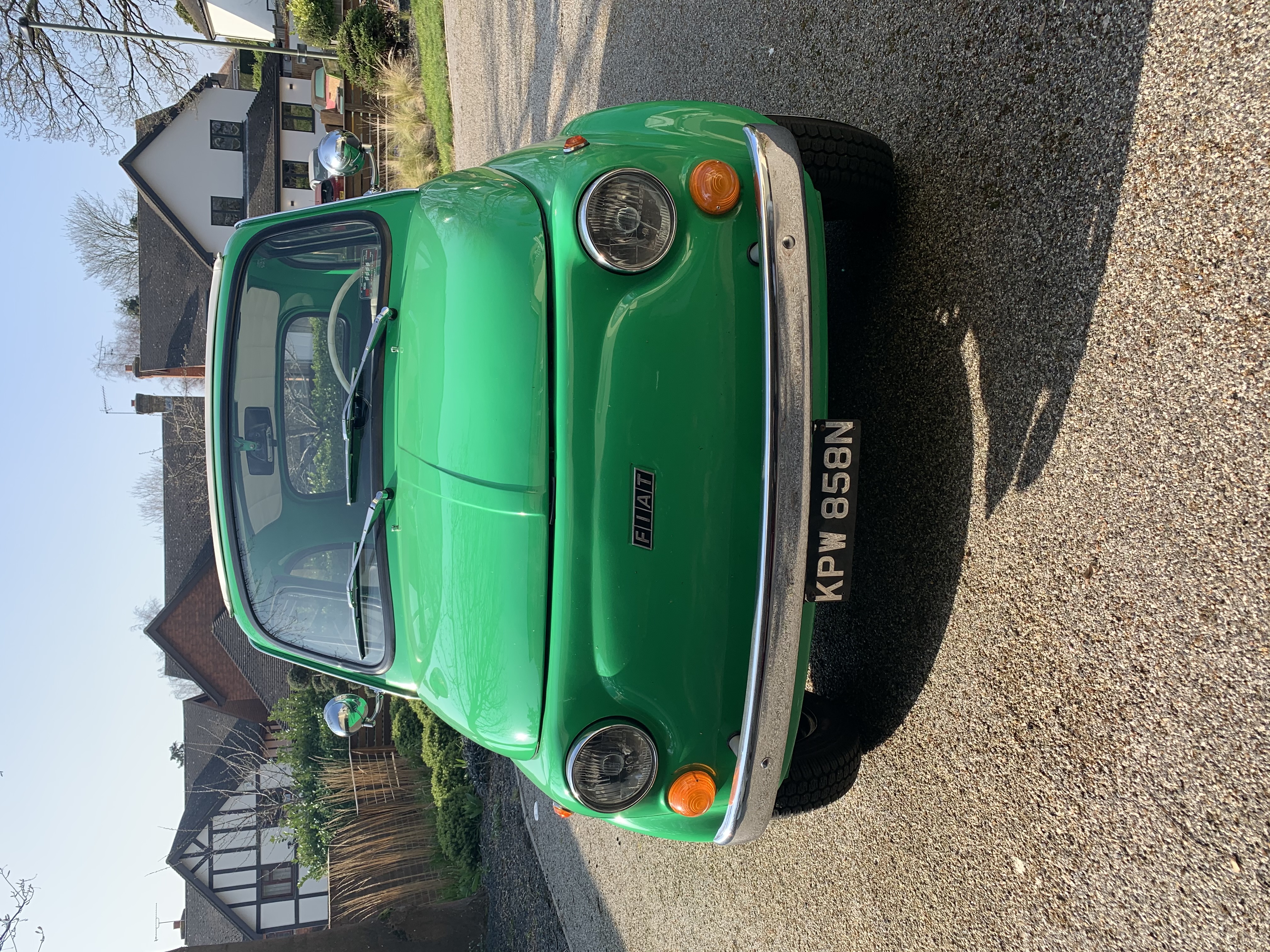

I finally got round to fitting the new RHD headlights (courtesy of Motobambino) , complete with built-in sidelights which meant that I had to adjust the wiring. I left the 5/21W bulbs in place for indicators and changed the lenses for orange ones.
(the plate on the front is to mount a plaque for the Tour of Kent next weekend)
aqms4XPgN0KPfQbVoaEqRx1UHkCOOoKccoWP6huLM1Y4V4NfvdzZAVzQCVcRh2AttlAO356YVdxKkhSVBsXTyKm2mME2nlzohJ15QBVeRXXVj8llSd4_K-XoHtdO0FhOdbPs7m0XdaQ=w2400
You will NEED to leave the double-filament bubs in the indicator lamps---the side lamps on the 500s are made to have both a side lamp AND an indicator lamp in them--if you fit a single filament bulb it will iether not work or work at double speed! Guess how I know?
