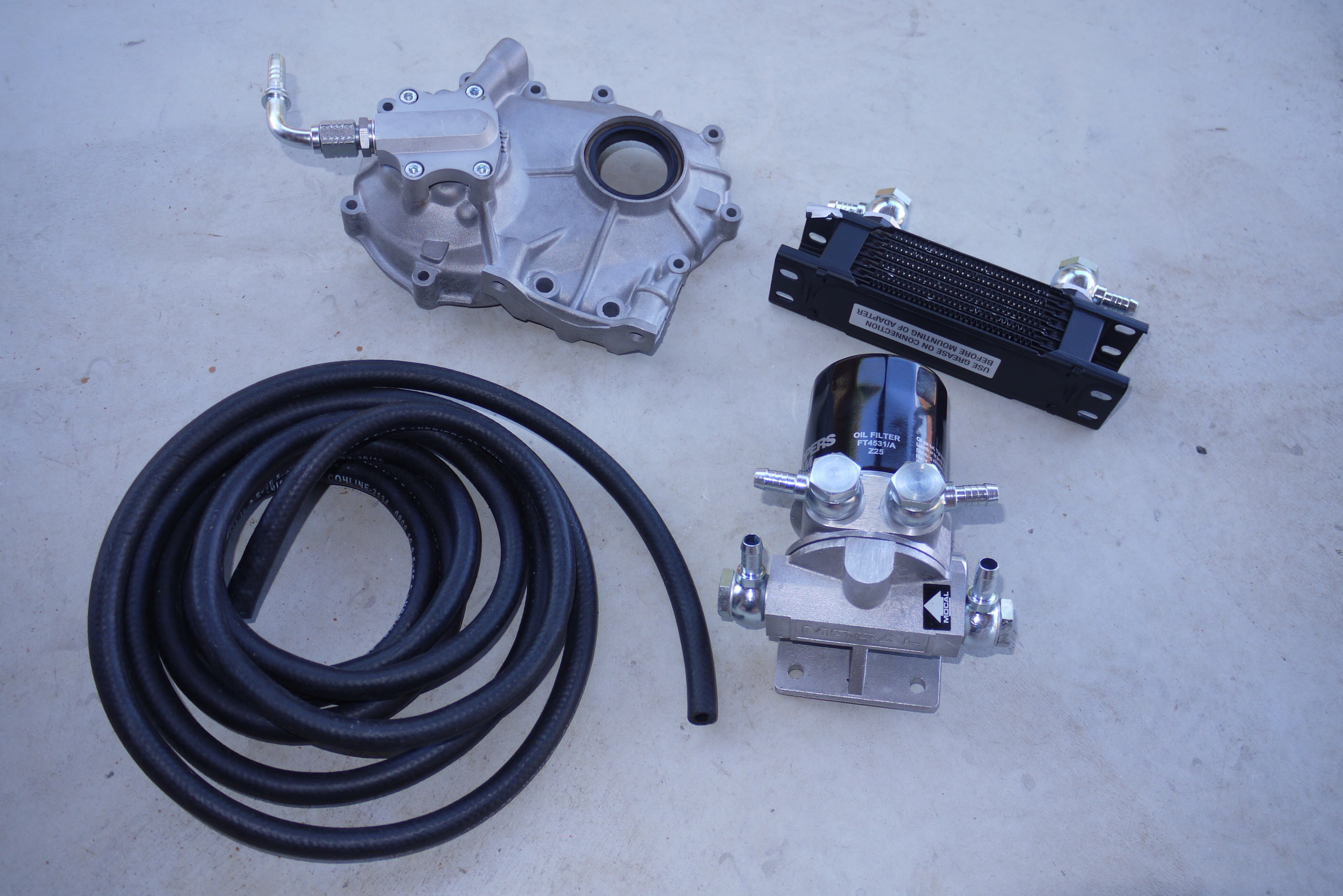

Meanwhile I have ordered and recieved an oil filter/cooler setup from another supplier. I've included a bunch of pics below. I opted for the version that has a thermosat, so the oil cooling only kicks in when needed. The filter/themostat unit is also "remote" so unlike the Nanni kit the filter can be mounted anywhere in the engine bay, rather than as a fixed item on the front of the timing cover where the oil take-off is. I'm yet to see if this is an advantage but I guess it must be good to reduce the load on the bolts which hold the oil take-off to the timing cover?

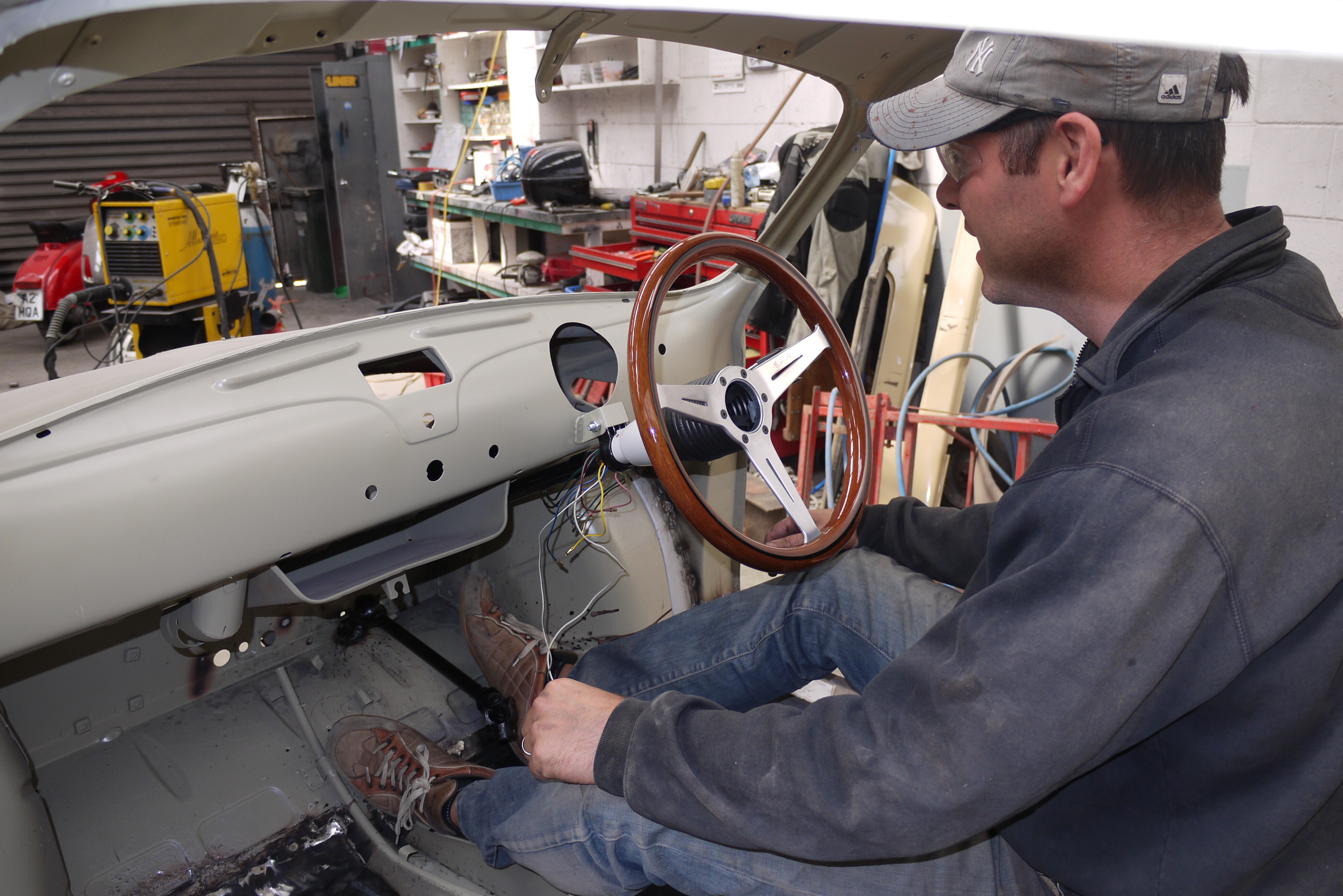

Meanwhile, work has gone well matching the steering column with the steering rack - I couldn't resist a mock "drive" of the car in the workshop! Just a shame the real thing is at least 9 months away!

I can see and understand your logic regarding having a remote oil filter--who did you buy it from in the end?--it certainly looks the dogs dangly bits! I had a good old think regarding the problem people seem to be having with the 4 ltr sumps--have a look on the relevant page--keep up the good work(y)
Hi guys. I bought the whole setup as a kit from axel gerstl in Germany www.fiat500126.com
The filter housing and thermostat housing are indeed made by mocal, you can buy them online at http://www.thinkauto.com/
The complete kits are not cheap, but if you add up buying the parts separately, and then having to machine a nice takeoff housing from billet alloy, then, for me at least, it was simpler to go with one made by the pro's than to fabricate myself. It frees up time to get on with stuff I Have no choice but to do on my own, like figuring the best way to get a decent looking, safe aand functional steering column to match the 126 steering rack.

Hey Roger - if I just want to fit a proper oil filter to the engine, where do I return the oil ?
For that matter, where do you return it if you are using a cooler ?
Chris
The sandwich plate he is using has a oil feed and return for the cooler so when the plate is closed no oil flows through the cooler and then when it pops open the oil flows through the cooler, back down the pipe and through the oil filter (or is it filter and then cooler, i forget).
Chris,
I will let Roger be the expert, but I have looked into this and I believe you return the oil to one of the two oil passages that are blocked with allen screws. One just by the distributor or one just above and to the right of the oil pump.
John
Hi guys, I'll post up some more pics of the steering rack and column solution once I am sure it all works as it should. It's very straightforward really. At the moment I am just looking at how best to fabricate a "hanger" to hold the upper steering column in place. Lots of options, but I want it to look good without looking too bling. I'm trying to follow the asthetic which says "This is a budget car - how would fiat have done it?" At the moment that includes using a cut down portion of the "hanger" from the 126. I know it is possible to use the whole 126 setup, but that means having 126 incicator stalks etc and a big ugly steering lock with plastic cover. Not my taste.
As for the oil filter return Chris, it goes into the block via the gallery closest to the timing cover. If you look closely at the fiat oil flow diagrams you'll see that oil goes through the pump and is squirted out onto the end of the camshaft. The camshaft "flange" has two holes in it which match up as the cam turns with a gallery that leads down to the front of the crank, from whence it then flows through to the standard centrifugal oil "filter" and so on from there through the engine. The gallery you put the oil line return into is just the bore created when fiat have drilled into the cases to make the Cam-Crank gallery.
The modified pump has it's factory outlet blocked to force it to feed oil through the new outlet, so by using this gallery you're simply returning the oil to the point where the pump would have put it in before modification.
Phew - I hope that kinda makes sense!
Oh yeah, and the sandwhich plate I am using does indeed have a thermostat. I don't have it to hand right now, but I'm pretty sure it flows through the cooler before the filter when the thermostat is open.
Cheers Roger

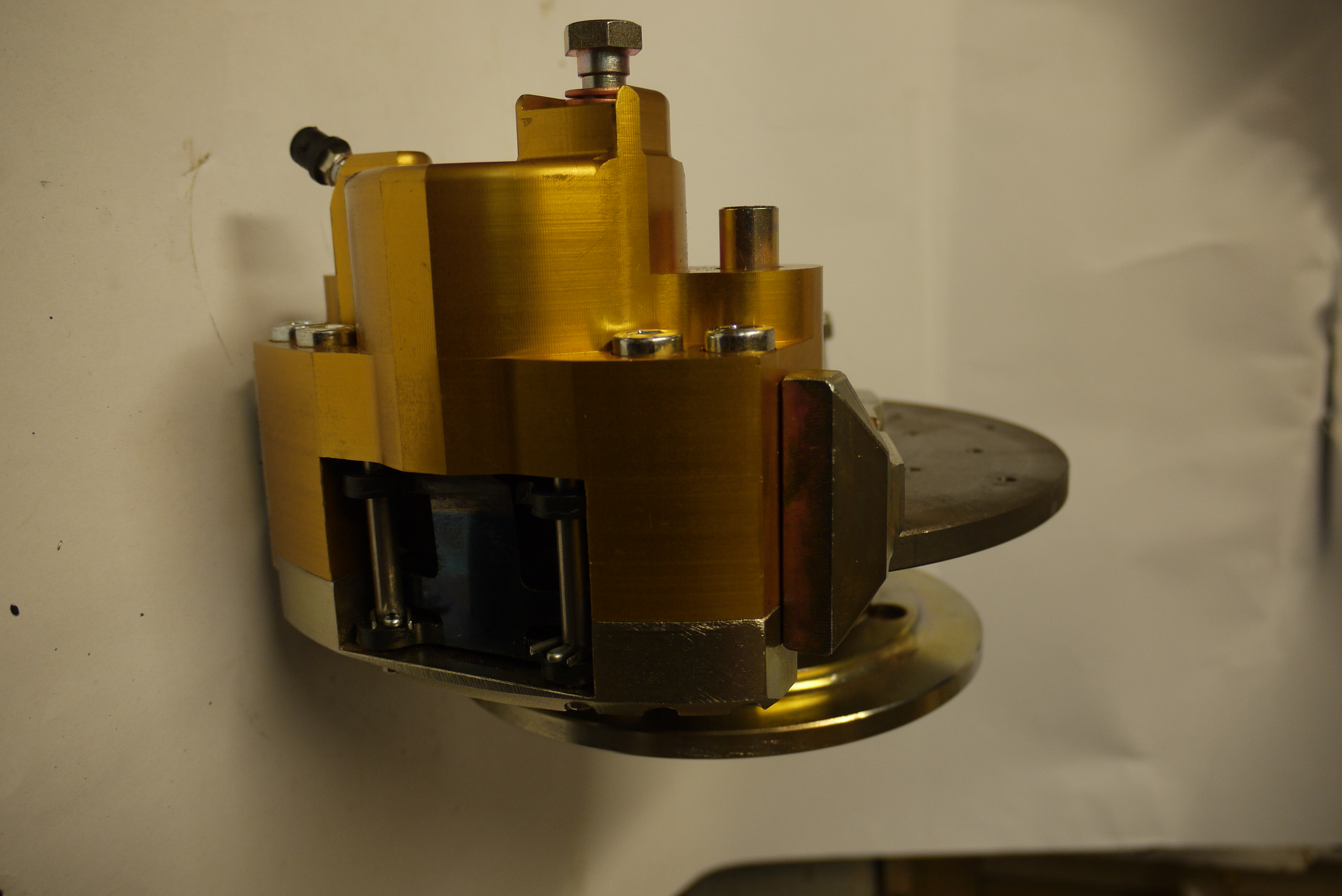

I got a bit carried away the other day and ordered up a front disc brake kit from www.fiat500126.com. I'll let the pics tell the story. They make these kits with 500 and 126 stud pattern, but both require 500 stub axels and bearings. They are also made to fit inside a 10 inch rim, so as you can see, no clearance issues at all on a 12 inch rim!

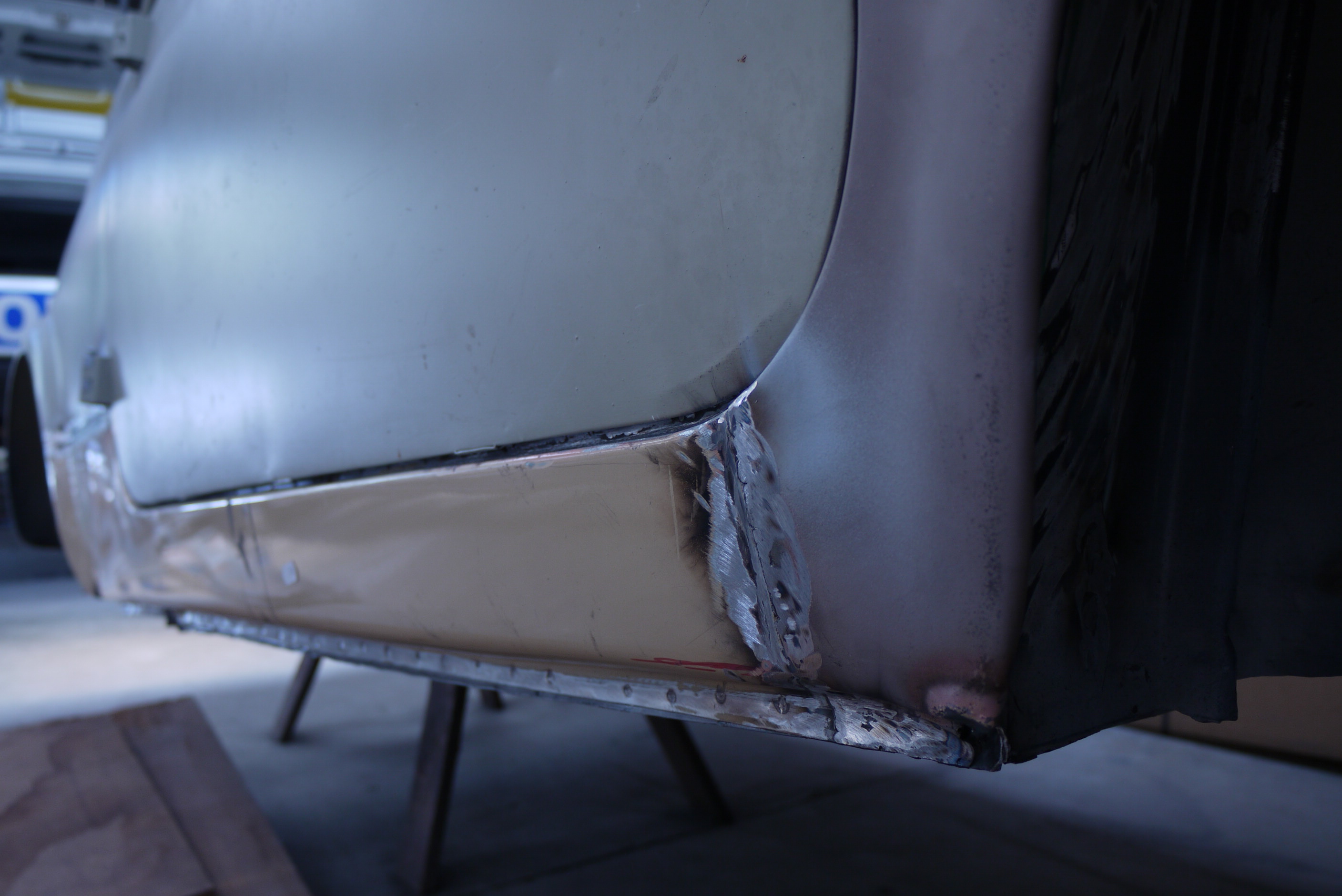

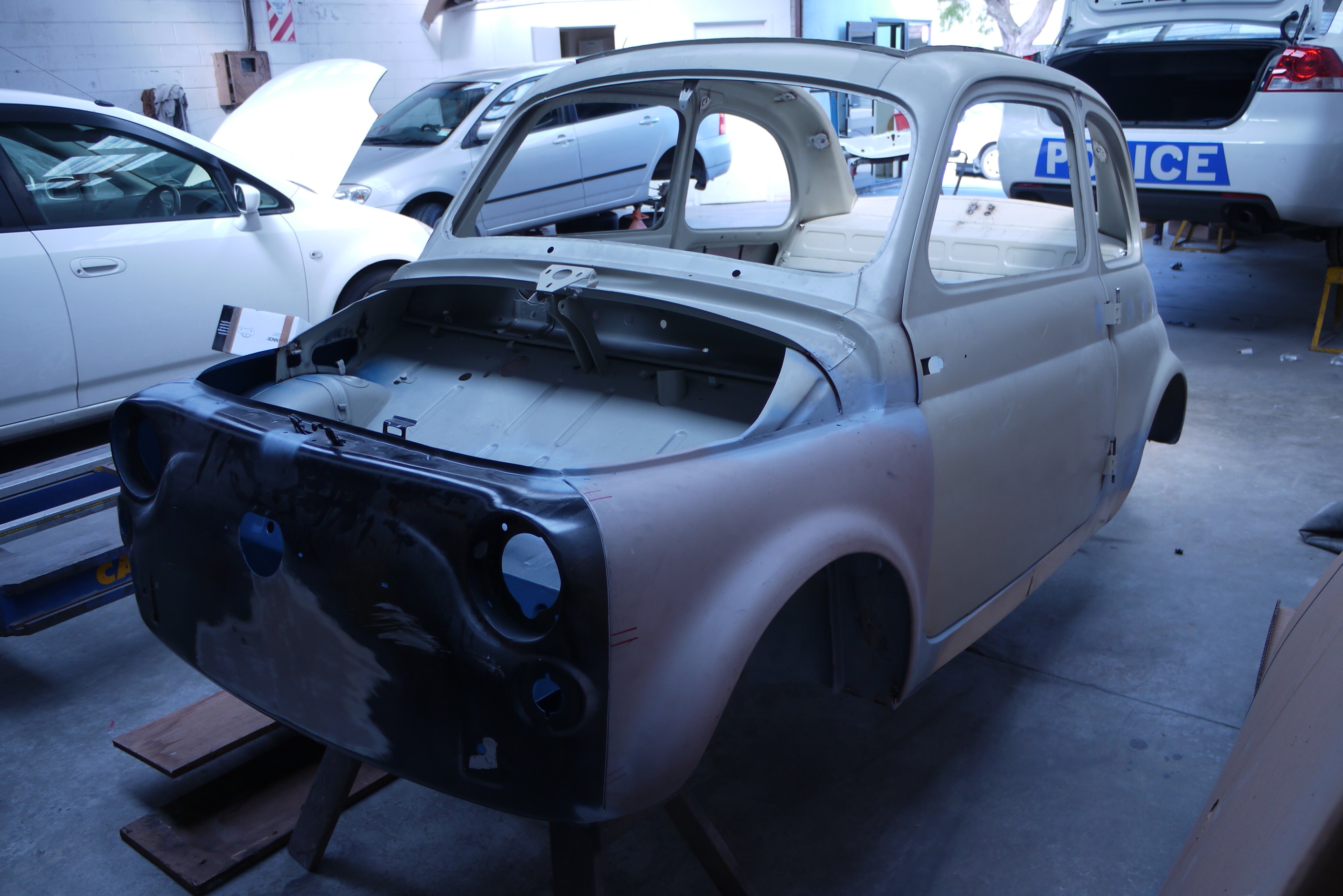

Panel work is almost done! After a year of on-and-off surgery all the main welding is done and all that’s left to do is a few small jobs and to dress all the welds properly and get out the seam sealer. The first paint has even gone on, as I opted to paint the battery tray area and around the inner front guards and the inside of the front panel before it was welded back on. No-one will ever see but we gave it a quick spray because I wanted to be sure that the paint was right in the seams of the guards. I don’t think the photos here really show the colour properly, and the bits you see will be resprayed again with the rest of the car.
There’s a whole heap of work to be done prepping the car for final paint. I’m planning to texture the whole of the bottom of the car, including inside the guards, and I’ll then paint over the texture. Then I’ll fit the suspension and wheels so the car can be rolled into the paint booth for the main paint job.
I’ve made quite a bit of progress with the steering conversion. The certifying engineer has checked and approved the welding on the steering rack brackets and a friend has made a hybrid steering column which has a 500 upper half and 126 lower half.
Because this shaft mounts into a universal joint it needs some extra support beyond the standard “hanger” that sits under the speedo. I’m planning to make this from a section of the original 126 support. You can see in the pics how I’ve removed the steering lock and brackets from the 126 part, leaving just a tube. I’ll next cut the tube down to about 110mm long and refit the steel and rubber bushes that hold the column. I could have just made a bracket with nylon bushes, but the 126 bushes are really good, with the rubber helping ensure the column self-centres in the support. I’ll have to then weld some tabs on the tube so it can be bolted up to the inner bulkhead above the driver knees.
Unfortunately regulations in New Zealand do not allow for non-factory welding on steering components, so things are now delayed while I have a complete replica of my hybrid shaft made up from a single piece of steel by a gear cutting specialist.
