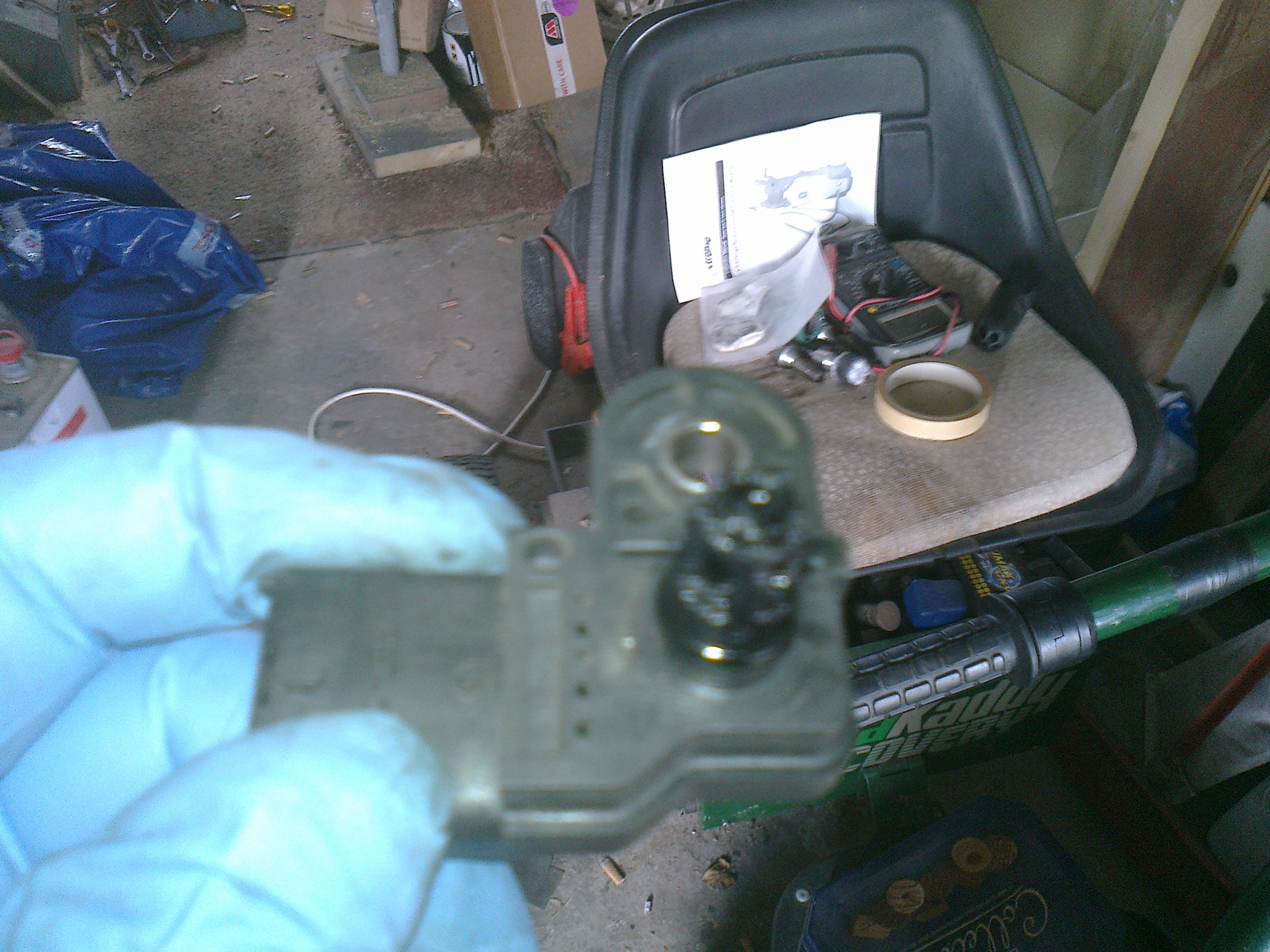

Thought Id update whats happened so far, car was really sluggish upto 2000revs so I put a blank plate in to see what happened and the car was champion to drive but gave me EML light so I took EGR off and cleaned it. Put EGR back on with original gasket and it was no better so on went the blank plate for a few days till I had a think and a look to see what else could be involved. I took what I think is the MAP sensor off( its connected to the same chamber as the EGR ) and what a mess, it was in covered in tarry looking stuff so gave it good clean with carb cleaner and a little brush. Put that back and a test run and what a helluva difference although still not as good upto 2000 revs as it used to be. I hooked upto FES and tried actuator test on EGR and got FAILED TO EXECUTE it also had conditions not right for test, so dont know what thats all about. Going to put the blank plate back in for now although I might get them gaskets with the holes in give them a try see if it does any good.

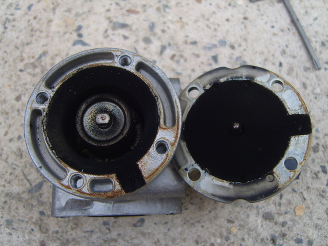

quick update on the modified swirl gasket and newer version of the 16v egr valve.annual clean out time in between showers
heres as found without doubt the newer valve has been better designed around the valve stem area as no soot at all was found in the cavity between valve and solenoid.

search this part number to be sure of getting the newer modified version 55215031 for 16v 150 or cdti 150 as mine was from a vauxhall place on ebay(sorry cant remember who but less than £100)
this was what i found when i stripped my original valve
