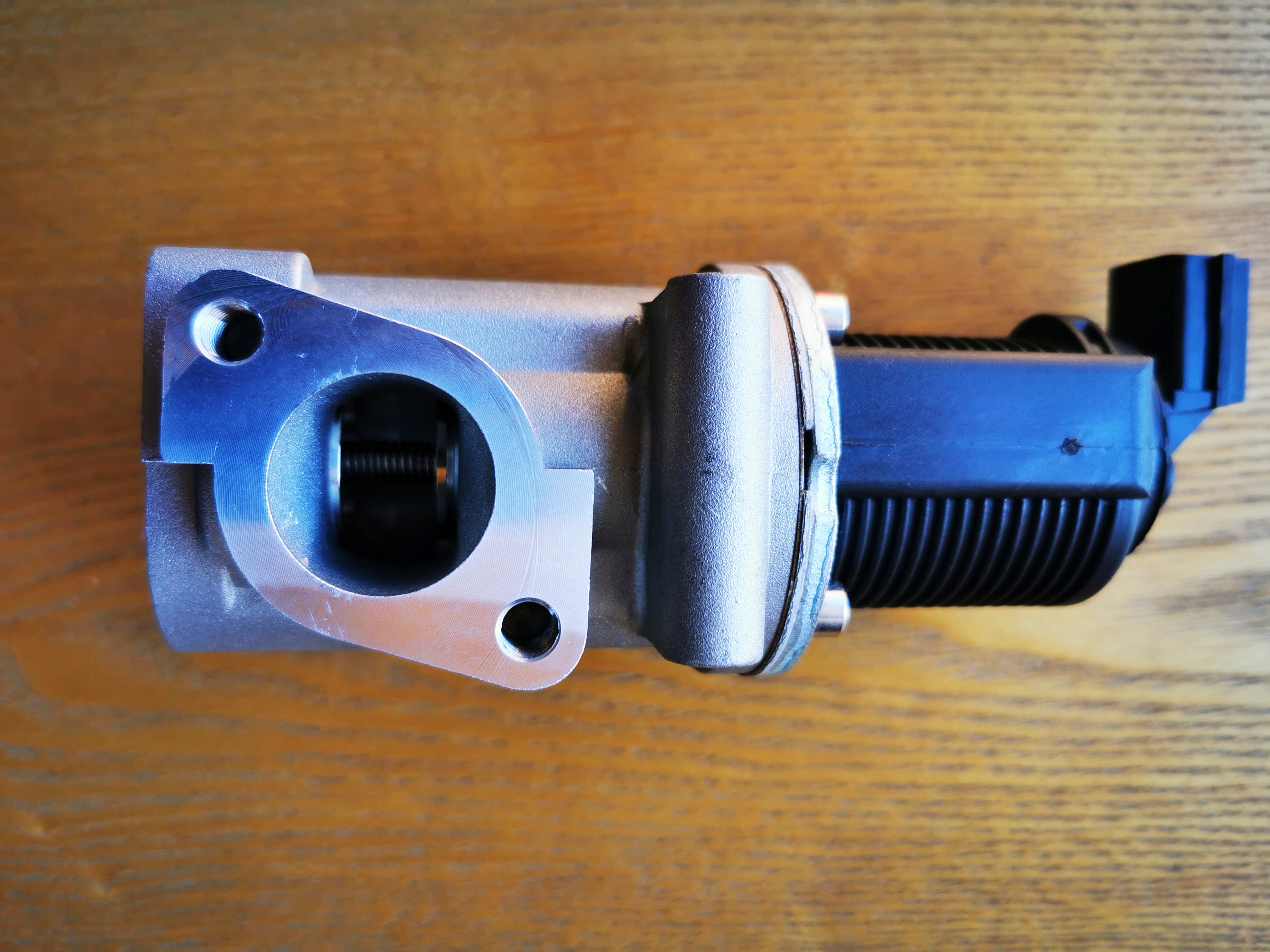

New EGR valve arrived and will be fitted tomorrow :)
