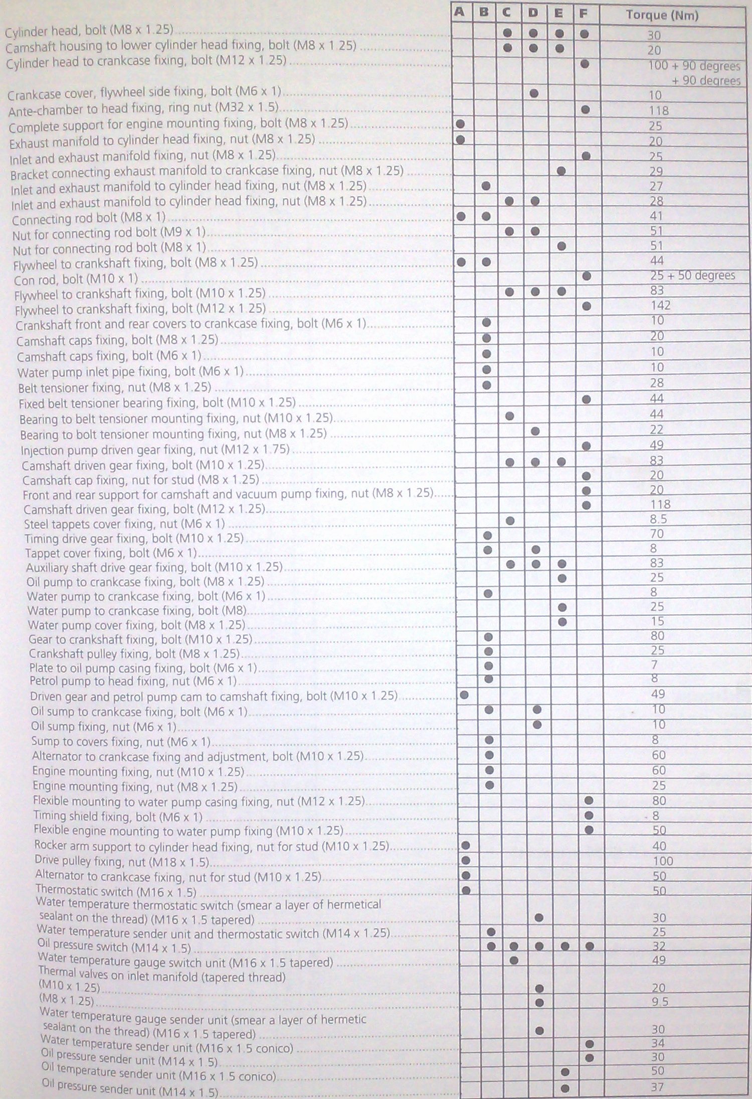

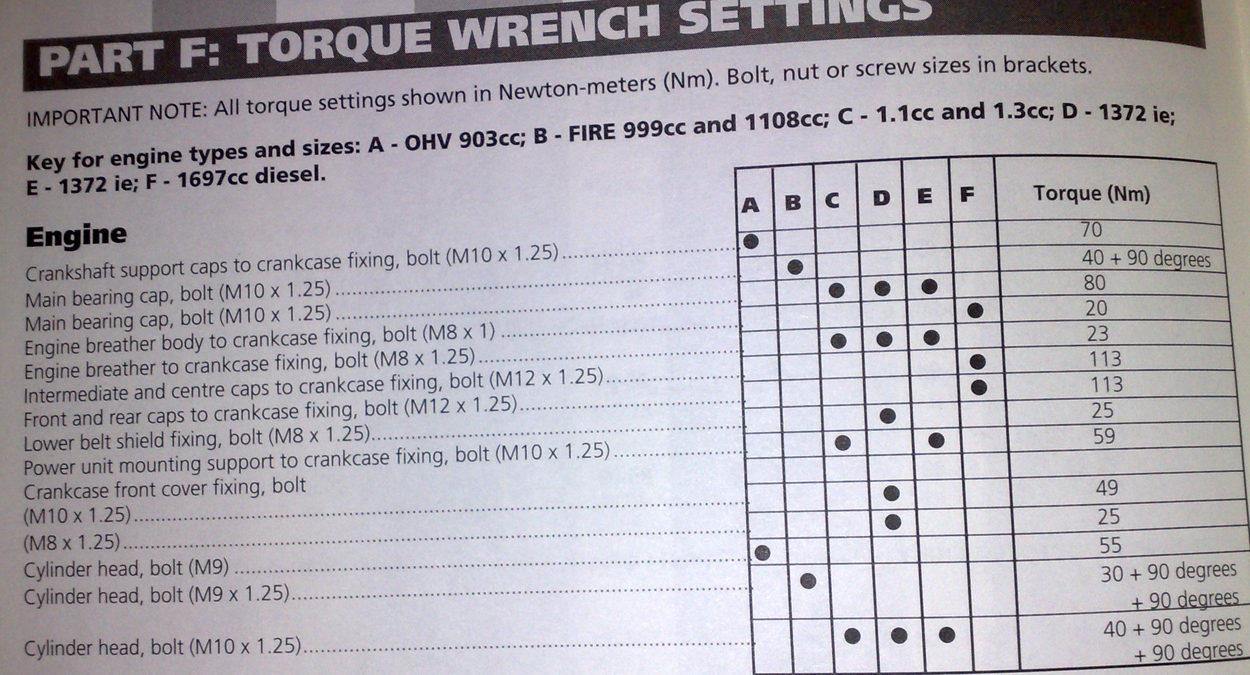

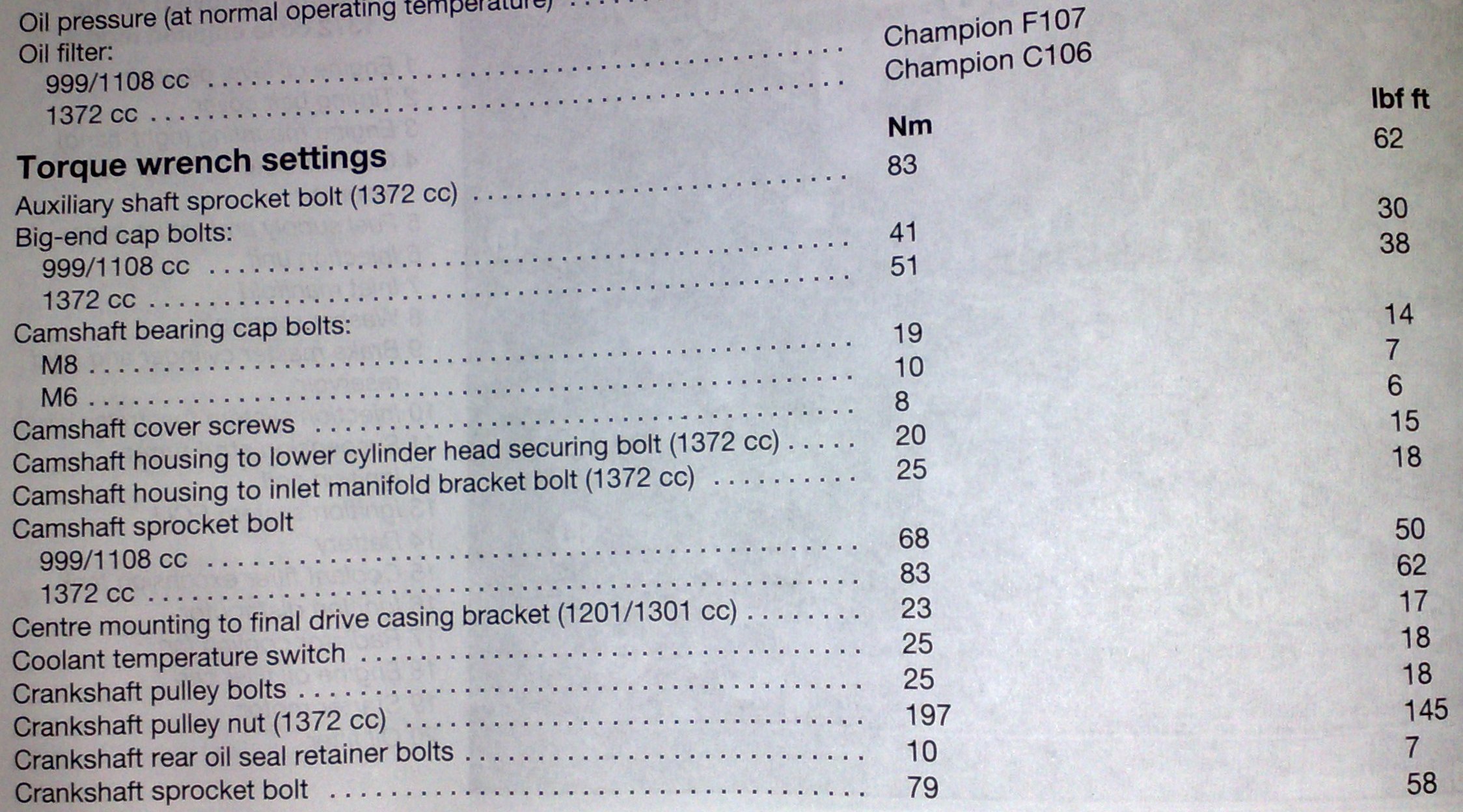

I have a 1991 Fiat Uno 1372cc and Im just putting the camshaft back in the housing. Question. There is a block that is bolted (3bolts) to the Camshaft housing and then the distributor is bolted to this. What is the torque setting for both sets of bolts?
This is Haynes & Porters settings.

I look forward to seeing what other people say in the forum, I'm quite prepared to be wrong on this :eek: EDIT: Thanks a73uk for providing the official answers!
