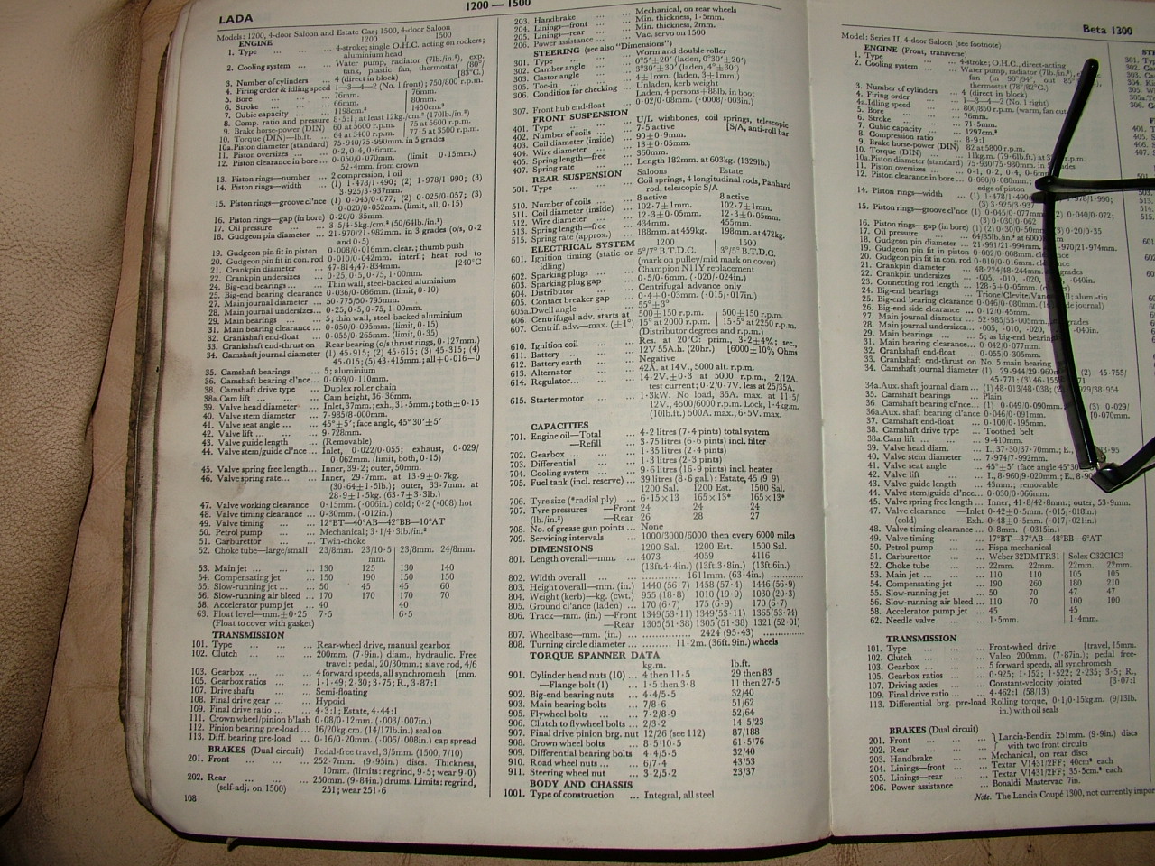

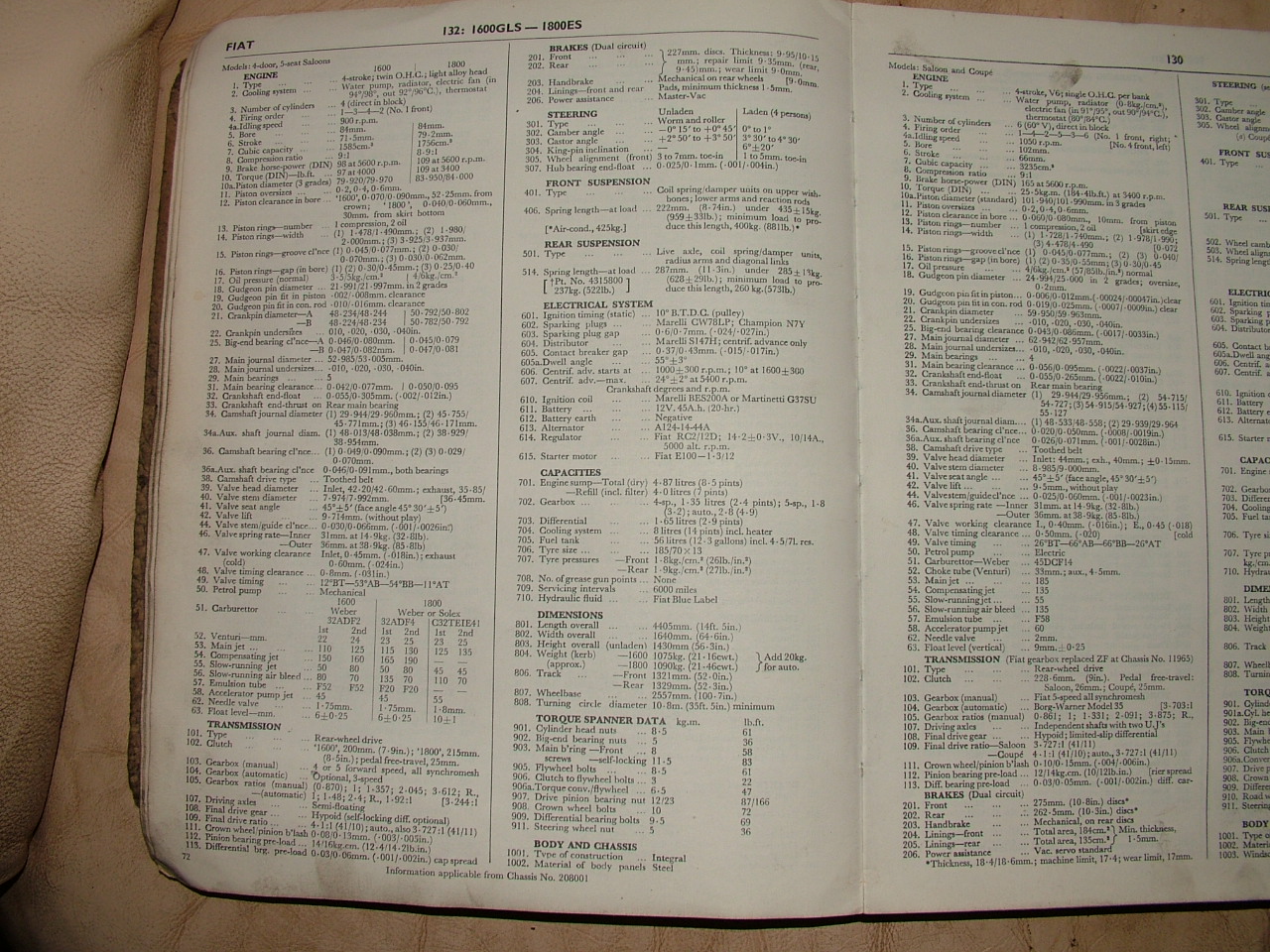

I worked as foreman at a Lada Dealership between 1975-82 .
I suspect the Ladas had a smaller diameter front brake disc assembly as they were not renowned for superior braking (though that may have been the Russian tyres) and there rear brakes were drum mounted on a rear wheel drive straight axle as in not independent rear suspension.
The Lada rear drum brakes do look similar to a picture in a manual of a Fiat 131 with the drum brake assembly, but I couldn't say for sure regarding dimensions, though as built under license from Fiat I suspect there wasn't a large amount changed.
Don't know if this will help at all, it is from a trade manual covering many vehicles dated 1977.:)
